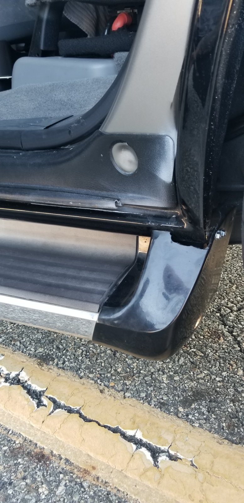

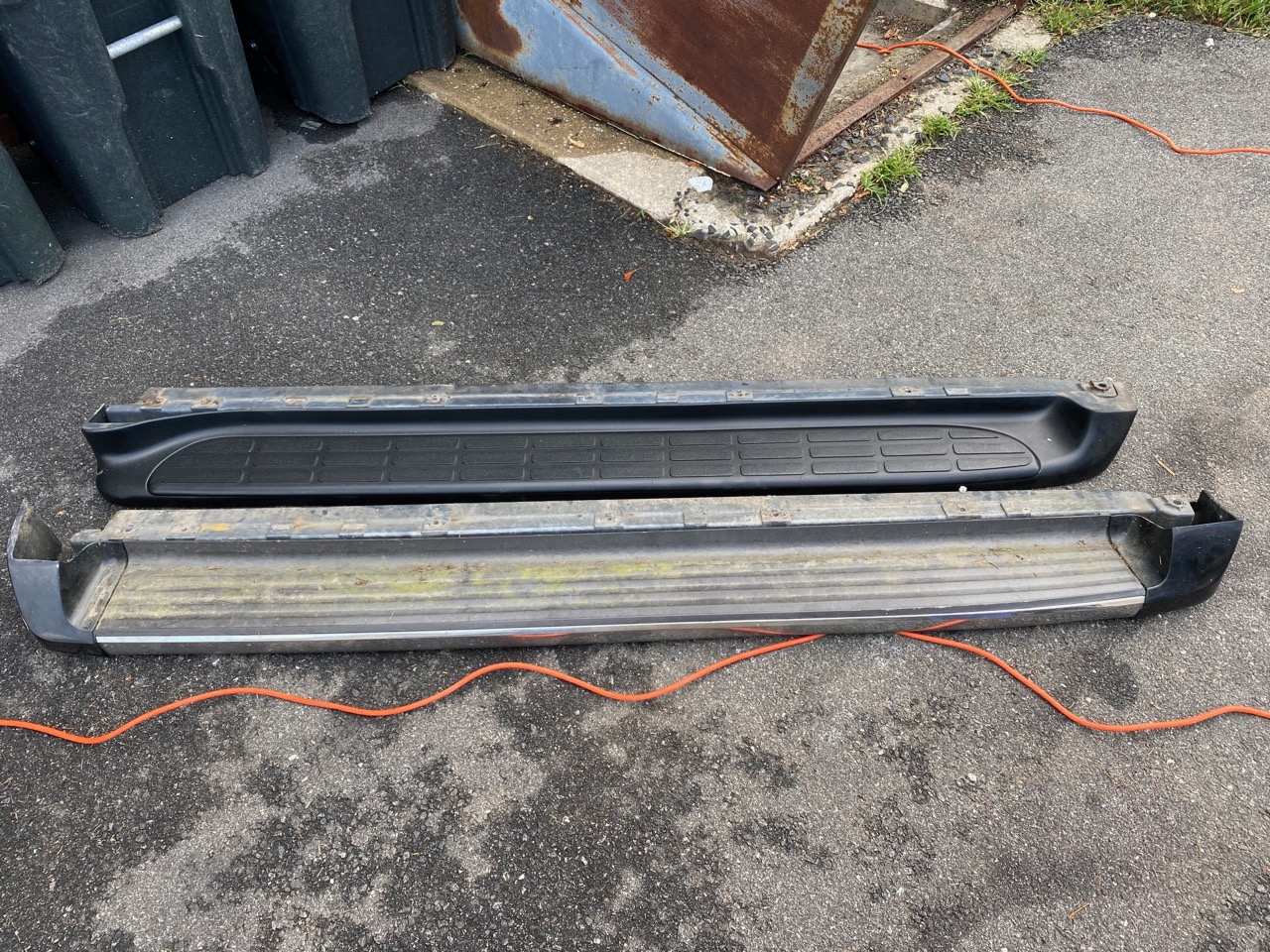

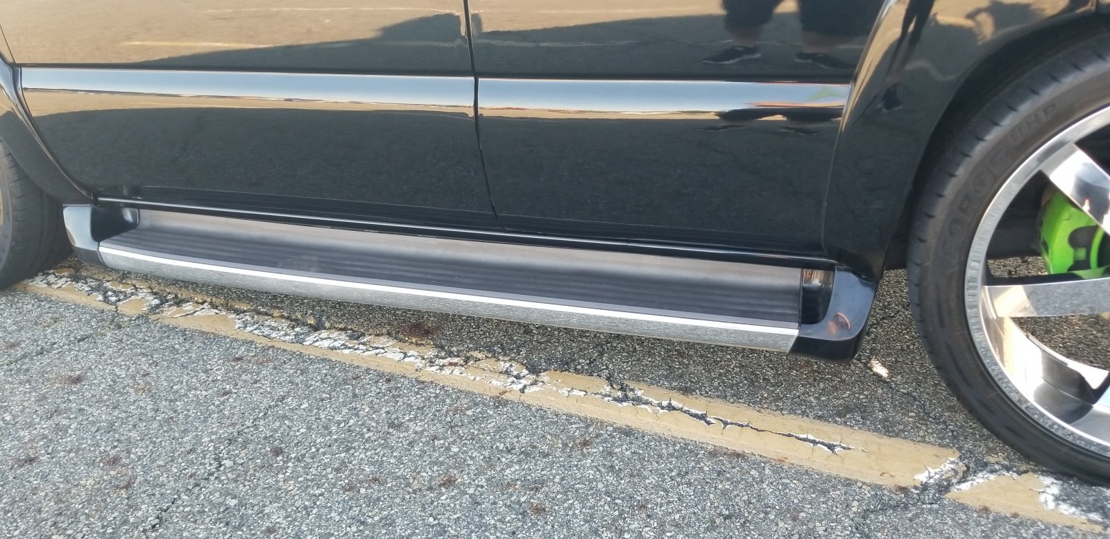

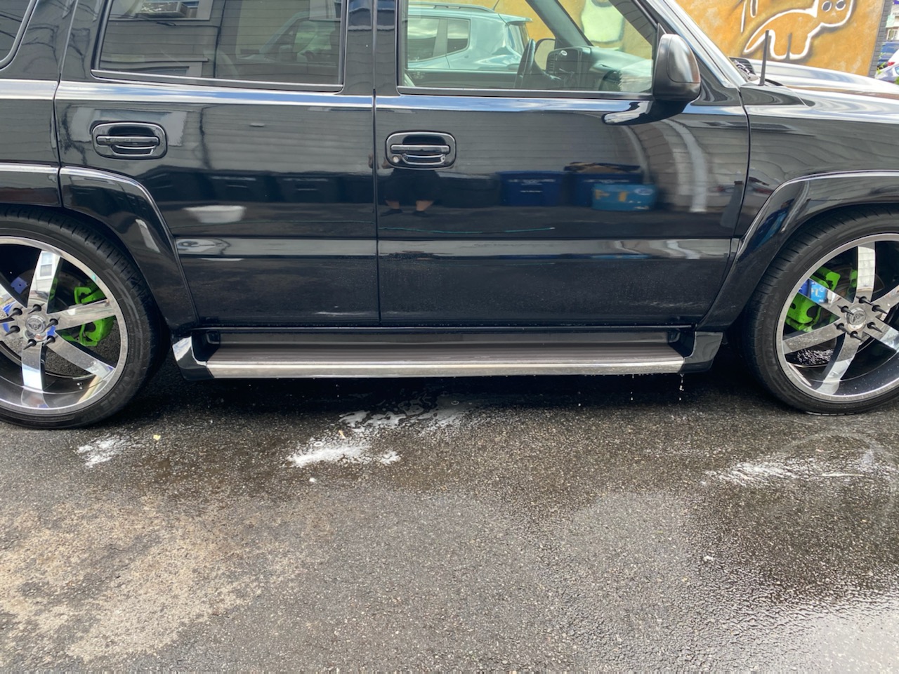

I know a guy who has an 01 Tahoe. He grabbed some running boards from an 03 Esky, and was wanting to know if the boards are a direct bolt on with no mods. I think so, but I'm not 100%. Also, he has the oem fender flares. Think everything will match up? TIA.
33,186
51,406

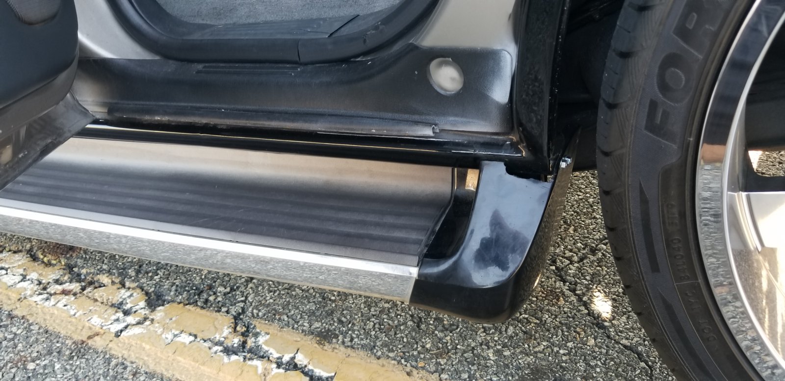

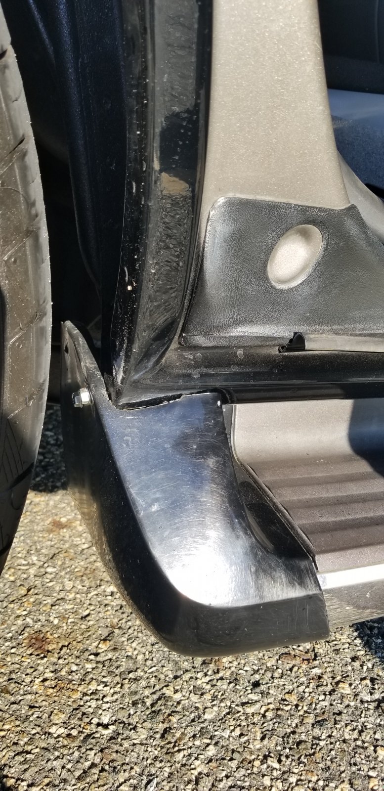

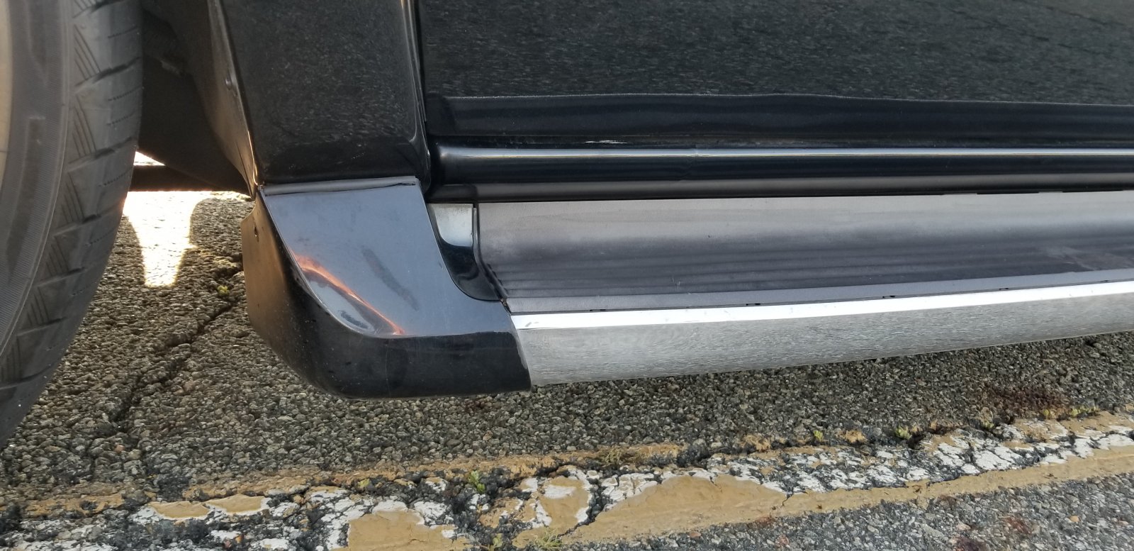

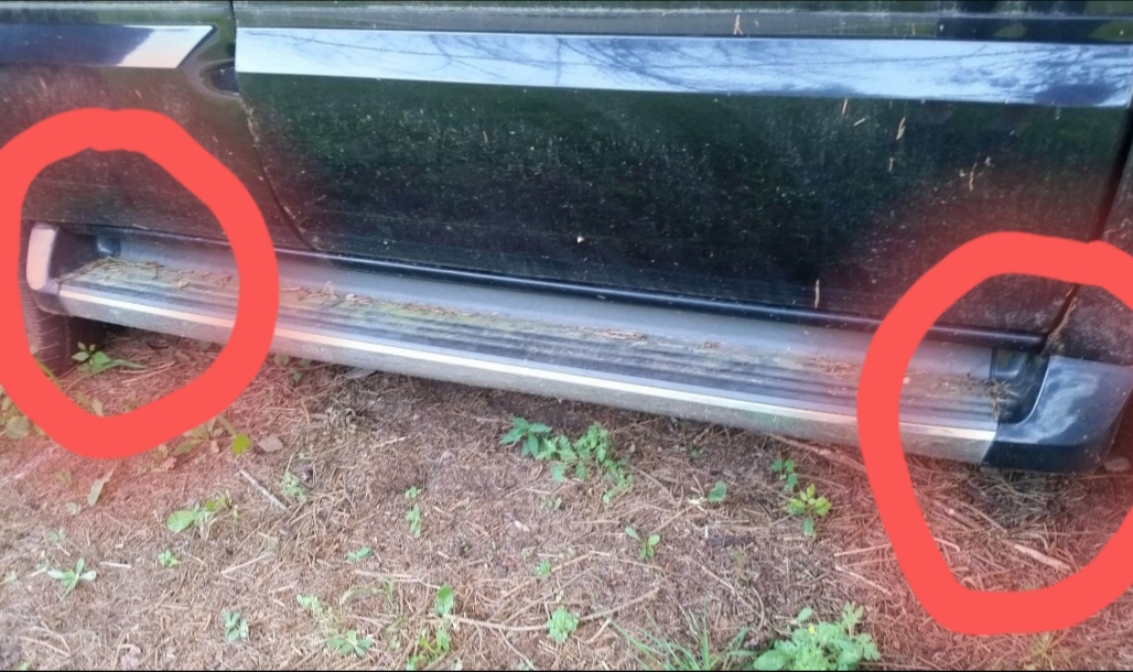

All you need to do is some trimming on the upper rear mouldings on the Esky boards. Fit like a glove.
He trimmed off a little too much, cause he was rushing.
33,186
51,406

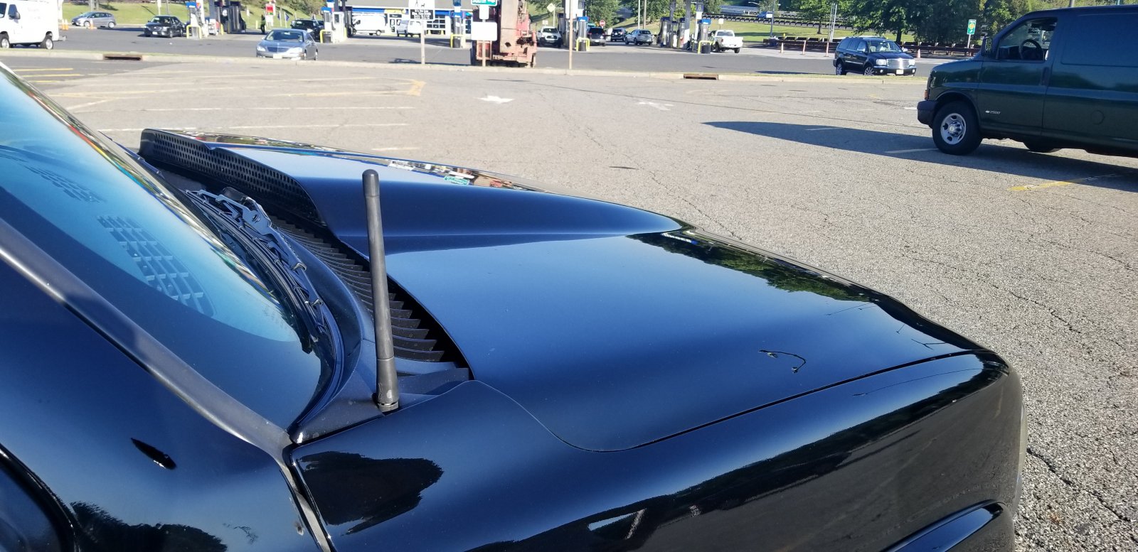

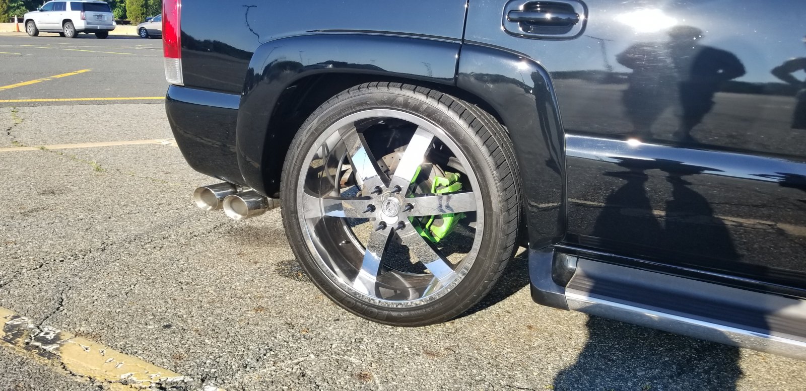

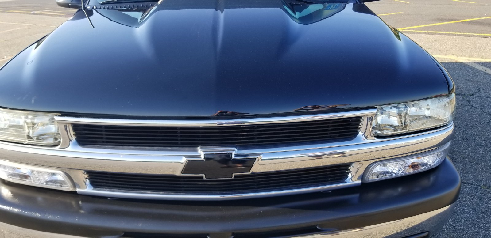

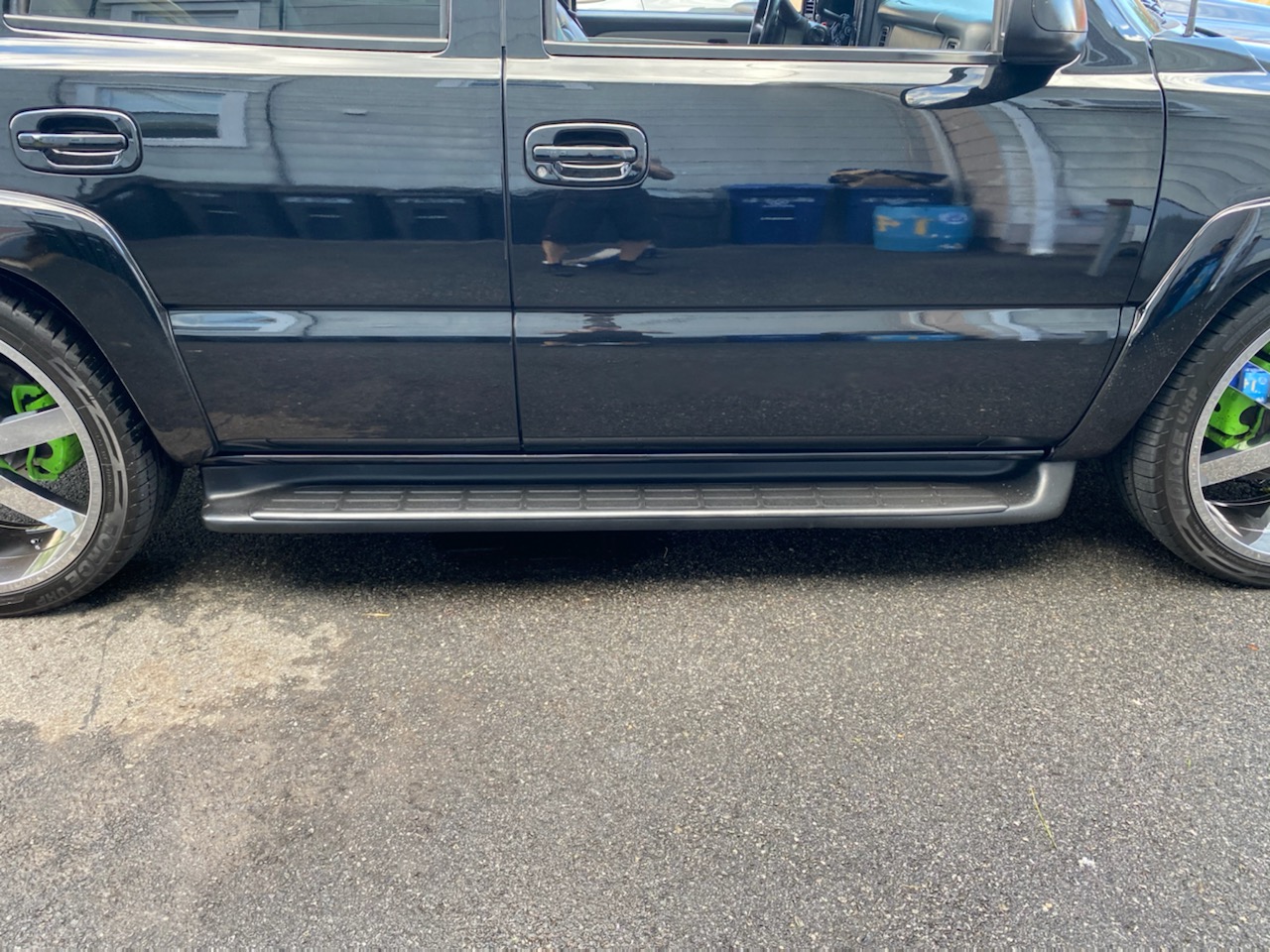

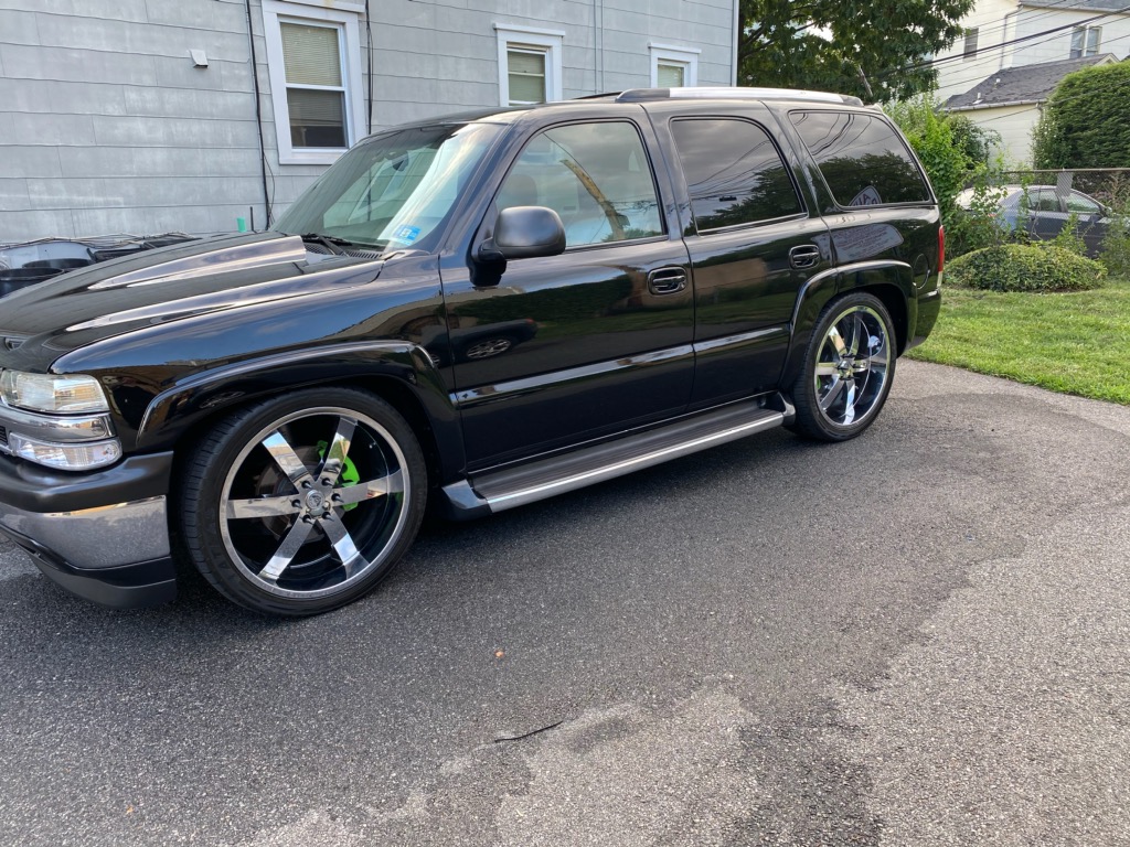

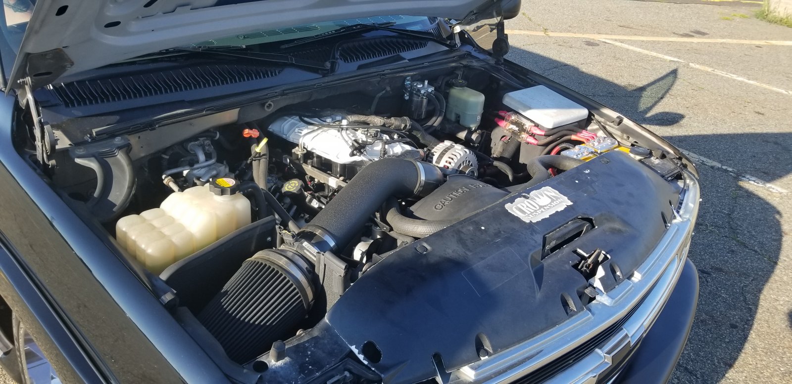

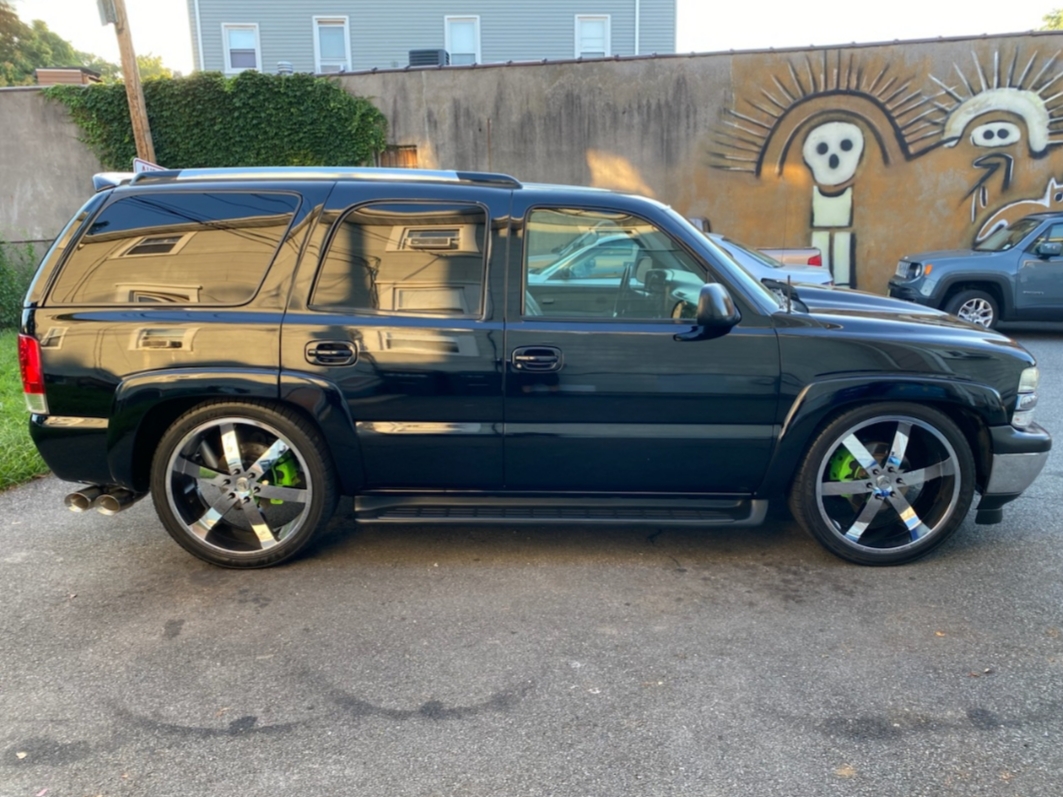

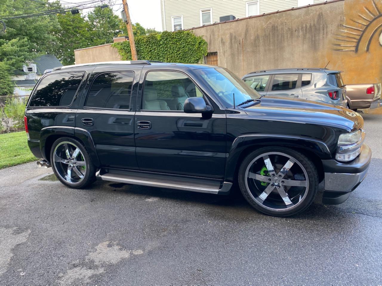

One clean 01 tho. He put a TBSS intake on it with FF injectors. Also installed 05 pwr leather seats in the front with the matching dual buckets in the rear. It was originally a white truck--thus the white intake. Really nice, clean Hoe.
Did everything but the paint himself.

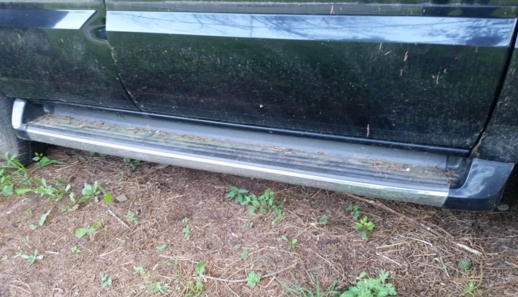

Cool thread! Great looking ride! I’ve always wanted to swap esky boards, to my Denali but I don’t think that they will match up the the Denali lower mountings on the bottoms of the fenders. So I’ve never pulled the trigger.
