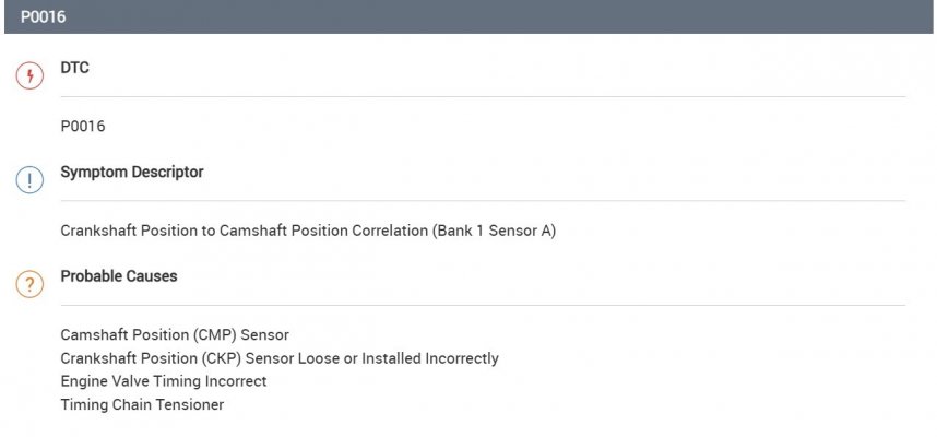

this morning car started up fine, this time after it’s got to operating temperature we stuck to just steering inputs and lo and behold car shuts off, and now finally it gave us an error code. See photo for more info.

thanks for the update. glad you have something concrete to work off of.
What is the plan--change cam and crank sensor?
This code makes sense that you would get a hard start after a shutdown.
I'm interested to see if this is also causing the steering input malfunction as well.

Gonna start with the crank sensor first and move from there.
Im guessing the steering input is malfunctioning the crank sensor. but lets see. will update in an hour or so
