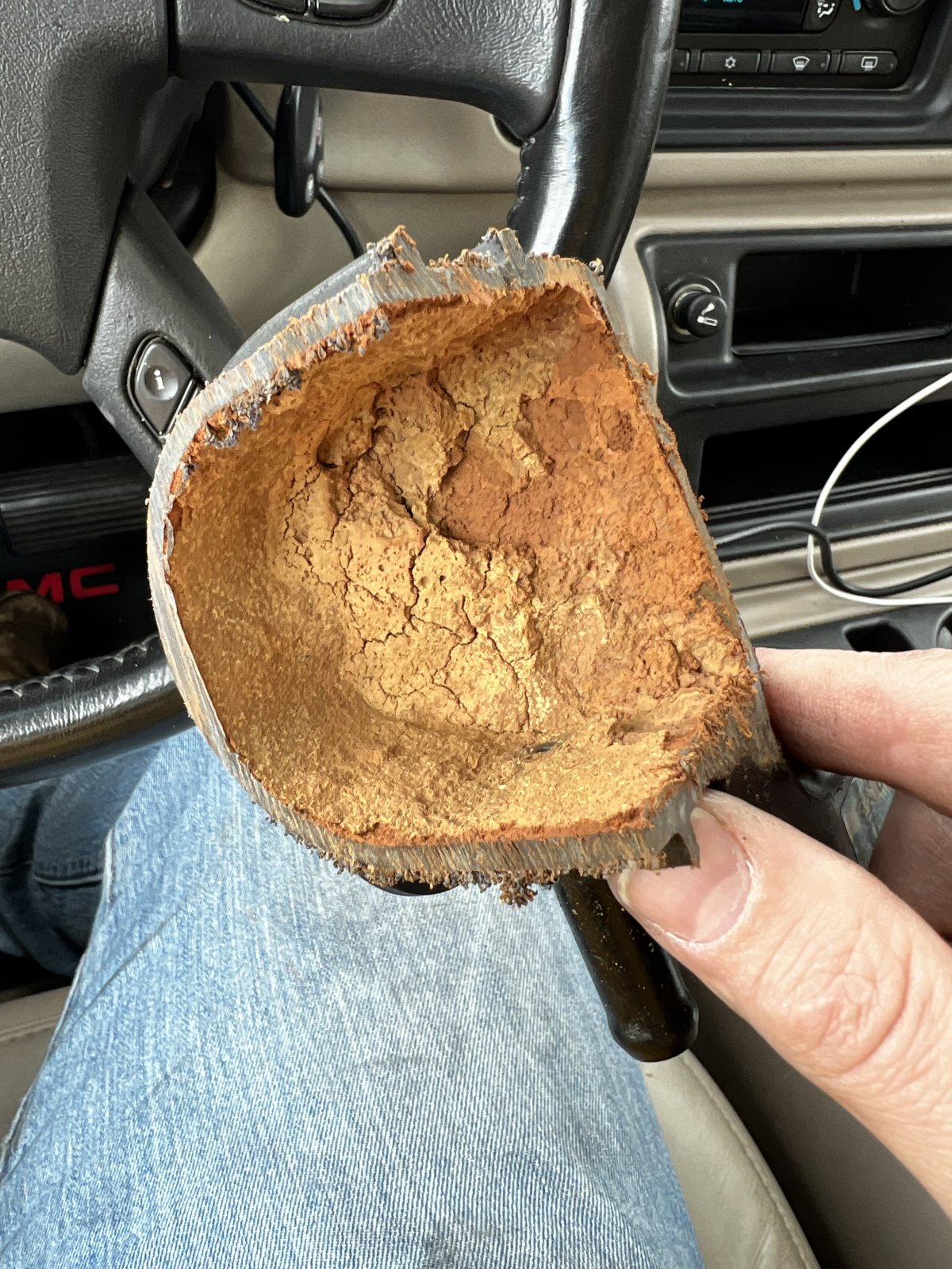

My kid’s “new” Yukon is having some odd symptoms. It slowly warms up while idling and will eventually get up to 210-215 (read with my OBD2 live data, dash gauge matches pretty well) without the fans ever turning on. We replaced the fan assembly and the new one doesn’t turn on. I plan on pulling out my multimeter to see if any power is being sent to them and trace it back as the fuses look good, but are hard to see with a brace over the fan fuse box. Any pointers?
Secondly, it cools off to the 140’s while driving. Thermostat, right? Well, we replaced it twice and it still does the same thing. We also used a thermometer in boiling water to watch it open up, then fully close by about 186°. This is what really didn’t make sense to me. The thermostat seems to be working but the temperature still drops??? The upper radiator hose warms up as the engine does, suggesting some level of coolant flow before the thermostat should be open. Is the system supposed to weep some flow through, or did we somehow replace a bad thermostat with two more new/bad t-stats? I can’t imagine the odds of getting 2 new bad thermostats from different sources (Autozone and NAPA).
Relevant info: Both heater cores were clogged. We gently backflushed them and got the front one clear with good flow using our garden hose, but the rear core still isn’t flowing based on line temperature. We’re going to pull the rear lines and flush them separately but didn’t want to risk breaking a part we can’t replace before work and school tomorrow.

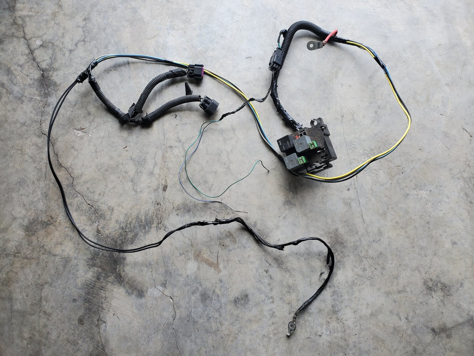

You'll want to thoroughly check the fan relays to make sure they're operating correctly. If I'm not mistaken, the fans should (may?) come on automatically if the A/C is turned on. Also, pull the two connectors to the PCM and look for water migration and pin fitment.

IIRC, besides the PCM, isn't there a fan module that kicks them on at the correct temp, when a/c is not on.
