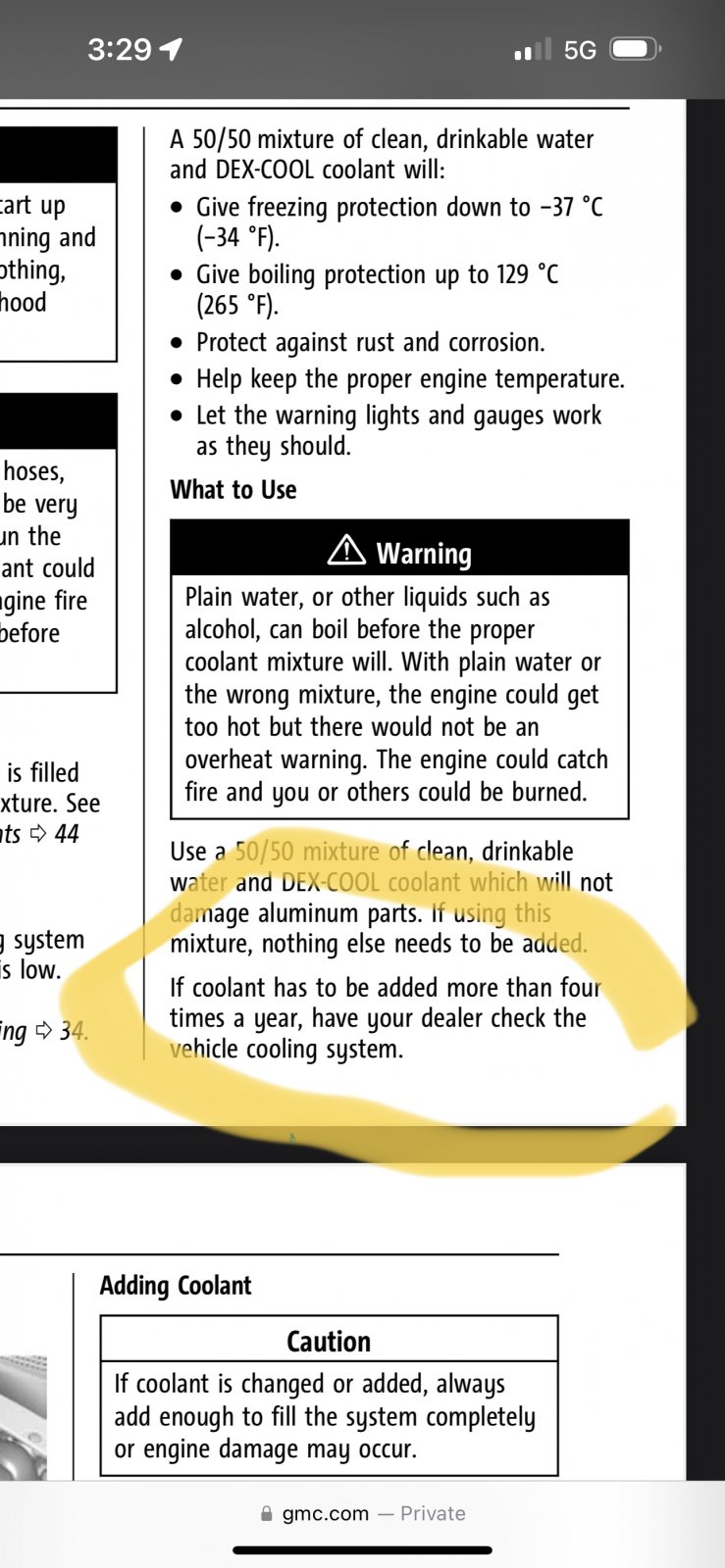

looks like my coolant level is low again after 5 months . When the dealer looked at it in February , they mentioned that sometimes the factory underfills it , and they didn’t see anything out of the norm . They added a little coolant just short of the seam but it’s been steadily decreasing in the past 5 months .
I removed the plastic shroud over the radiator to see if I could find any type of residue but the radiator looks good .
The manual mentions that if you have to add coolant more than four times in A year ,to visit the dealer, so I’m wondering if some loss is normal or why else would it state that . There seems to be some debate online of whether the system is completely closed or not , or if there is evaporation . Does any one else have any experiences with slowly declining levels ? Thanks everyone !
