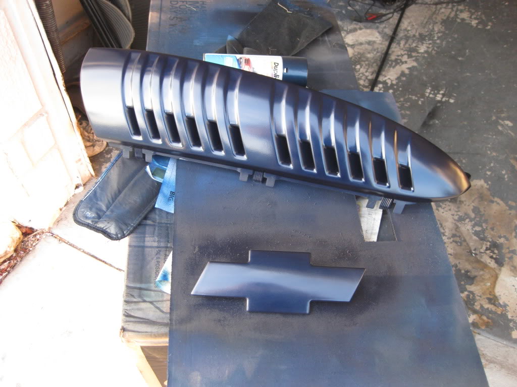

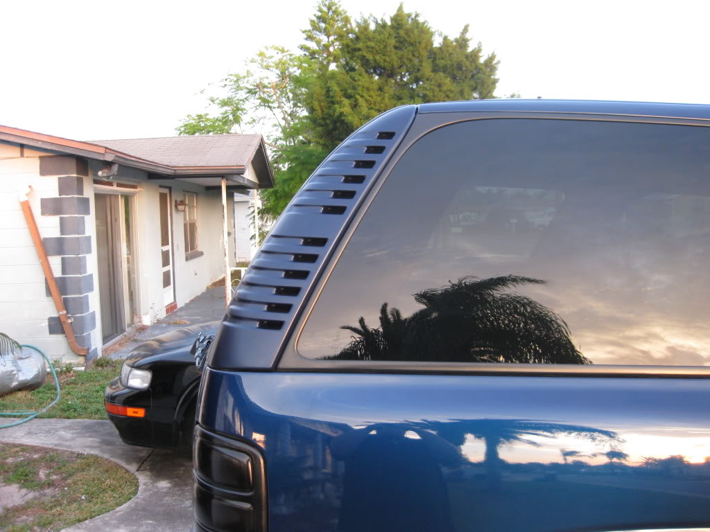

so i finally found my color touch-up paint... went to like 5 different auto parts stores not finding anything and decided just to order it... yeah doesnt match for shit!
i shoulda just left em black... tomorrow ima get a can of clear coat and hopefully that will make up the difference...

ummm looks like uneven coats for 1 and very rough.. (in the pictures) you have to stay steady and keep a wet seam. 2 yes they need clear.. Looks about right to me.
I would have gone to a paint store and had them color match and bought clear. Bought a harbor freight $20 gun and sprayed them.. Works like a charm

they are even coats its just the pictures... in person they are sprayed good and smooth but i dont think the color is even close... maybe im color blind?

well tomorrow ill wet sand em spray em again then clear em... hopefully they'll come out good

well about 5 mins after i put them back on it started raining and they still need to be cleared...

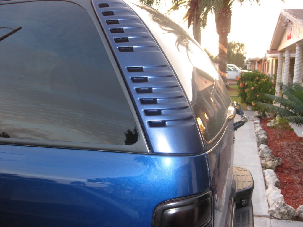

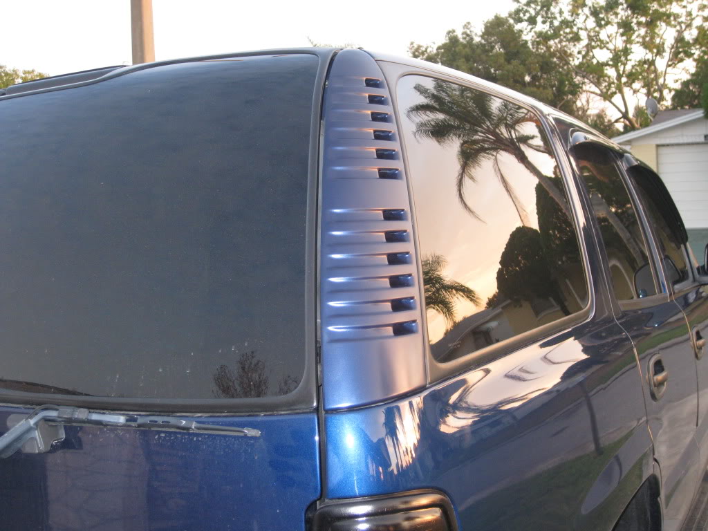

so i decided to take my time and do it "the right way" with what i was workin with and its better but now it came out darker than the color of the truck...
look better?

it has 4 coats of clear on it...
---------- Post added at 09:37 PM ---------- Previous post was at 09:36 PM ----------
the first pic is how they actually look... the pics on the truck arent comin out good for some reason

I"m betting the color variation is becasue you didn;t start with the same basecoat color.
those are black, and I think the bodies are white primer.
thus you get a lot darker color.
with a white part you;d have been fine, or a white primer/first coat.
