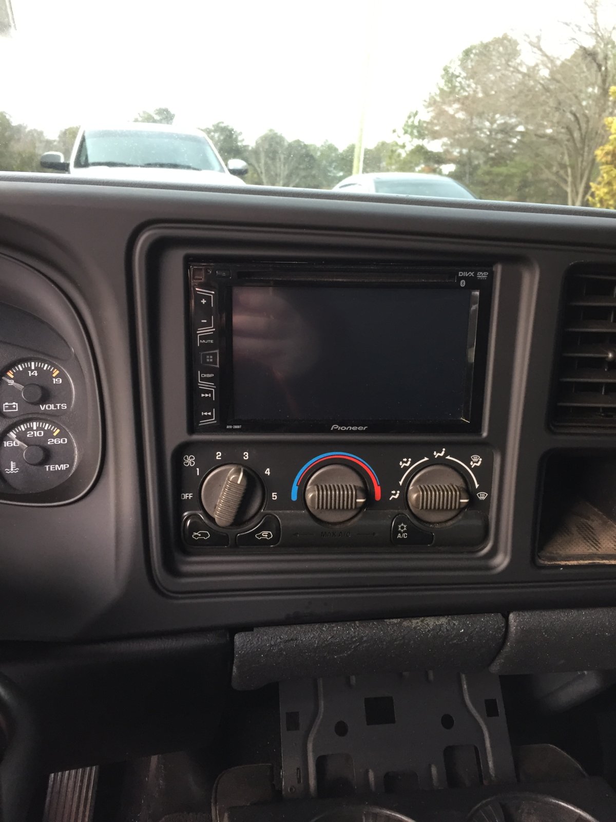

If you have the 2000 to 2002 you have three options. One go the route of buying 2003 and up bezel and radio mount like the picture below. Then your ac controls will move down to match the bezel and you will have to remove the door that covers your cigarette power, which is not a big deal. The other route is you can trim the bezel you have now to a bigger opening to accommodate the radio and then you remove a metal bracket behind the radio so the double din will fit. Third buy the metra kit that a previous owner mentioned. I ended up trimming my bezel and cutting the bracket.
Below is an image of original bezel trimmed looks better in person then in the photo lol. If i get a chance to take a better pic I will
