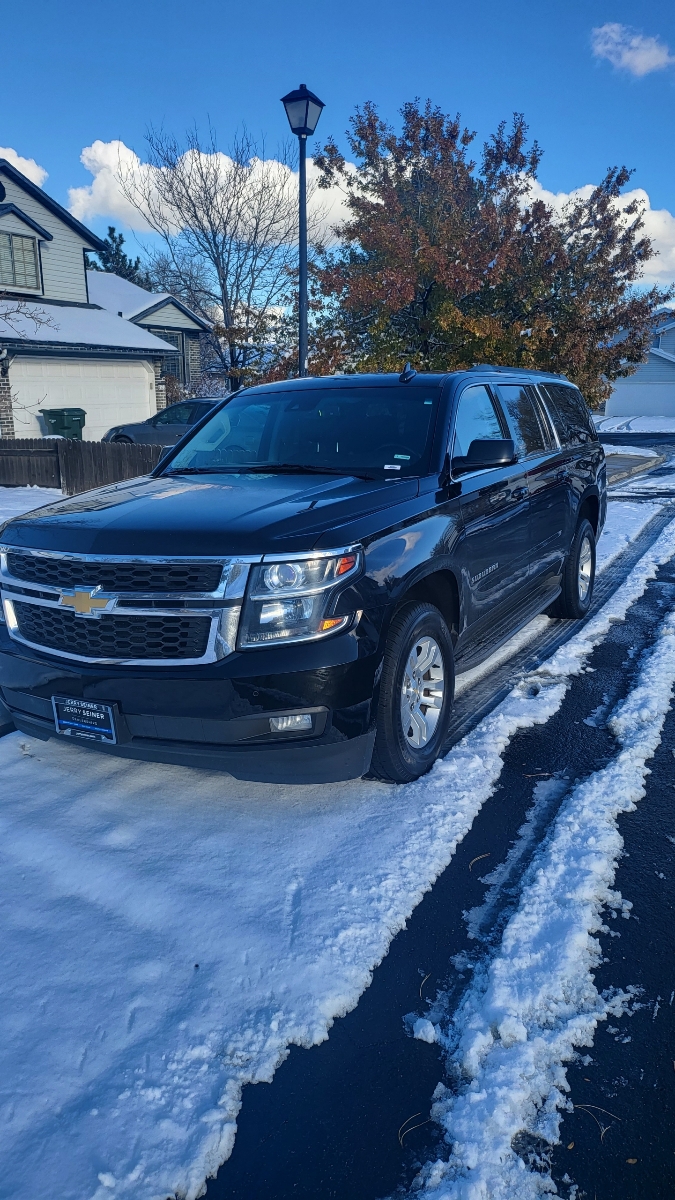

Nice! What other maintenance items do you have planned? Please also post pics of the truck. We like pics.

Well I changed the Transmission fluid already through the cooler lines. Haven't dropped the pan yet though because I live in Utah and it's been the worst winter we've had in the last 50 years so I haven't been able to do much. That was important though so I did it in the snow lol. I changed the thermostat and water pump. I'm gonna do diff fluid and a pan drop on the transmission to check the magnet soon. I am considering flipping the pill in the transmission lines too so that the transmission runs cooler. Other than that everything else seems fine. It already has new brakes and tires. I need to do some paint correction on the hood because it's a little faded. Planning on putting a lift, intake, new bigger tires, and putting a tuner on it.

Good stuff! Looking forward to the progression of your rig. Thanks for including some pics. You have a tune in mind? Going to buy HPTuners and learn to do it yourself?
