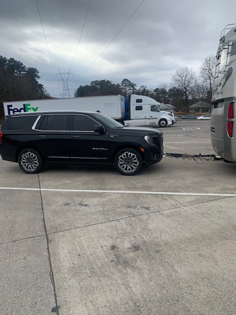

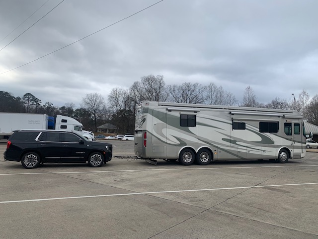

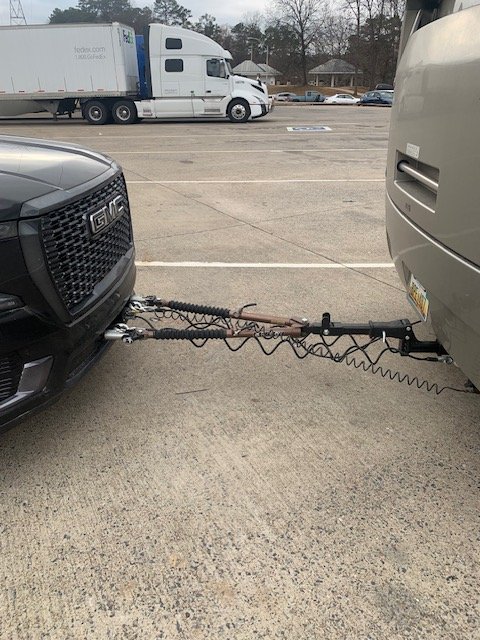

Here is the Yukon being towed by my motorhome. I thought some pics would be of interest.

Can you let me know what parts were used?
