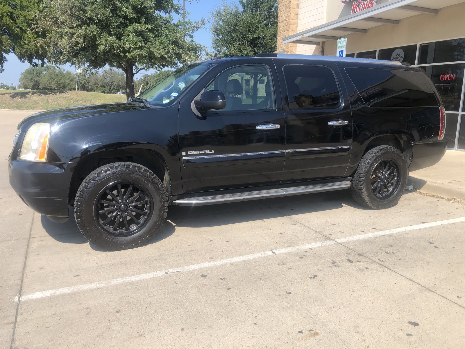

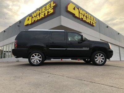

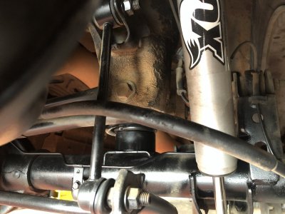

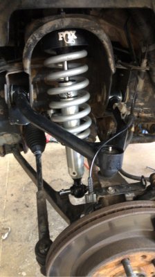

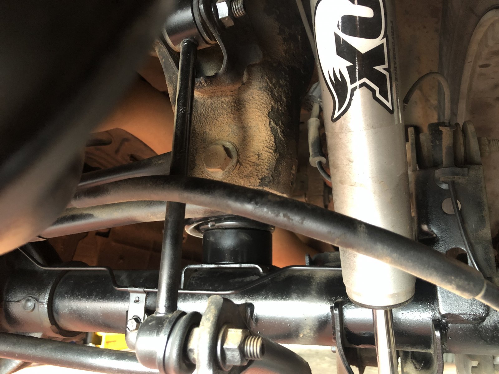

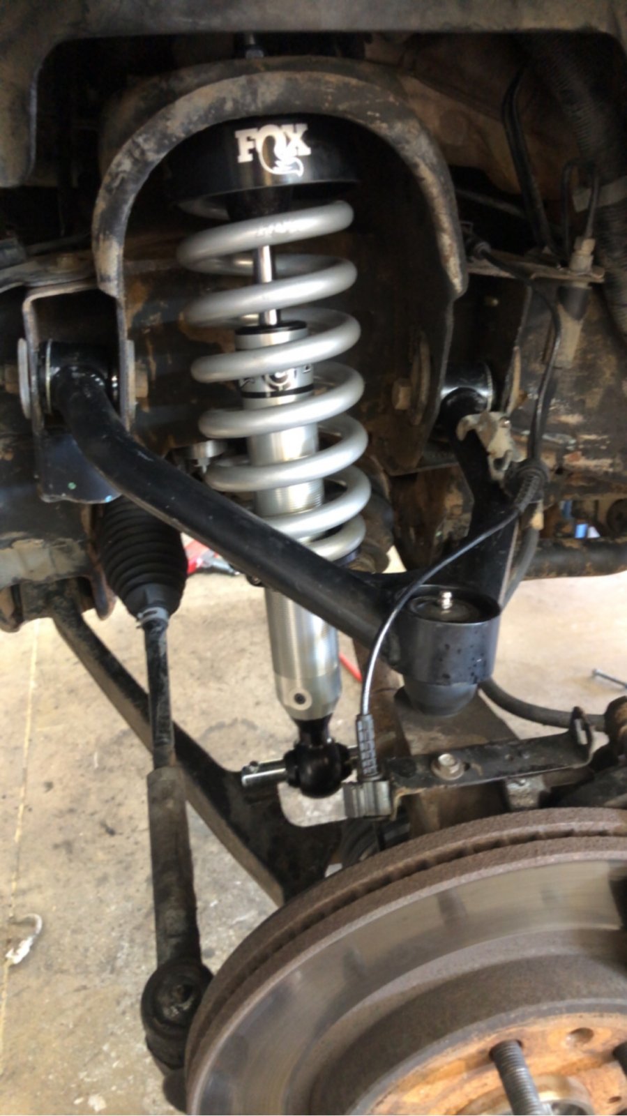

What’s up y’all old member here. Back with another Suv . Picked up a 07 Yukon Denali XL 6.2 awd. it was in rough shape suspension wise. So had to replace it all.
give you my list
Fox coilovers
985-02-018
Fox shocks
980-24-660
Readylift 4 inch kit(I only used the arms)
69-3495
Readylift rear spacer 1.5
66-3015
Precision coil springs set
SP08468 (raises the rear 2inches from air ride springs)
Precision front 4wd hubs
OEM front diff mounts with new bolts
