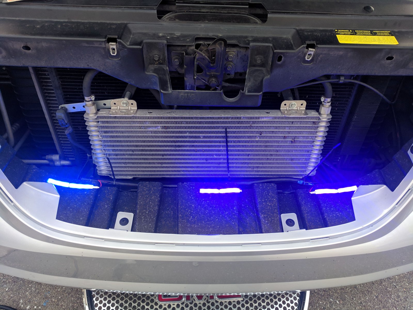

just had mine off the other day, there is 4 slots on the bottom and 2 or 3 on the upper sides

Did any of the clips fall off when you pulled it? Mine on my Silvy always try to.
no not this time, on my original one the first time I took it off I broke one or two, but this one is a aftermarket I managed to not break any amazingly.
