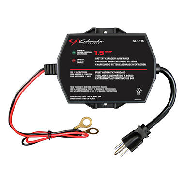

I use an on-board charger like this:
Mine is inside the garage, so an extension cord is no issue.
I had the exact same model. Problem with that cheap design, when the 120v power is disconnected the battery its attached to back feeds and powers the charger leaving the leds on. Not a big deal if its overnight but 2 or 3 days at -20f and your battery is toast. Schumacher isn't as good as they once were.
