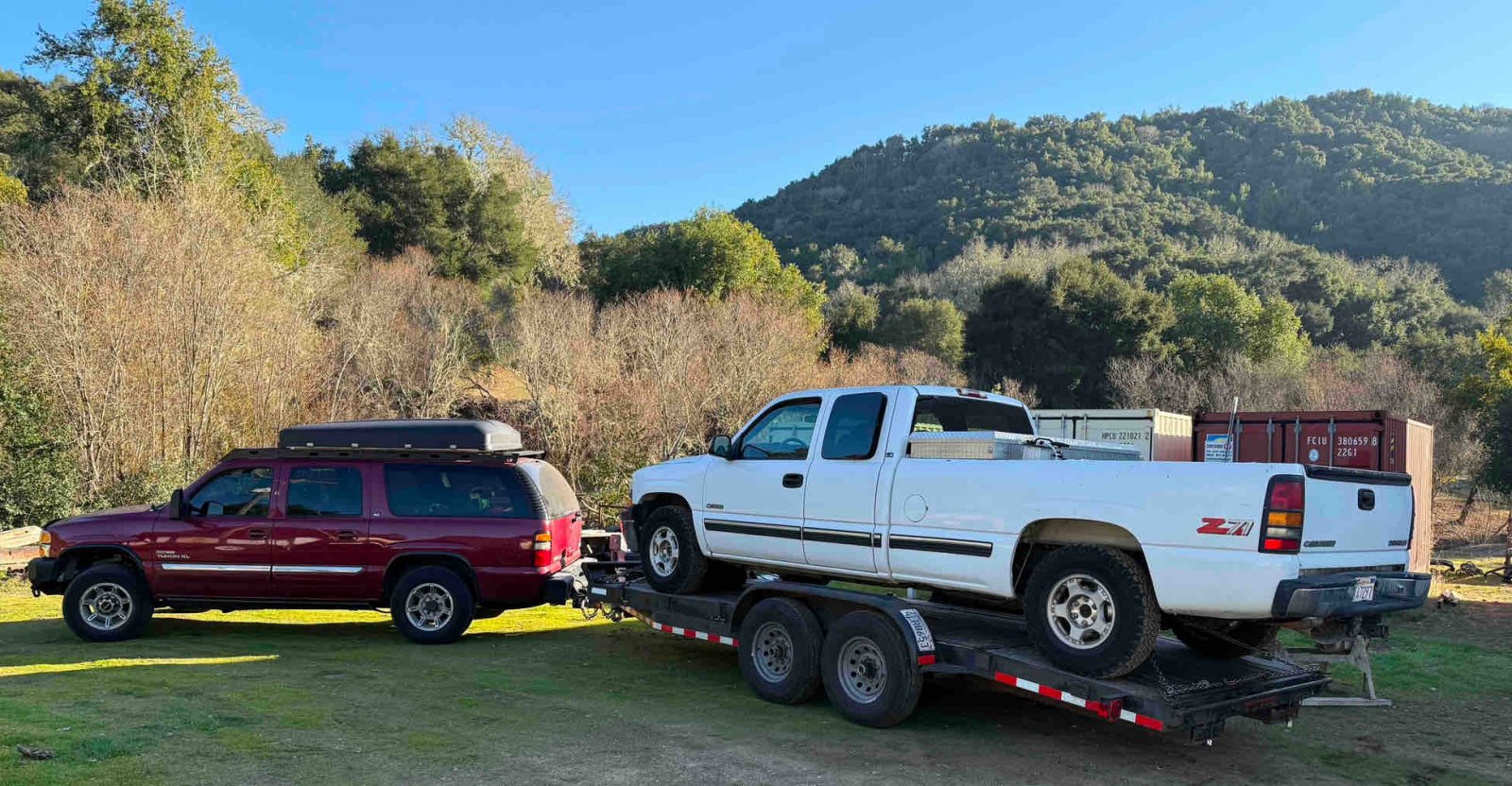

Well I have inherited my first truck back, a 2000 Silverado K1500 Z-71 Ext cab long bed.
I bought this truck new in 2000 with 7 miles on it because I was a dumb 18yo with a decent job. Lost said job a year later and my dad saved my butt and refinanced it in his name. He and my mom became the primary drivers of it and for the next 20-something years it was my dads work truck (painting/construction contractor). It hasn't been driven much the last 2 years but has had a pretty rough life in regards to deferred maintenance. I've done a handful of repairs over the years (water pump, wheel bearing, radiator, heater core, fuel pump). Currently has over 270k miles. Trans was replaced around 140k.
Currently it's being used as storage for my dad's work equipment. It's had its fair share of bumps and bruises over the years but still a pretty solid California truck.
My plan is to clean it out, clean it up and fix the broke. Then do a full maintenance job on it, new brakes, rotors, fluids, steering joints, ujoints, etc.
Then once it's a solid runner, I plan to do a nice level kit and put some new shoes on it. I'll get some pics up soon and a list of my tasks to accomplish first.
Overall hope to get a solid reliable runner for you-know truck stuff and give it a bit of a face lift... wish me luck

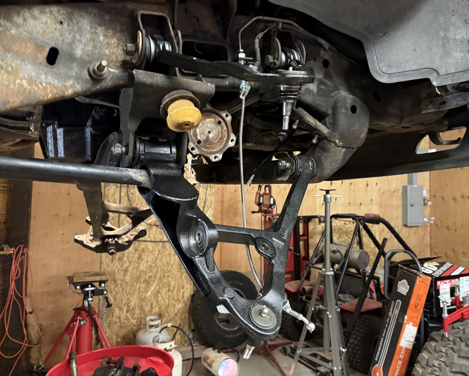

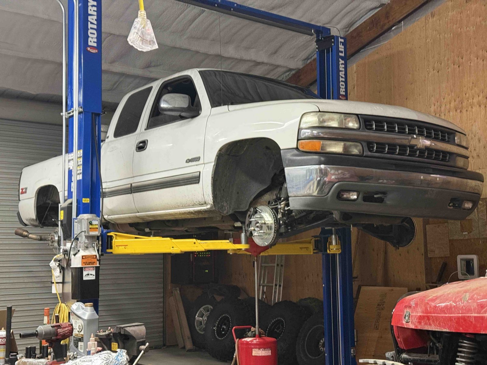

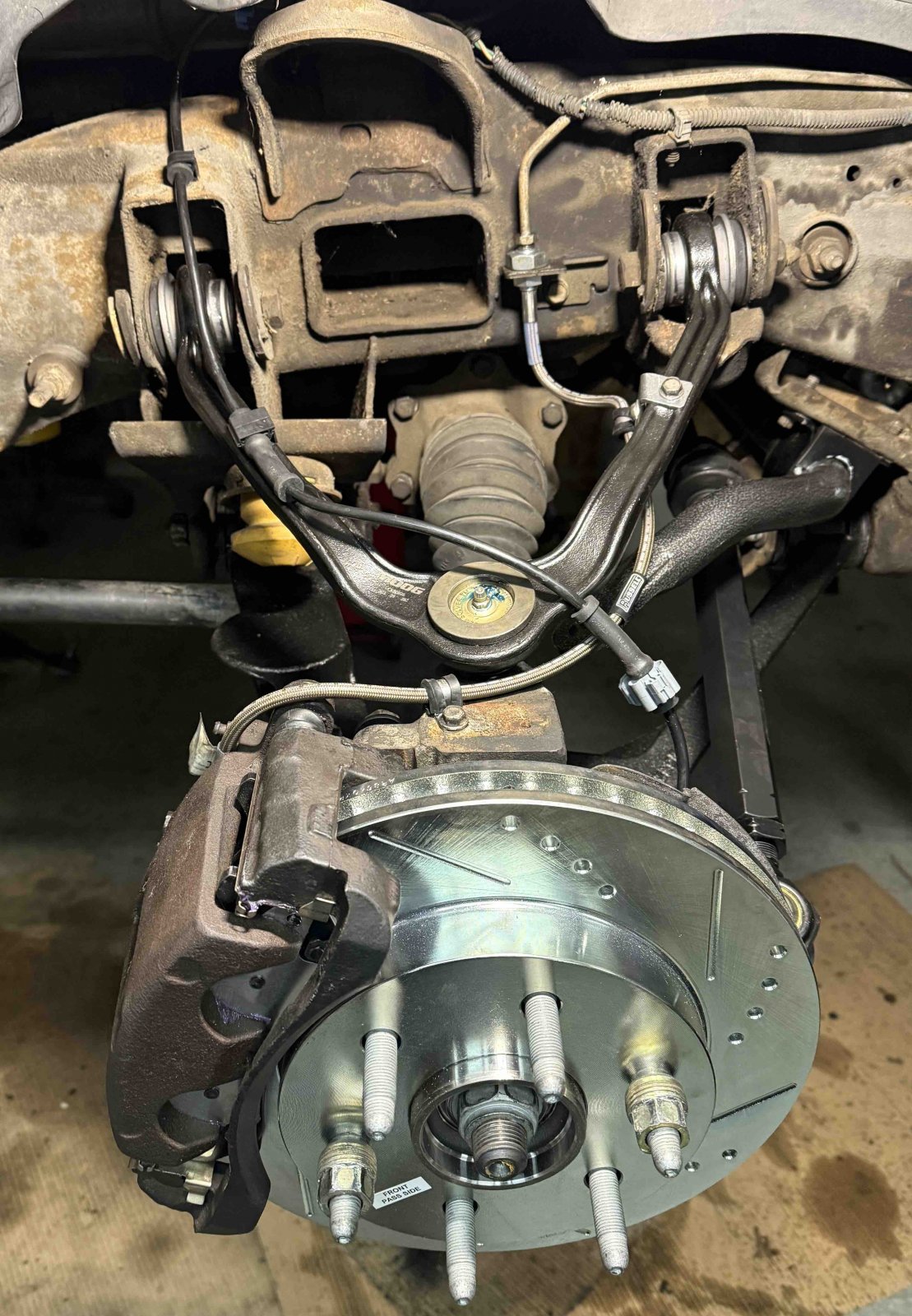

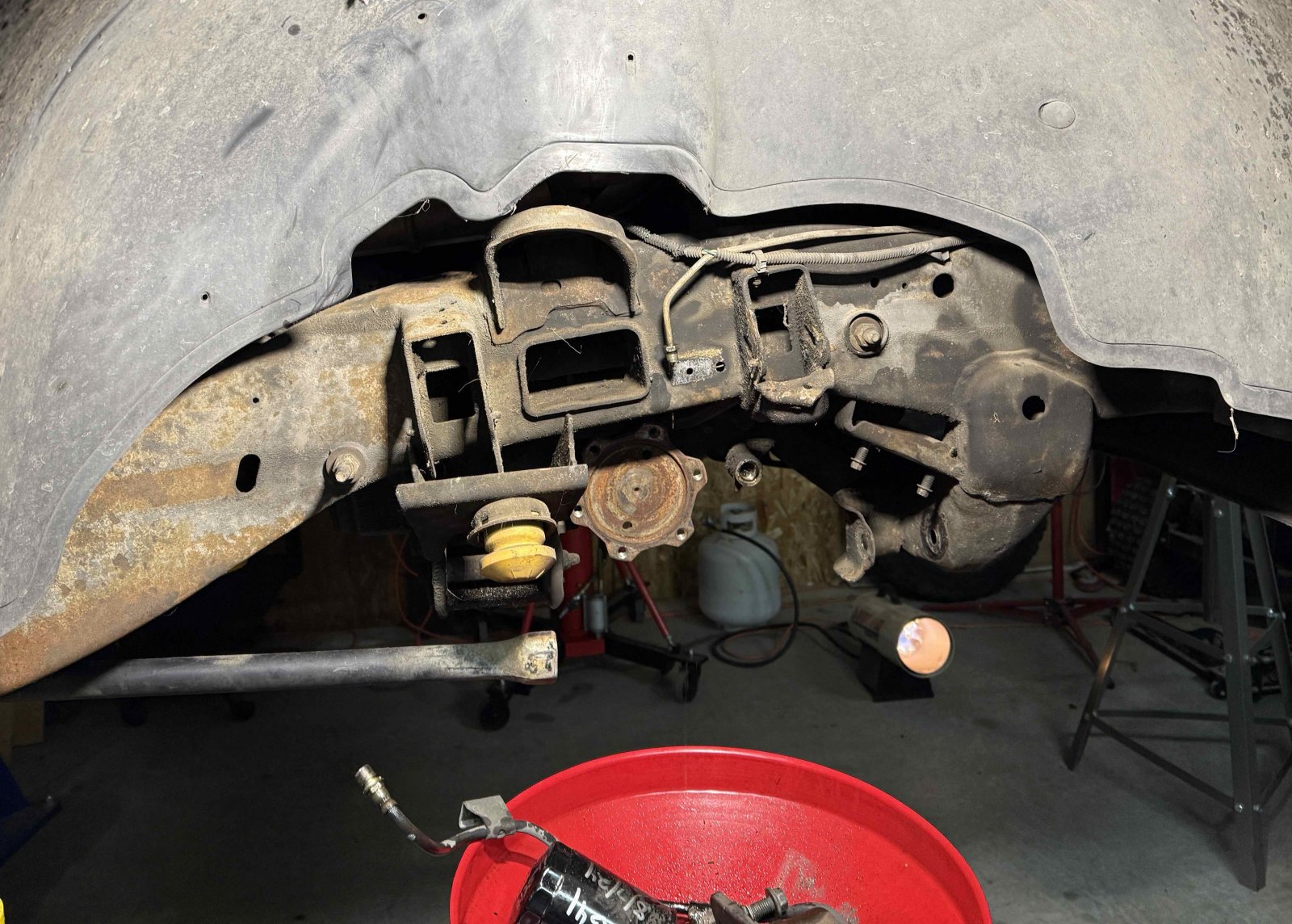

Installed new sway bar, pitman, idler, idler bracket, inner and outer tie rods, upper and lower control arms with new bushings and ball joints, unit bearings, rotors, pads and brake lines. Just waiting on shocks and sway bar end links.

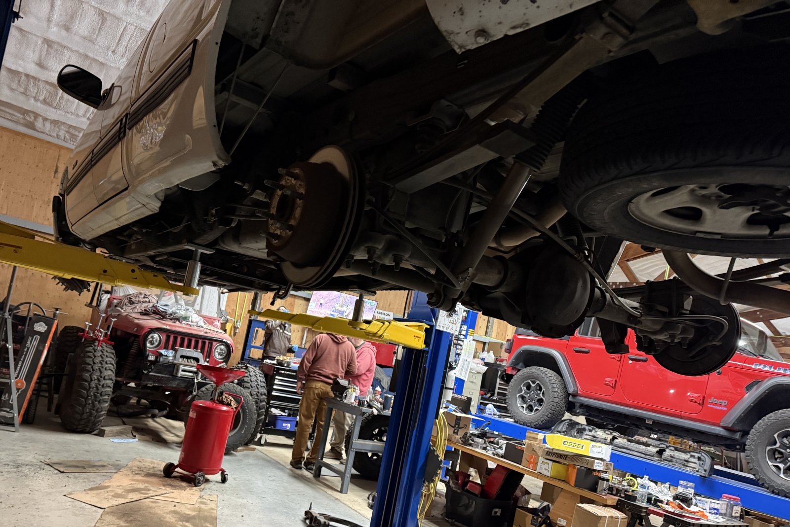

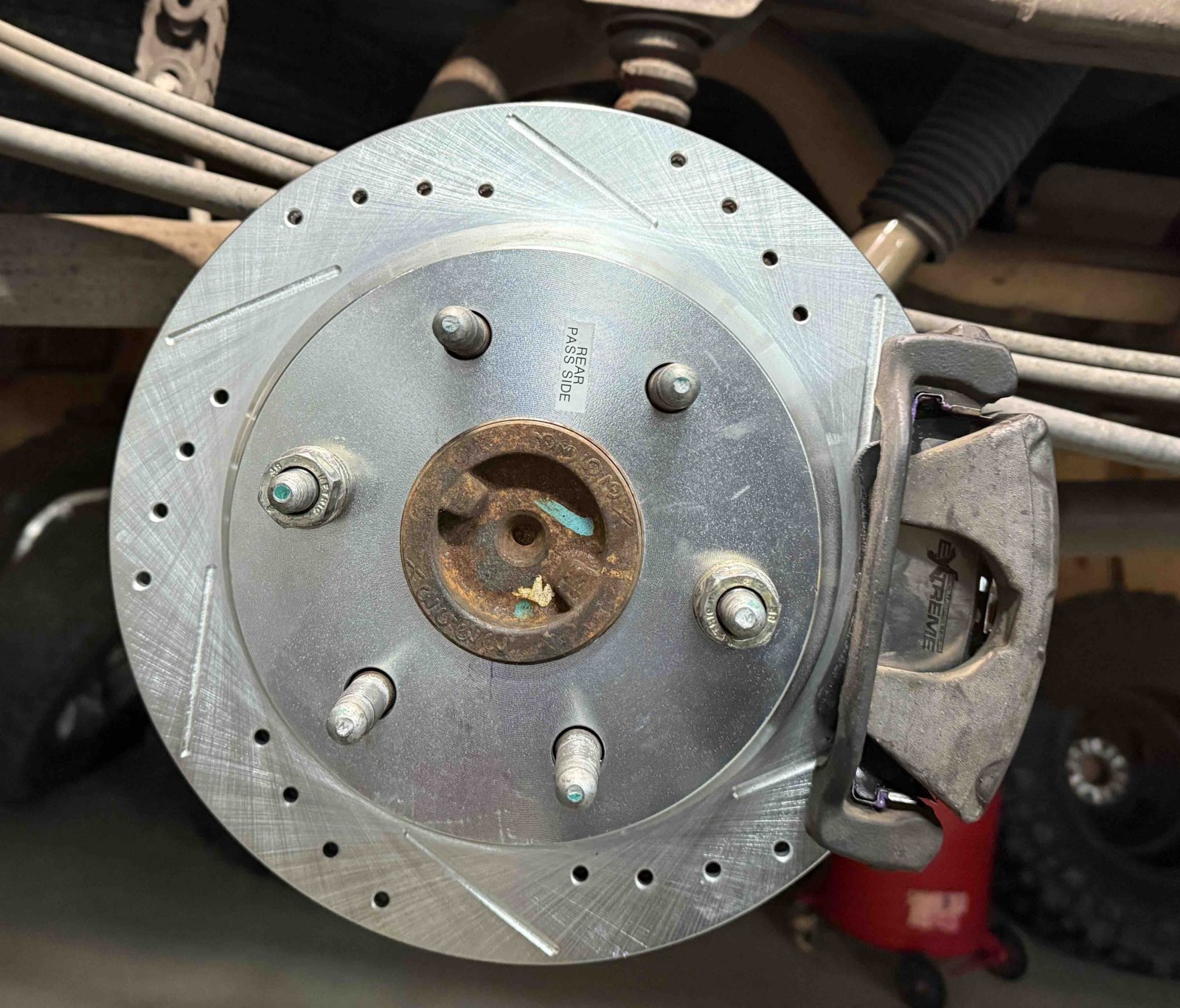

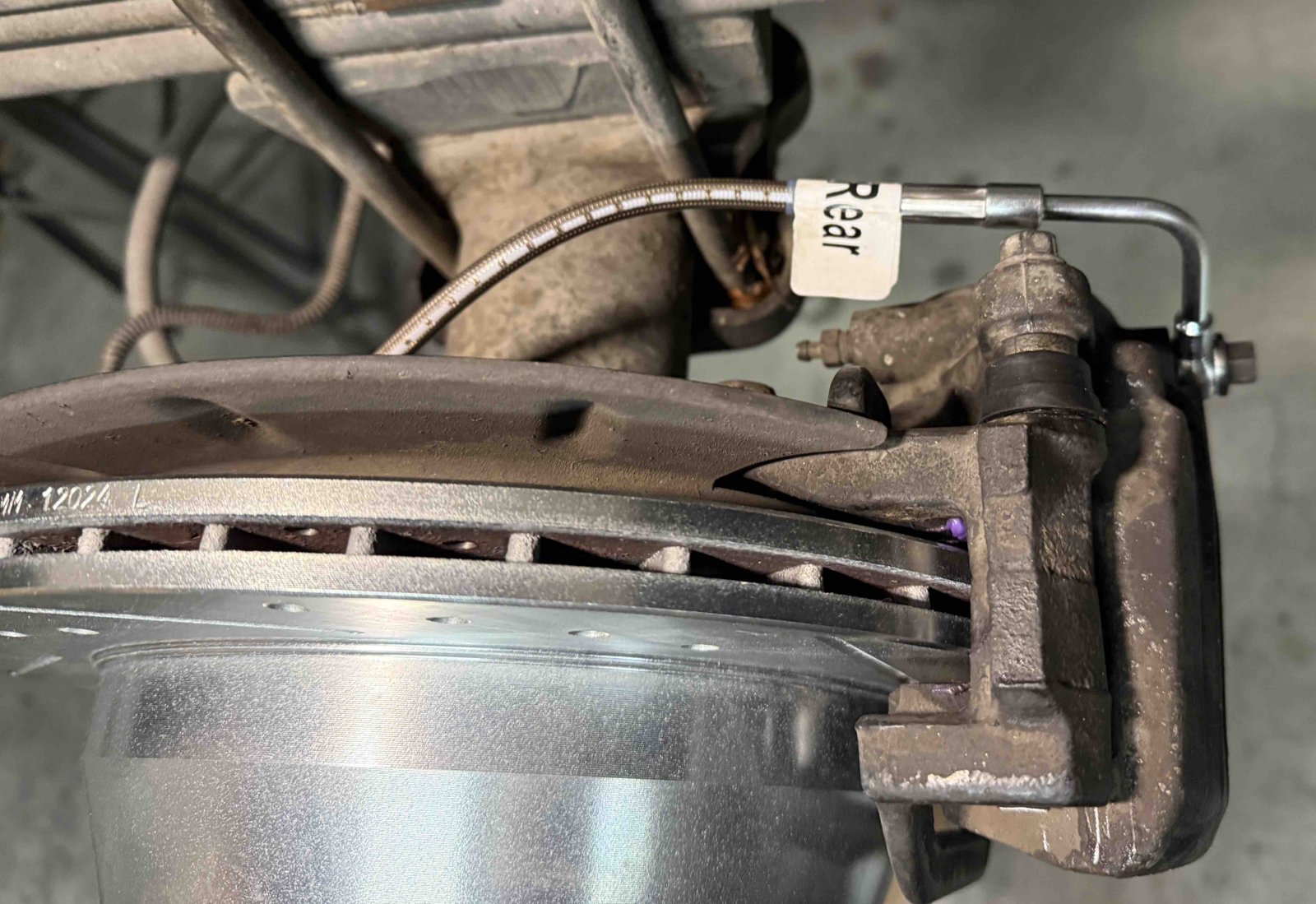

Got the rear buttoned up.
All the fluids drained and refilled. Generally the fluids looked pretty decent considering the mileage. The oil was pretty black but that’s expected for being 20k old. Power steering, brake fluid, Diffs and tcase were over 200k and trans about 150k. They looked about as expected for the mileage.
Got it torqued on its own weight and loaded back on the trailer for the ride home. Next up, alignment, spark plugs and wires then a really good deep cleaning.

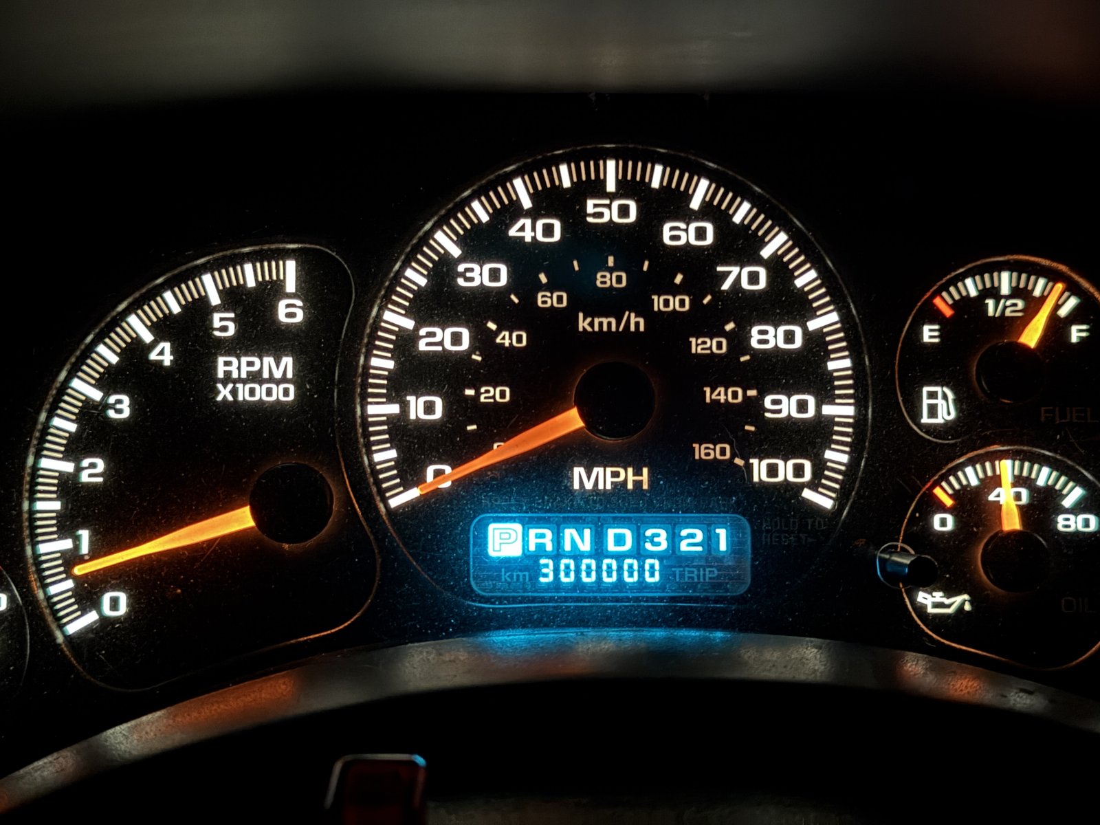

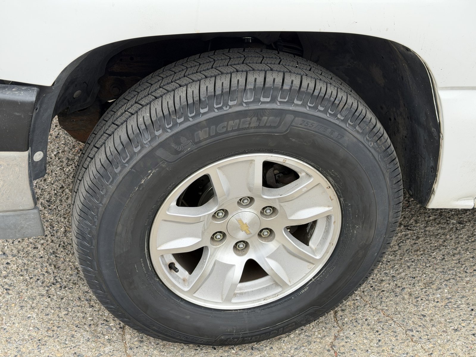

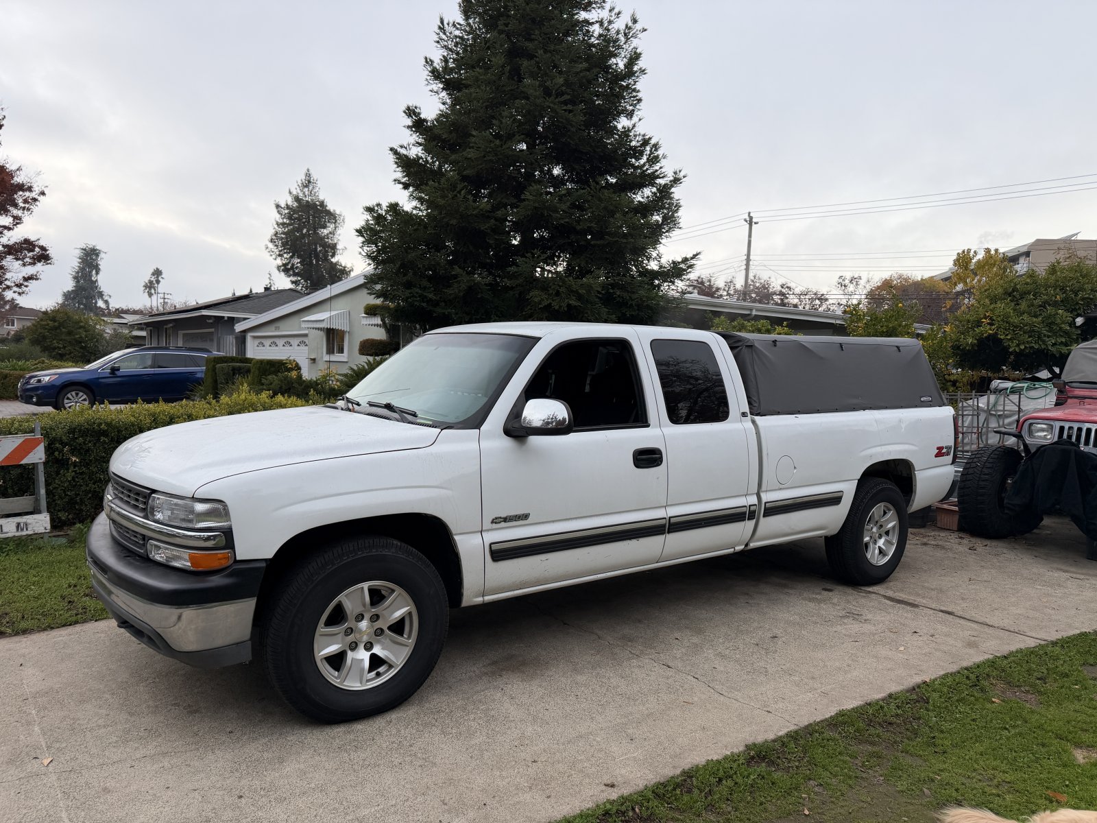

I guess I hadn’t updated this in a while.
Got the truck aligned, and everything dialed in. Changed out the shocks for some Fox 2.0’s.
Also got some new tires and now this thing is riding nice and smooth now.
Also crossed over the 300k mile mark a bit ago. Got about 302k on it now.
Got a good deal on a softopper to give some covered bed space during the winter.
Other than that, just did a really deep clean inside and been driving it regularly. It’s impressive how smooth and quiet this engine runs. Gonna see how many miles we can keep racking up.
