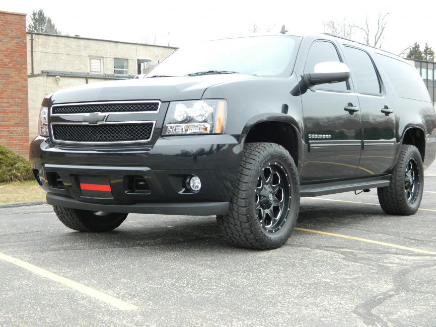

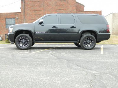

I think that if you go with the +35 offset you are going to rub on the swaybar. If you do not want to trim any metal then do not go with 305/55/20's. You can do 275/60/20's which are basically the same height as the 305's but are 11 or so inches wide instead of 12.8. Or if you want some width look at 285/55/20 or 305/50/20. I would stick with the +18 offset it helps with the stance of the truck. And no you should not have to trim/cut the front airdam.
I'll attach a pic of my 2500 burban with 305/55/20's, it sits much higher than the 1500's stock vs. stock.

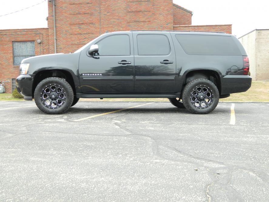

Well I am just going to dive in I think. The level kit should be here Monday and I will be ordering the wheels and tires on Monday as well. I am going to go with KMC Monster 20x9 +18mm with 305/55R 20 Terra Grapplers. I was going to go with trail grapplers but this is my wife's vehicle and the one we use all the time so the trail grapplers aren't as practical. Also I can get the Terra's in what they call an extra load tire vs an E load range thus hopefully making it ride better.
Here is a pic of how she looks now, just got the windows tinted yesterday. It's going to look a lot different hopefully by the end of next weekend!

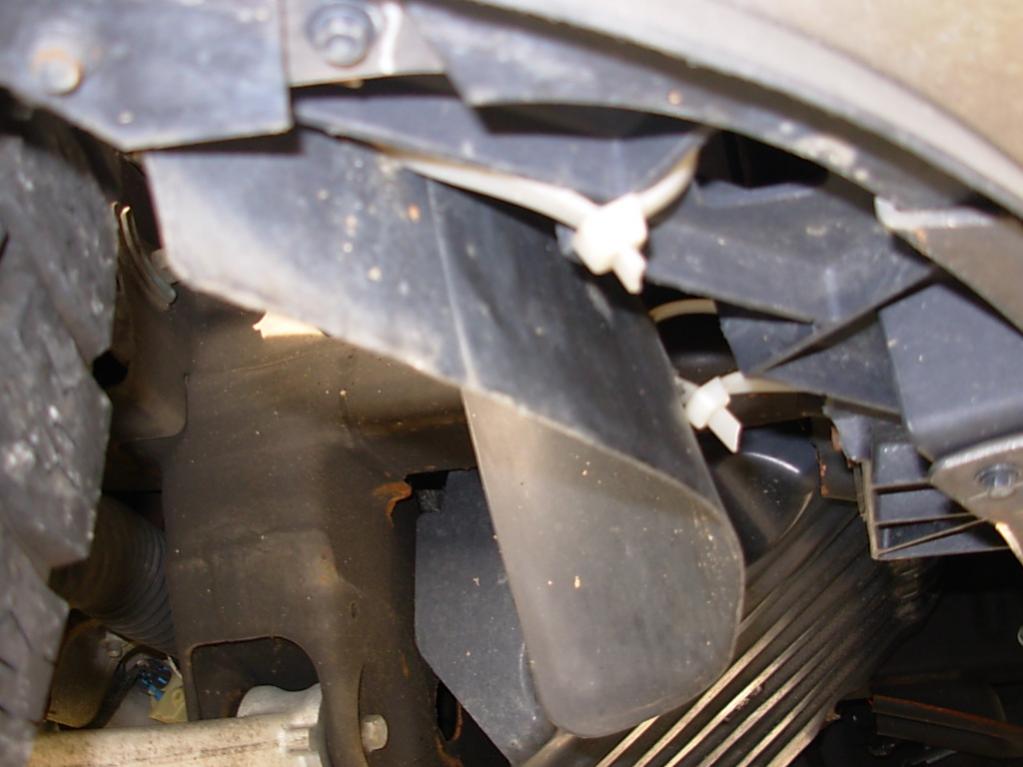

If you end up going with the 305/55's then you will be trimming so do not put the front tires on until you pull the plastic fender liner out. This way you will be able to see what exactly needs to be trimmed. Up front behind the foglights there is a plastic honeycomb type support, you will need to cut this support back. You want to cut just enough so that the screw for the front bumper still has a spot to screw into(the stock spot). Once you get it clearenced then make a couple slots in the remaining plastic support so one of those large(3ft-4ft) wire ties will fit thru it, you will need 2 slots for 2 seperate locations to pull the fenderliner back once it is installed again.The backside of the wheelwell is where the trimming of metal comes into play. If you go over to dieselplace.com and search for large fender mod you will find a step by step procedure to gain more clearance. If that does not do it, which it should then let me know I have a couple other tricks to do to allow a little more clearance.
Hope this helps, I know reading it is confusing and I can see if I have any pics of it, but crawl under your Yukon and just take it all in so you are familiar with the types of materials you will be working with and figure out if you have the correct tools to do the job.

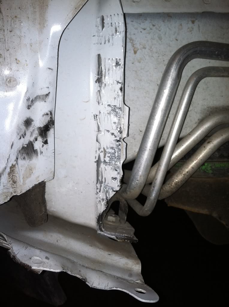

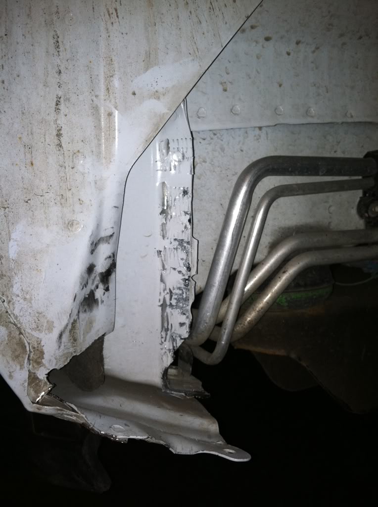

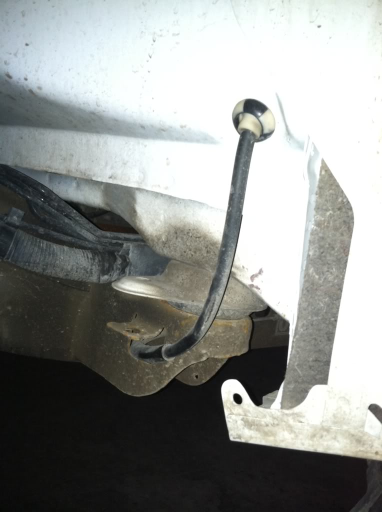

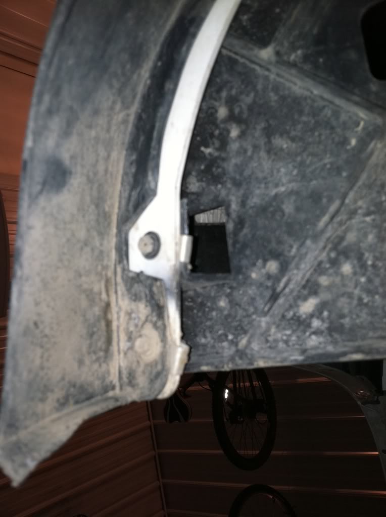

I got the liners pulled out the stock wheels off and the pinch weld on one side cut out. I am just getting ready to bend the lower fender back into place.
I was just wondering if you cut the cab mount tabs off that stick out on the drivers side as well?

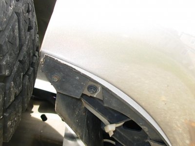

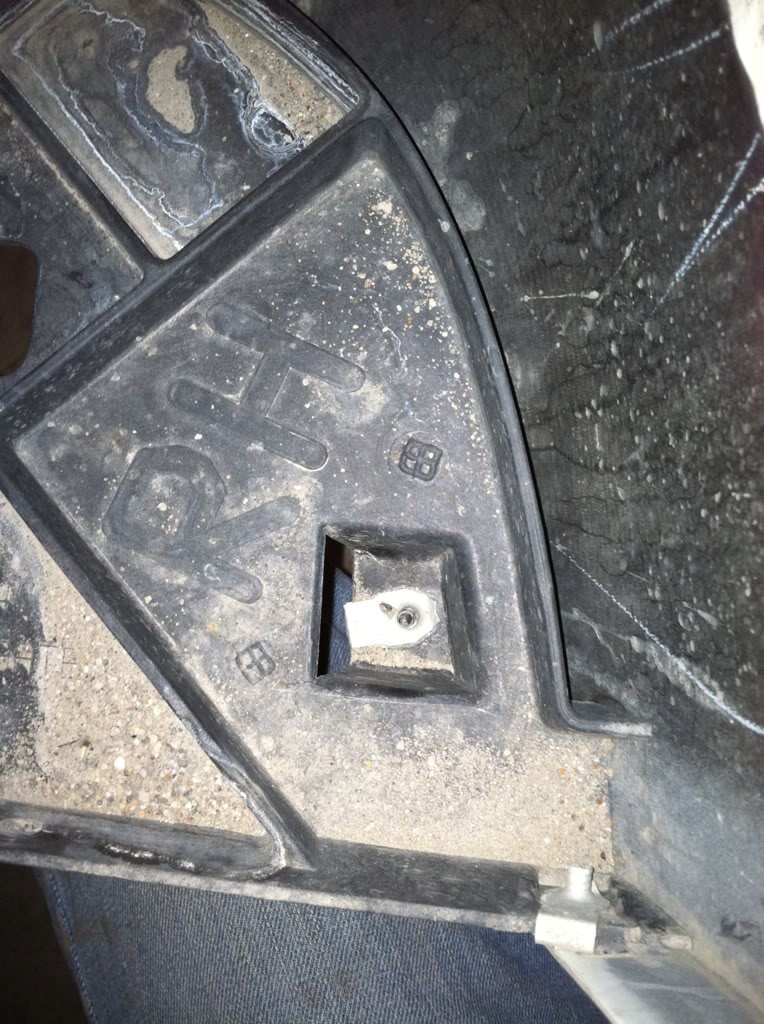

I was wanting to trim the front as well before I mount the tires and I think I understand what you were talking about when you said to trim up to the hole where the bumper gets screwed to. It would be the second screw in this picture.
Here is a view from the top. Here you can see the screw holding the bumper to the honeycomb spacer.
Did you just cut back following the edge of the bumper towards the screw that holds the bumper on and then just cut straight over towards the center of the truck to cut it off, or did you angle it to take more off as you went while cutting it off? Just wanting to get as much done now. I'm sure there will be some fine tuning once I mount the wheels and check everything.

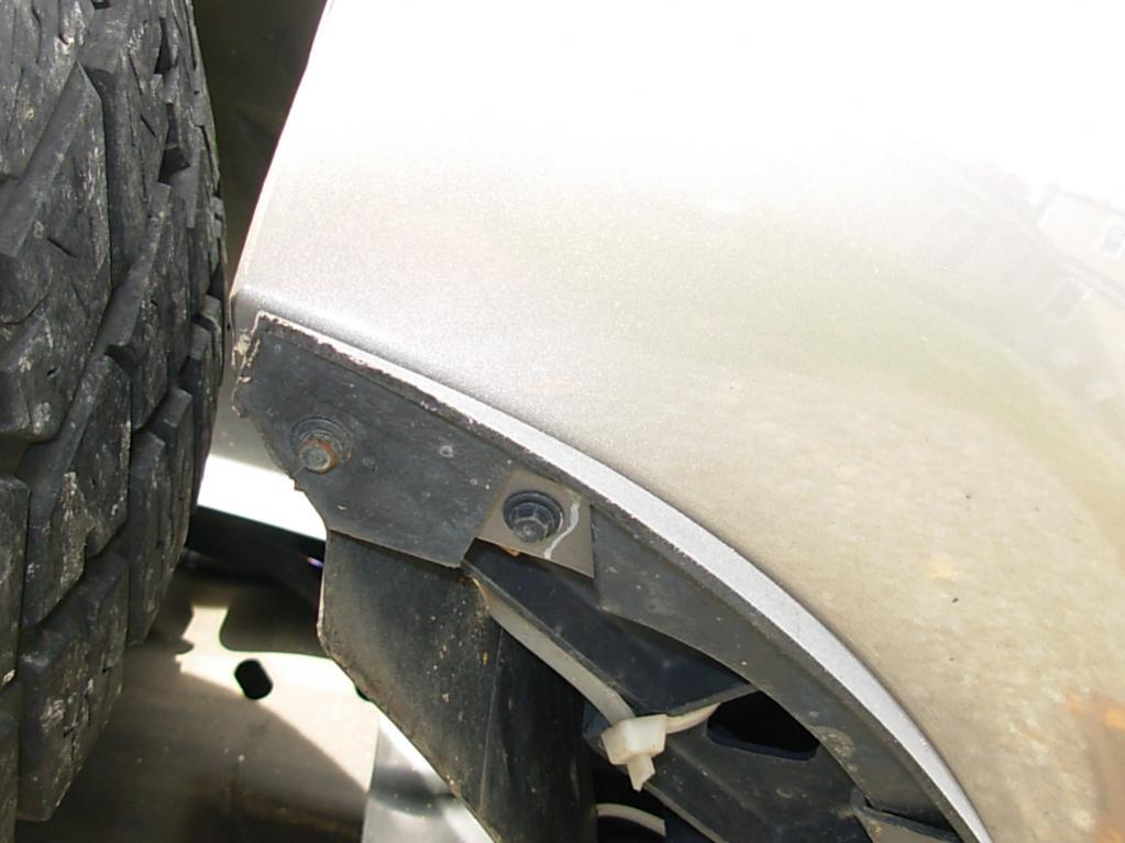

I will look for pics on the front trimming...you should not need to trim the cab body mount tab since it is far enough in that the tire arc doesn't come into contact.
