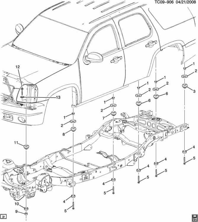

Pretty sure I've found the clunk sound.....BODY MOUNT INSULATORS! The front left one near the strut assembly is shot for sure. It also explains the clunk while turning and sounding as if it's in the wheel area but no feedback in the steering wheel. Looks like a fun project!
sbubbaklein
Sep 10, 2012
418
17
House Springs, Mo
these can squeak if not lubed. Check the shop manual for proper lube. Probably some kind of synthetic that wont wash out

I know you found the bad body mount. I see how you tested the ball joints. Did you unload the Ball joints to test? basically you use a jack on the lower control arm of the side you are testing then check for play. This makes a big difference. Just throwing it out there.
