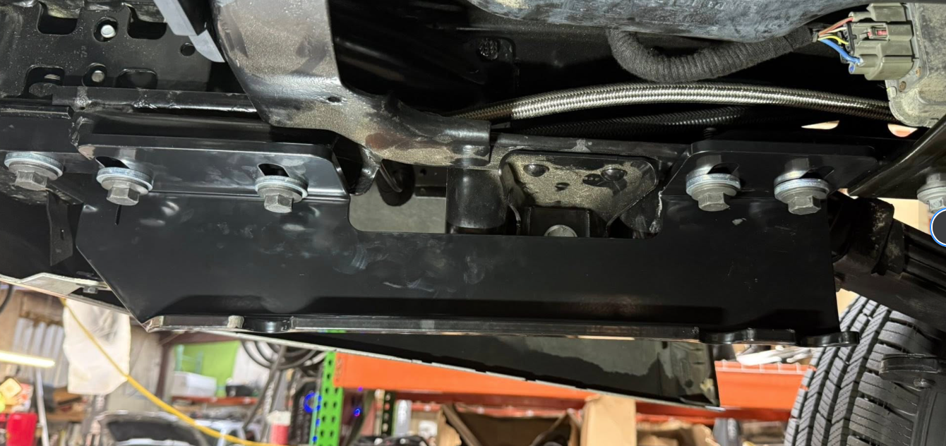

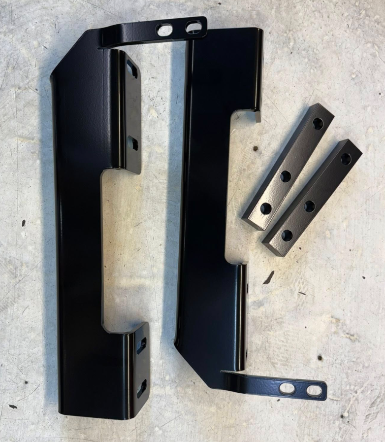

No, but I see that the guys over at Duramax Specialties have designed a frame brace for the factory hitch to address the frame bending/hitch droop problem that some of their Duramax-converted 3/4 ton Suburbans have encountered when towing heavy with the factory hitch. I have a Curt class V hitch for the GMT800 2500 suburban but it would require modifying the plastic bumper fascia and spare tire hoist to install it on the 2018 3500.
So, I think I’ll wait for the Duramax Specialties guys to put their brace in production and go that route. It’s a bolt-on solution, too.

Here you go: https://www.facebook.com/share/p/14PRDNQXwvm/

I’m in need of a front hitch for the 3500 burb and the folks on the interwebz with GMT900 2500’s who know things, say this is the one to get. So I’m going to try it and let you know. Airstreams aren’t known for exterior storage so I need a place to haul the Predator 3500 when we boondock. It will double for bike hauling when needed too.
I’m curious if it will work because I thought the frame was pretty similar to the 3/4 tons Sub so I would have initially shopped for a 2013 Suburban 2500 front hitch?
Yup. The guy I found out about it from installed it on a 2013 Suburban 2500 and says it works.
