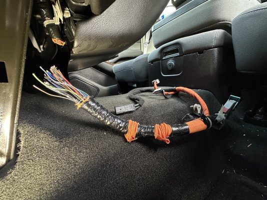

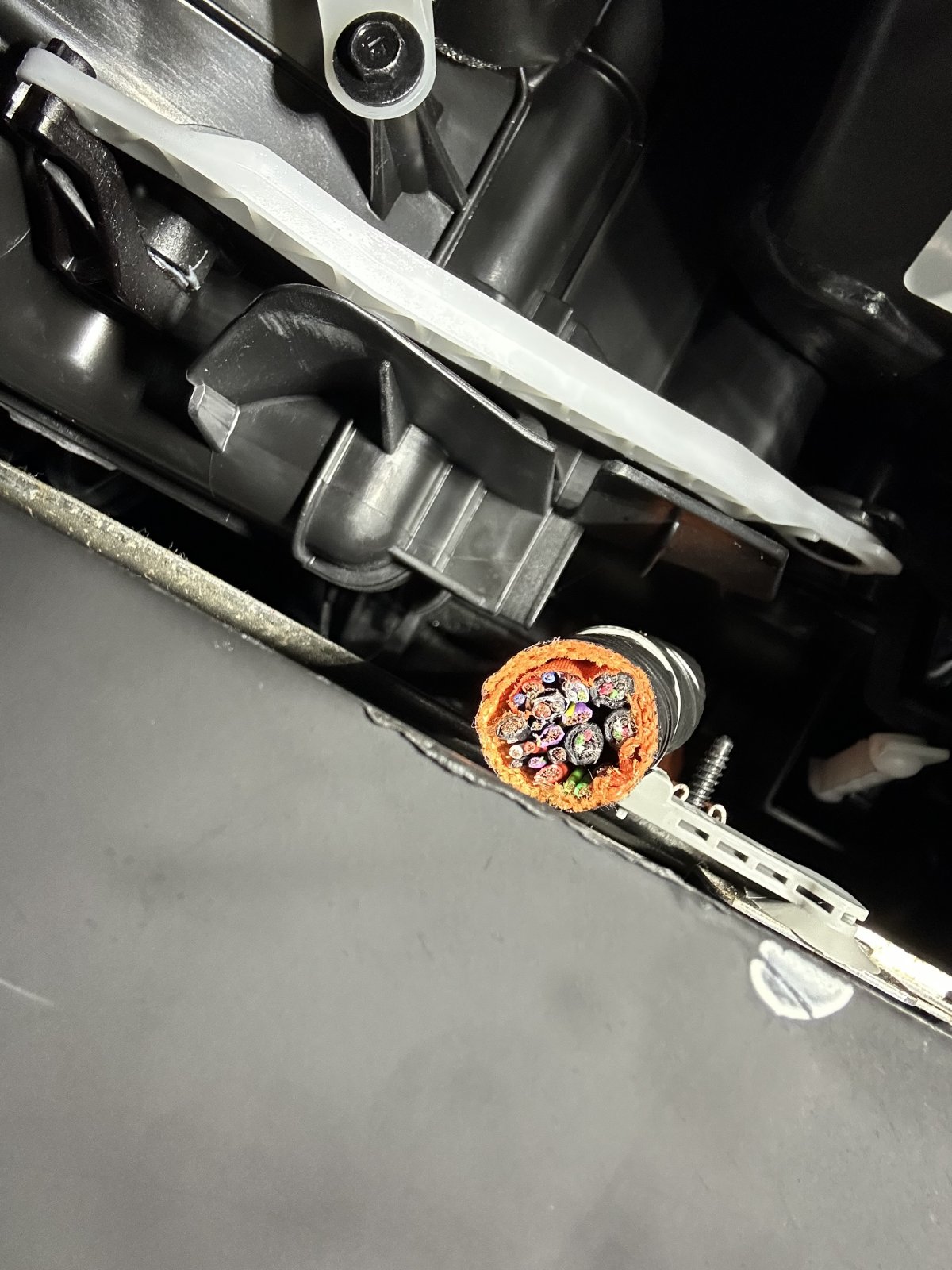

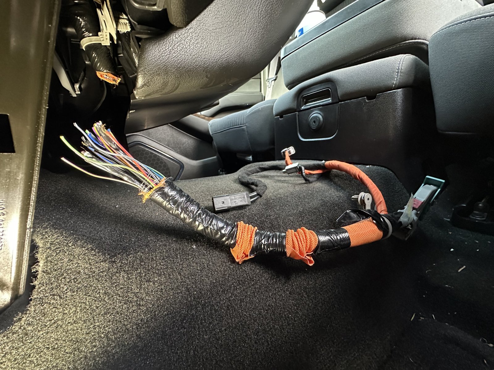

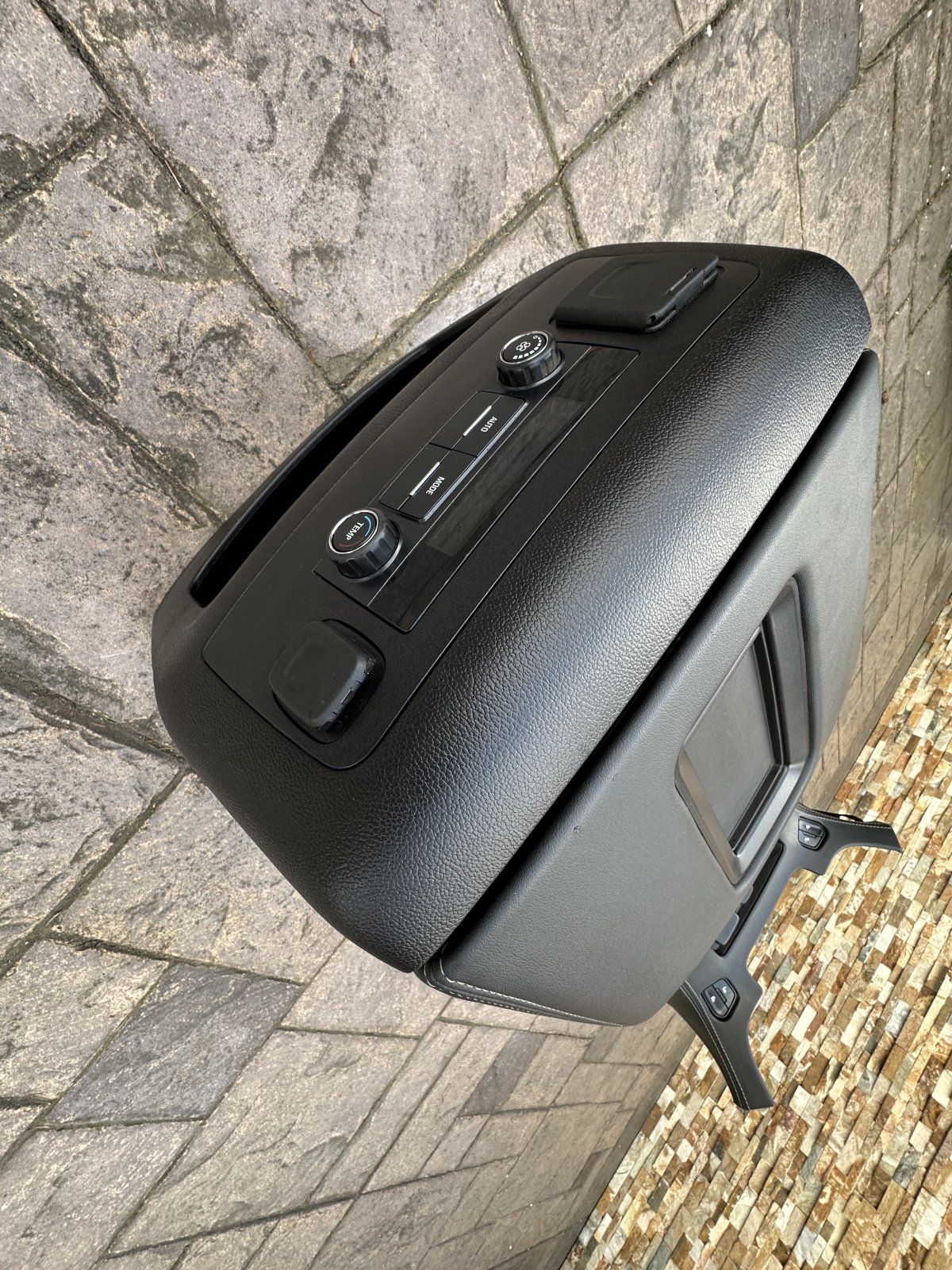

TripleFJeff welcome to the forum. Thats what Im currently working on. Bought a 16LS Homeland Security Suburban which had the police center console in it. They took that out and placed a central jump seat in it. The main dash wire they cut so non of my USB plugs work (see attached photos in the forum) Everything else works fine. Just got the harness and a nice center console that has the buttons for heated seats.
My question are where I can find color coated diagram for the harness so I know what each wire does before I splice the new harness into my cut harness.
Also wondering if my cloth seats have the heating elements in them.

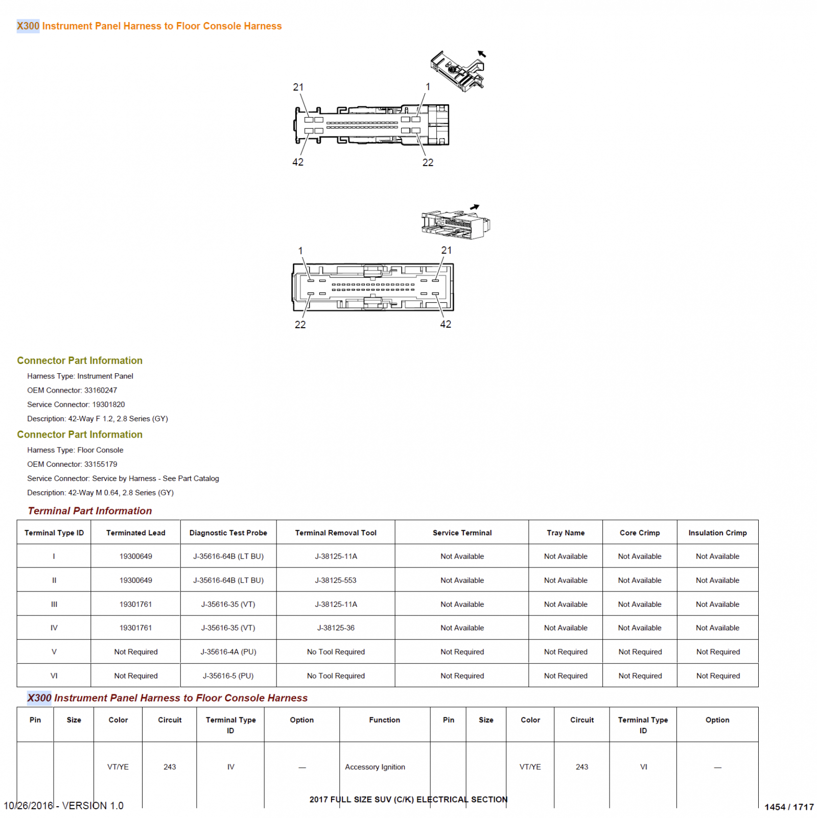

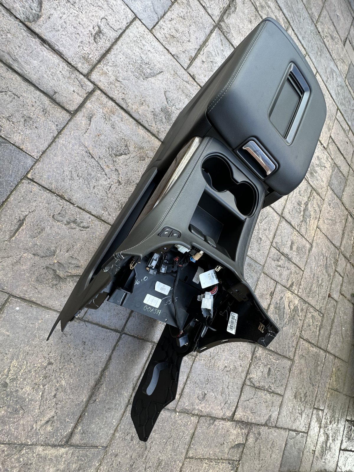

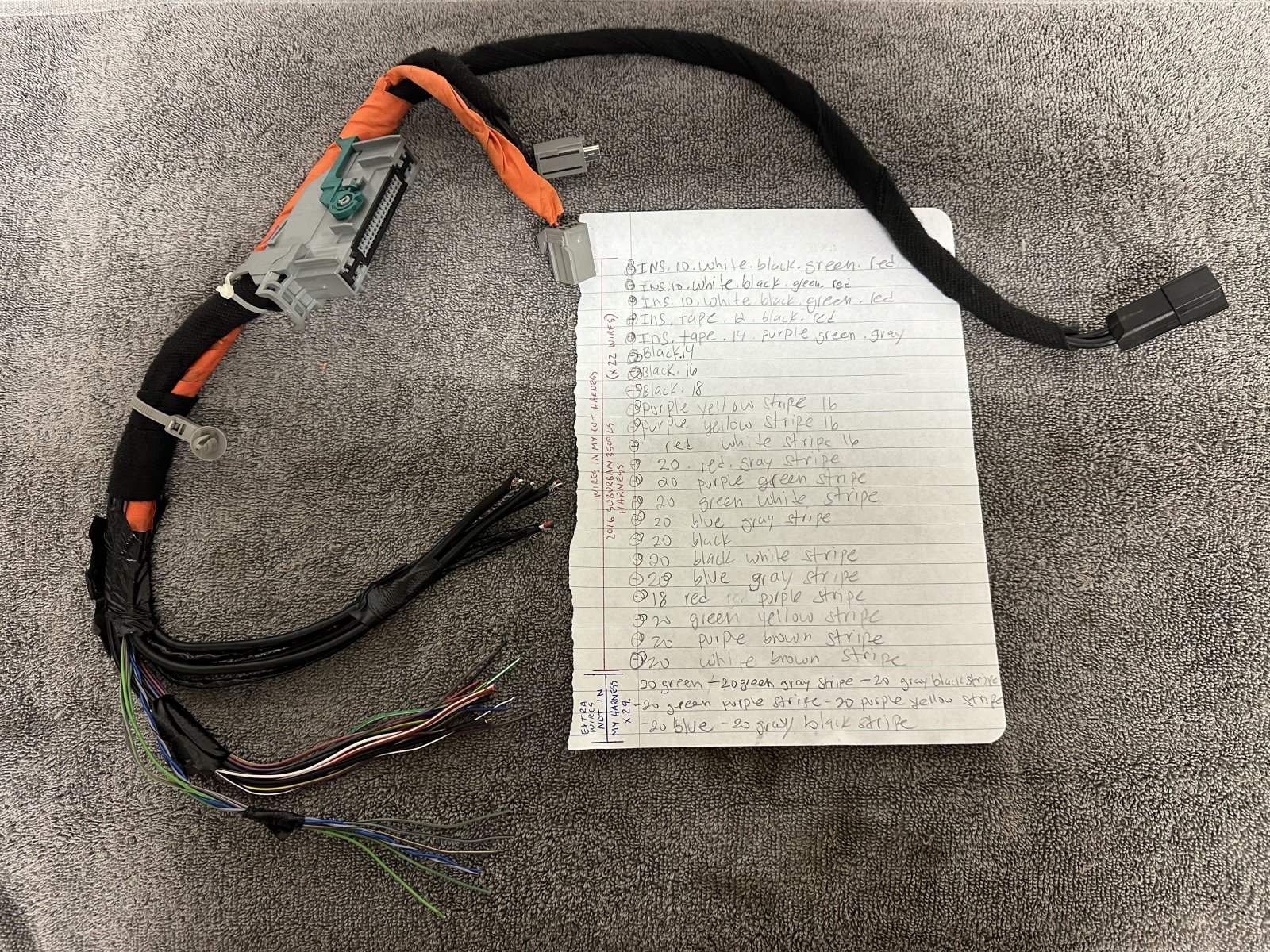

Team, quick update on my center console harness.
Finally found a little time to go through wires on my 16 Suburban 3500 LS that were cut and compare to the wire harness I purchased from a wrecking yard.
I have attached photo of the wire harness that Im trying to attach to my cut harness.
I have also attached written colors that are on my suburban and compared to the harness I bought from wrecking yard to attach to my suburban.
My next step is to somehow find out what each of these colors are for before connecting.
What route should I go to find color codes. I’ve been unsuccessful finding anything online.
Would my local Chevy dealer have this info?
Thank you,

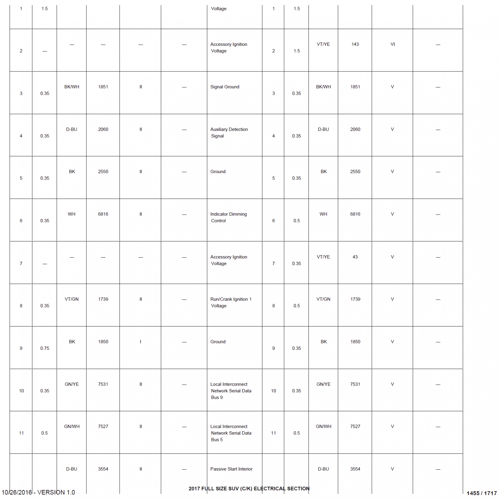

All of that information is in the upfitter manual that I linked to above. Did you look at it? For example, X300 is that big connector. Here is an example.
