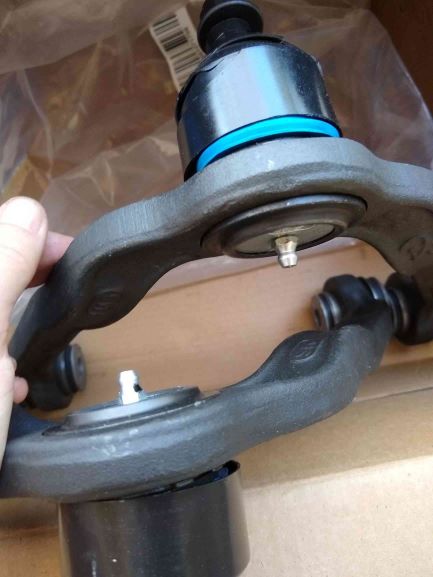

Got a new to me leveled 2003 tahoe z71 that needs the front suspension worked over so I ordered the mevotech kit from RA. Decided to give them a chance because Ive gone with Moog problem solver stuff in the past and have had problems with them... So if I'm gonna gamble, might as well go the cheap route, right? See the control arm on top. The ball joint is a little crooked and isn't pressed in all the way. Im not very experienced with suspension stuff but this cant be good particularly when on a 2 inch leveled front end.

It looks to me that you need to send them back for a refund.

Thanks for the warm reception. I've seen so many questions about mevotech but no real explanation other than they are bad. I've looked over other forums and saw that mevotech made good parts. I just wanted to share an experience that could help the community.

I just got mevotech upper and lower control arms and outer tie rods from rock Auto but I got there tough terrain extreme ones with larger ball joints and I think thicker casting. Mine all look and fit good and my ball joints are fully seated lifespan of the parts idk yet haven't driven on them yet. If you know someone with a ball joint press they should be able to fix the one you got or you can ship it back and get another

I just shipped it back for replacement cause with my luck something catastrophic would occur and I'd have to order another one anyway lol Wish there were still part houses around so I could compare the parts. I got the "supreme" line parts. I read on one of the truck forums, cant remember which one, that the ttx and supreme were the same aside from color and clamps on all the boots. Really who knows without pictures or real life experience. toyota guys seem to like the mevotech control arms. I'm sure its because they are SPC parts in mevotech boxes
