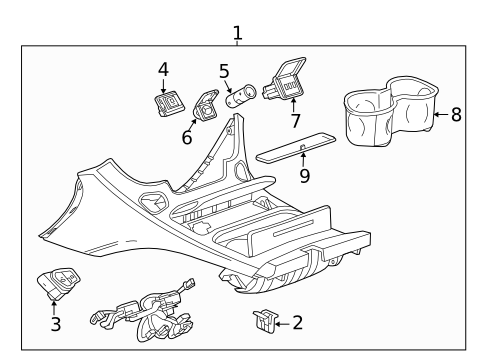

My 2015 Tahoe LT with Lux package did not come with the front seat cup holder cover. I actually hate the way it looks without it being covered. Same with the little opening for junk and the usb opening. Neither one is covered. I am assuming I would have to replace that whole section as Ive seen them on ebay listed for $200? Is there just the covers that I can purchase without replacing that whole part? Thanks
ajs800
Jun 24, 2009
706
198
Michigan
you'll need to order LTZ / Denali console trim. I am planning to do this with our SLT once we decide to keep it long-term.

I've had the same thought with my SLT Yukon. GM Parts Direct is selling what looks to be a complete assembly, complete with buttons for seat heating and cooling.
No such covers would exist, since they functionally would need the "track" to recess into.
One of these days I'll get around to doing this, but post pics if you beat me to it!
http://www.gmpartsdirect.com/auto-p...l-v8-flex-engine/body-cat/center-console-****

Seems like the cut outs are the same size (from looking at both--some in our company have LTs--me, and some have LTZs). So I don't see why it can't be done?

Hi I'm trying to install this in my 2015 LT. Does anyone know how to remove the existing one?
darkoverlord
Jan 20, 2012
14
I brought this console with the heated/cool seat buttons. If you get one with these buttons they are easy to swap out. Completed my install today.

Looks great I got my console in yesterday. So just swap out the buttons and use the wire harness in the new console? That was my only concern, if I use the harness in the old console or just put the heated only button on the harness attached the the ltz console.

Yes swap the buttons with what you currently have and use the wiring harness of the new one. The button come out easy.
