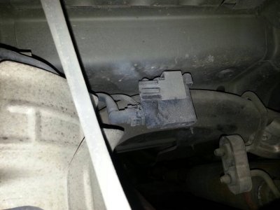

Ok cause I am going to make sure the line runs to the top of the tank. As long as it does I will unhook the hose go to the gas station and see what happens

Doesn't the line go to the EVAP canister not the gas tank?
