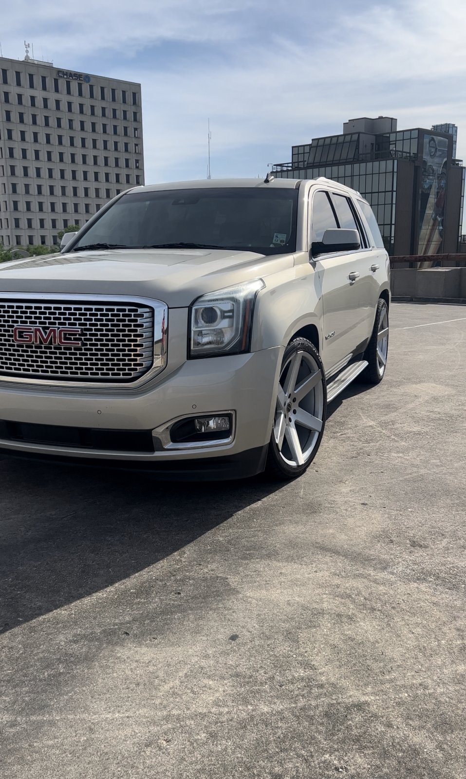

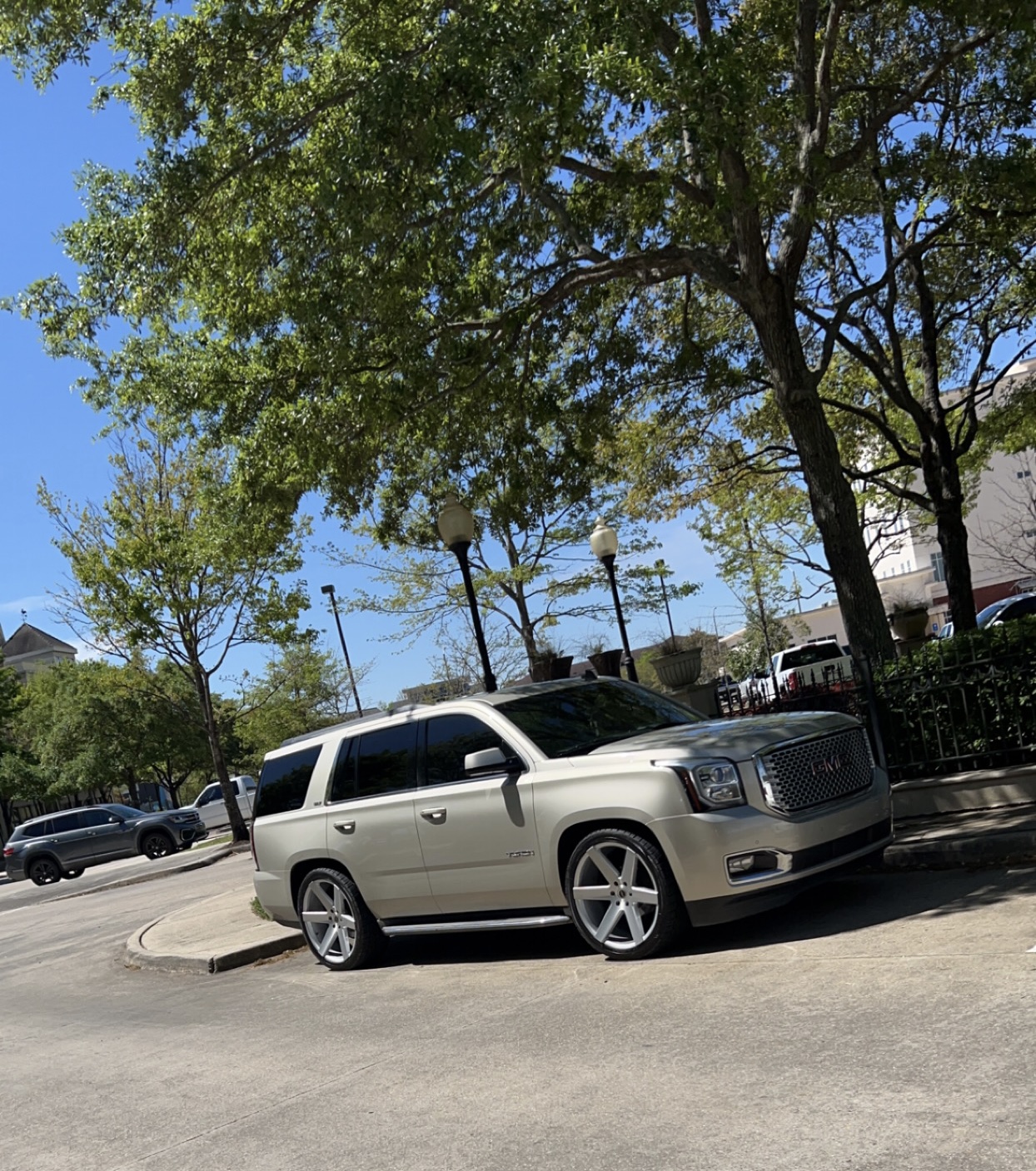

Pics of the vehicle in question, looks good!
