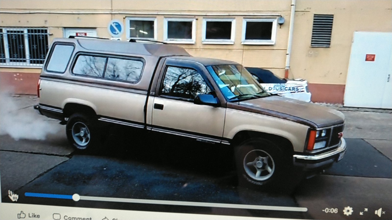

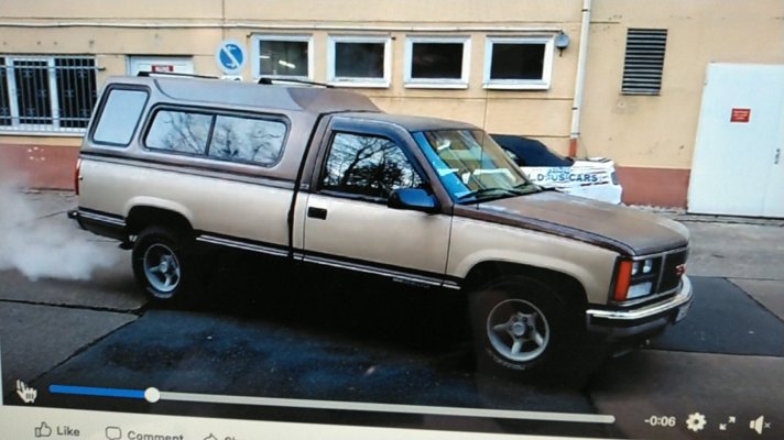

Contact the German company that exported my 1988 GMC C2500 to Germany about 5 years ago. ( I sold it to a collector, via a rep, who is in Tampa, Florida. )
I am sure they can coach you on the details on, USA to Germany, and their requirements upon arrival.
< OL.D. US-Cars Gera > Check them out on their Facebook page, etc.....
( This video / photo was sent to me from the buyer when he picked it up )
