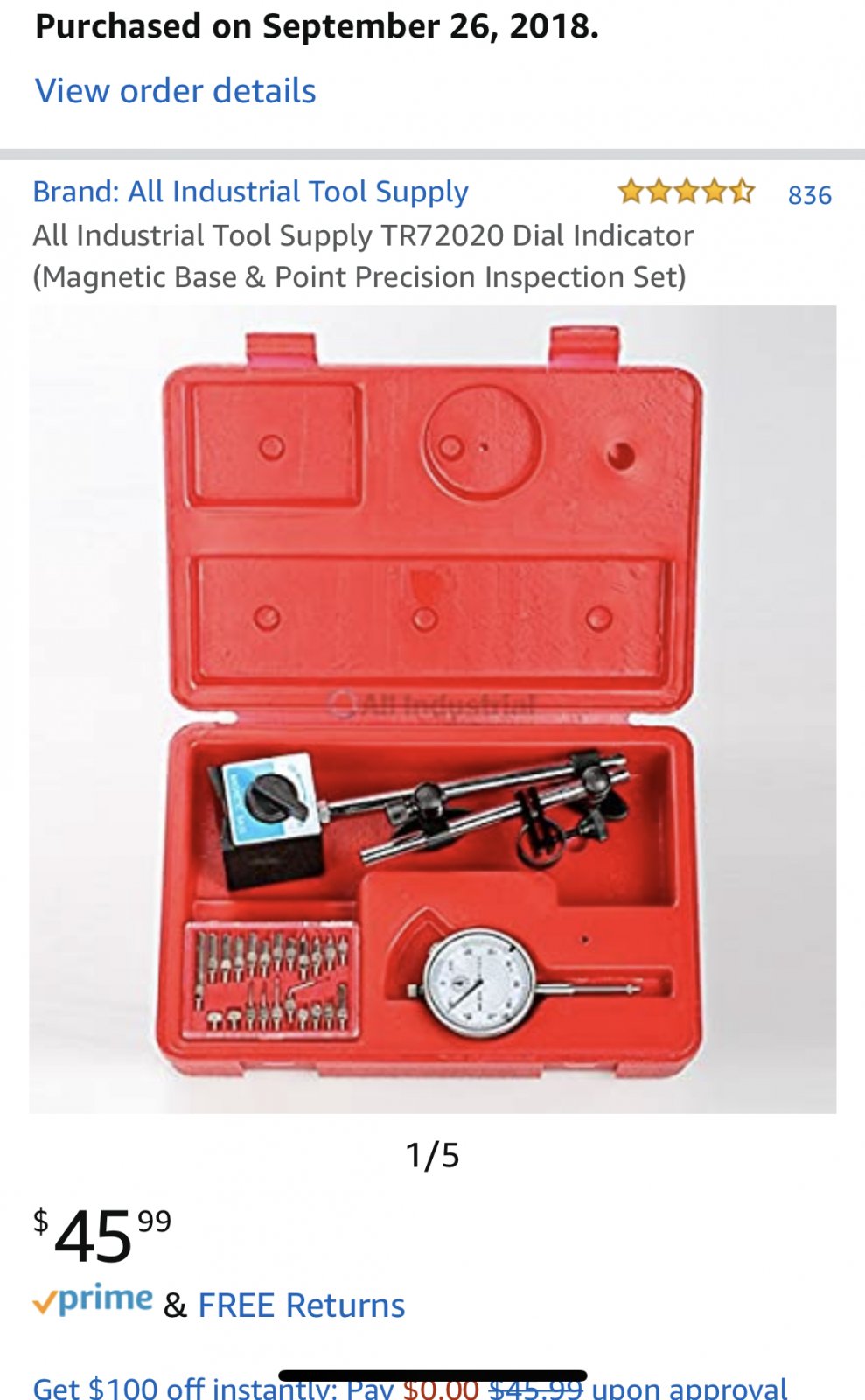

I second the Powerstop rotors and pads. Don’t have them on my Yukon, but installed the drilled and slotted on my Camry and worked out really well. Pads on drilled and slotted will always wear more quickly than flat rotors. Be sure to test for rotor runoff after installing the new rotors. I got a good dial indicator that has a strong magnet from amazon to check for runoff..
