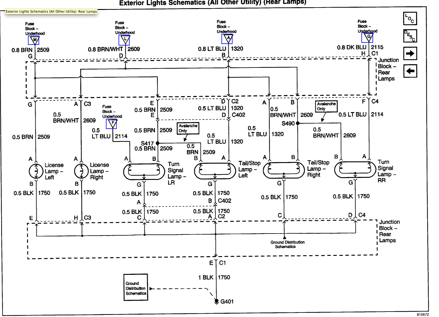

Here are the schematics:
Two separate circuits feed the stop lamps and the center stop lamp.
Recheck your fuse for "VEH STOP" (10A) that feeds that circuit.
Having checked that and assuming it's good, check the connectors at the tail-light junction block. This in a place where the connectors can get very dirty and/or corroded. Pull the connectors off and inspect them. Make sure they are clean and if not, clean them with some electronic terminal cleaner or carb spray. Reconnect and then recheck your fuses. Then check brake lights again.
