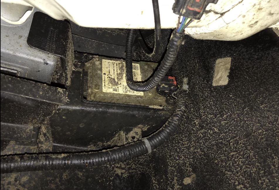

@Doubeleive those sensors in the sides of the back bumper on k2’s too?
