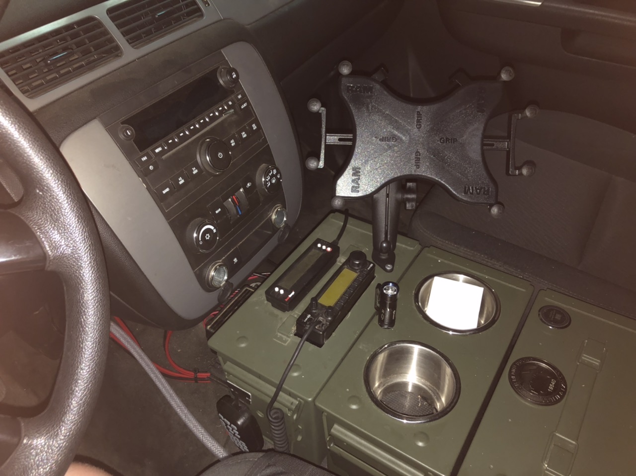

Screens? I only have manual controls in my PPV.
