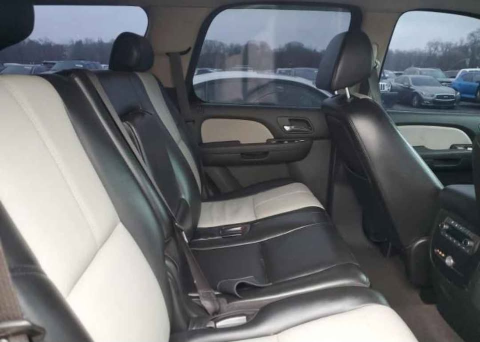

Does anyone know if it was only Z71's or what model these seats came in? If there's an RPO code that associates with these seats? Prefer the Silver over the Orange but either would be nice. Also was it an option only with the second row bench or did it come with captains chairs as well? I've tried searching through Car-Part and the local junk yards but to no luck.
Pic for reference

You would see this in the early years of the Z71 SUVs, from 2007-2009 or so. You see this all through the production run of Z71 Silverados and All-Terrain GMCs, 2007-2013. Not all had it, but if they did it would look like your photo.
One of my pickups has this interior and the relevant RPO codes are:
85I INTERIOR TRIM ANTHRACITE TWO TONE-GMDAT INTR TRIM COLOR(85I)
853 Unk. (Trim Combination, Ebony and Light Titanium)

Much appreciated! Thank you!
