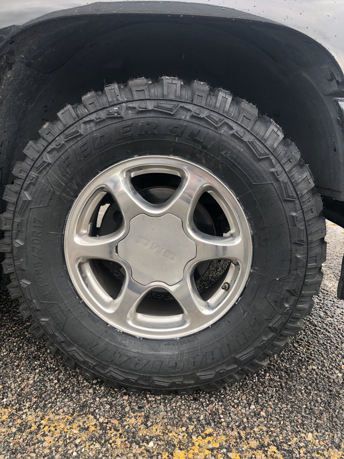

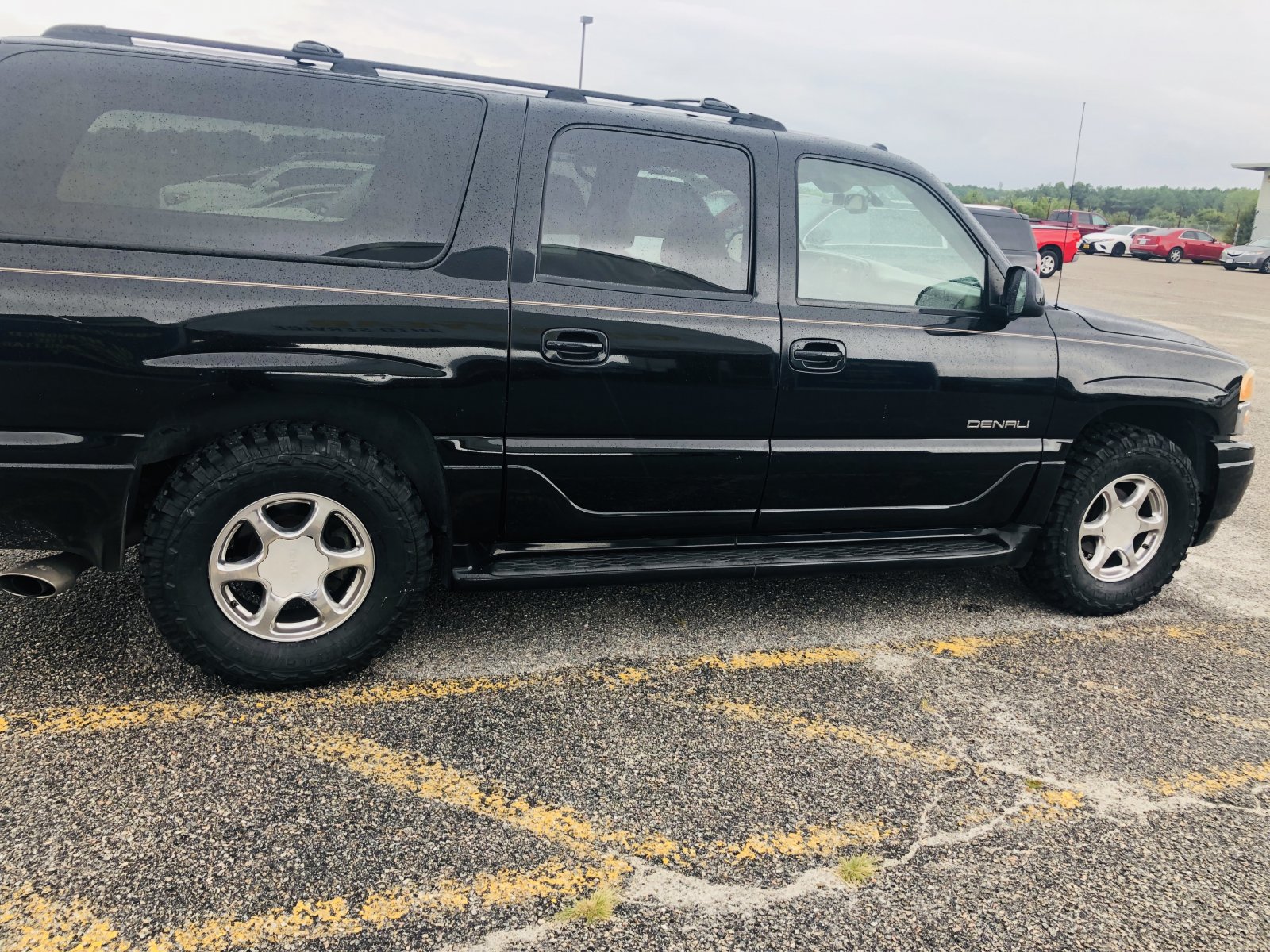

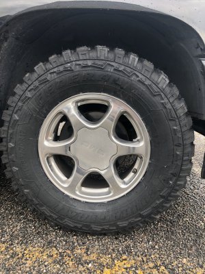

Phantom1234
Aug 15, 2019
285-70-17 no rubbing 100% clear
BEBDE4EF-A30B-4ABD-A498-87C176A7076F.jpeg 2F74B2D6-0D54-4EB8-8B92-AB61E7AAACEF.jpeg
