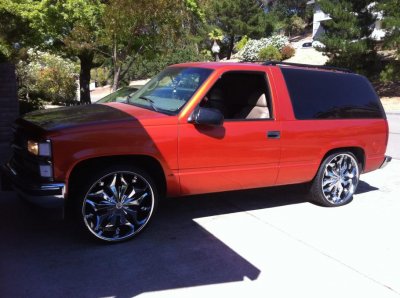

Heres my painted truck, the other one is in my cousins garage waiting for an LQ9. Hopefully I find one before summer ends lol

Nice lookin Hoe. What suspension are you using?
Thanks

When I first got the truck many years ago it had heated front coils and bottomed out all the time. I took it to a mechanic and he told me the coils were heated so he can put new springs in. Honestly I don't think he put OEM height springs because everyone says the front does not look stock height. The back has shackles by the way.
Fast forward to now and I just got the 24's and I already purchased 2 belltech street performance front shocks and an OEM front coil set direct from my local chevy dealer. Im buying DJM control arms but haven't decided if I'm going with the 2" or 3". I don't like the tires on there right now, 255/30/24 is way too small so since I'm planning on getting either 295/35 or 285/40 then it looks like a 2" drop is my only option. once I figure out the front then I'm going to re-do the back with a flip kit and some helper bags.
I love the way it looks with 24's but I think I'm going to sell them or trade for some 22's. It seems like I would have a lot more tire and lowering options that way.
Is your truck lowered? if you don't mind me asking whats the drop and configuration?

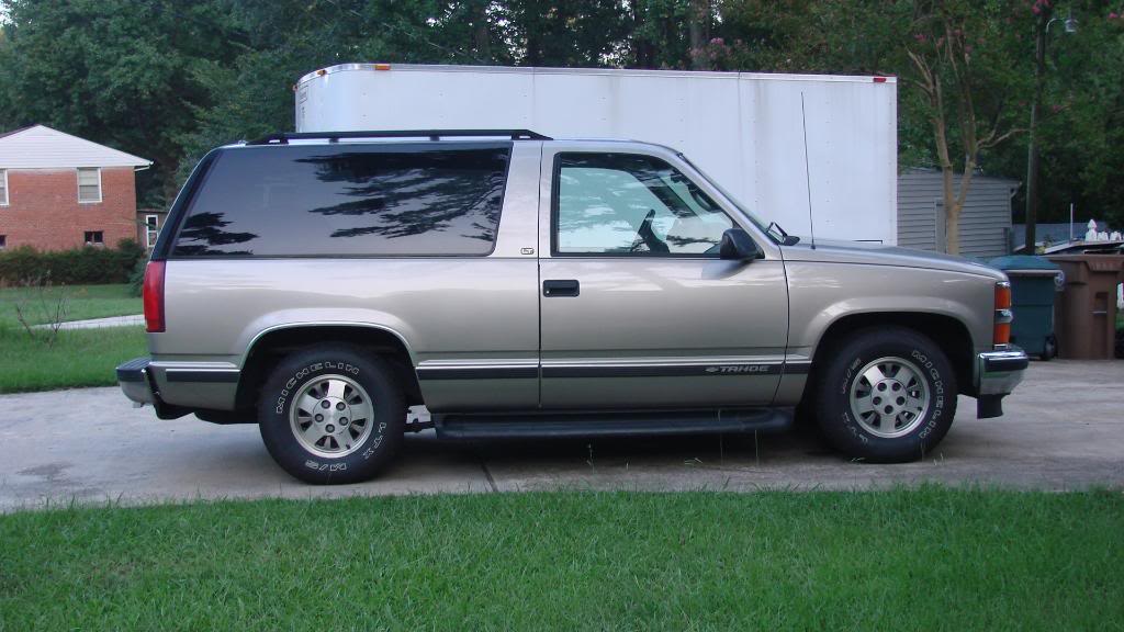

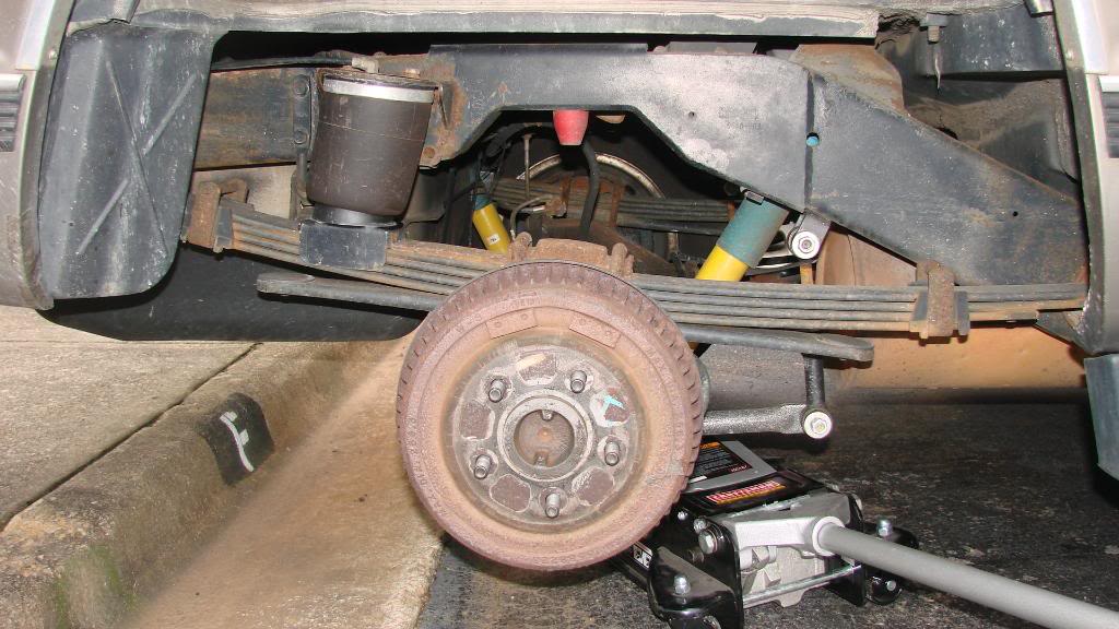

My truck is lowered, nothing big. I have Hotchkis coils up front with a pretty thick isolator. Out back I have a flip kit with 2" lift hanger and helper bags. I'm getting ready to put my spindles on. I like the look of it as it sits with 80+lbs in the bags but, it drives like poop. It drives a lot better without air in them. Putting the spindles on will level the front with the back without air.
What flip kit are you looking at?
Aired up with about 80lbs
Aired out
Helper bags and notch

Mini tub is removing factory wheel tubs and installing ones that will accept larger wheels/tires. Basically installing bigger inner fenders to clear bigger wheels/tires.
