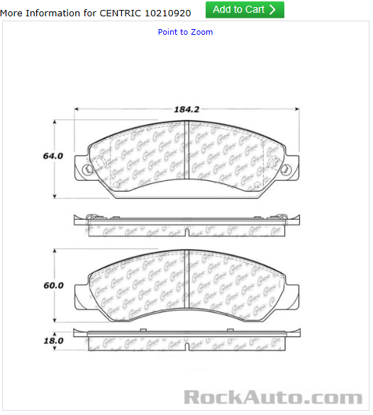

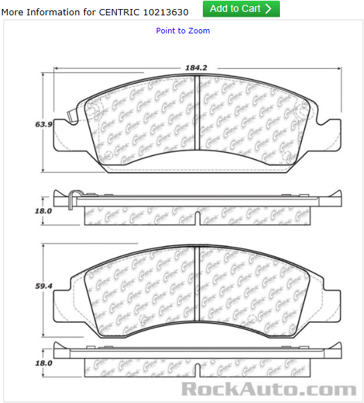

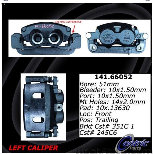

Rockauto has the 1363 with Front; Cal Bracket Cast # 351C/352C &
Rockuato has the 1092 with Front; Cal Bracket Cast # 285C/286C
JF3 11874 P BRK M BRAKE VAC POWER, 17" DISC/DRUM, W/ABS, 7,000 LBS
JF7 11878 P BRK M BRAKE VAC POWER, 17" DISC/DRUM, W/ABS, 6,400 LBS
https://www.rockauto.com/en/moreinfo.php?pk=2043046&cc=1432418&jsn=10701
(Centric 14166052) Shows the Casting difference (for 351C)
Here on the pad, you can see how it mounts is different.
1092 pad
1363 pad
