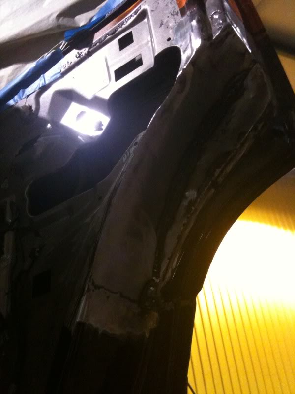

Thanks trick26 that first ones is pretty clean. How much into the door did you get with a 28.

I believe right above the latch I have some pics I'll post for u when I get home I'm on my phone now

trick. first off, sick ass ******* ride!!!!!!!.second. wht was done to thr dif/ shorten? how much? thanks.
Thanks thanks, the rear end ? if thats what you are talking about it was shortend something like 2.5" 2.3/4" on each side.
