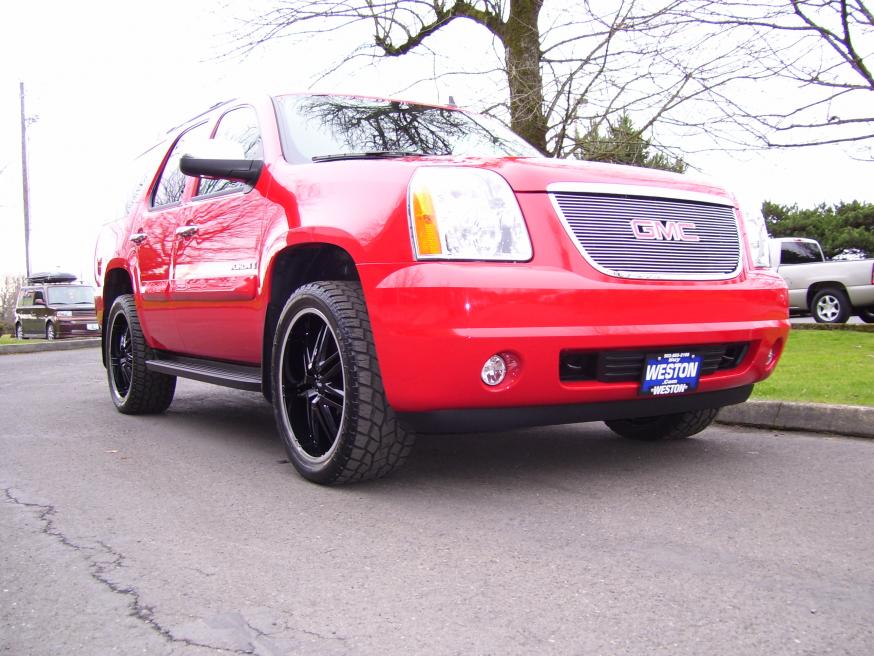

What's up y'all? I have a '09 Yukon 4WD w/ a 2.5" front leveling kit & 1.5" rear coil spacer.
Wanting to run a 33" AT on a set of either 22x9 or 9.5.
The best tire I've found in a 33" r22 w/ a decent AT tread pattern are the Nitto TG's, but I can't decide if I should run a 285/50/22 or a 305/45/22. I'm familiar with tire sizes and the technical jargon, but this is my first Yukon, & I'm wanting to know if anyone out there is currently running a 285/50/r22 tire & what it might look like, or any recommendations you may have before making a purchase. It looks like I'd need to do some fender well trimming regardless. Anyone running tires like these having any rubbing issues??
I'd greatly appreciate any advice on the matter.
Your rig looks great man. What leveling kit did you go with?
red08yukon
Nov 14, 2009
1st of all nice lookin Yukon. Looks very similar to mine. Victory red was hard to get huh! I am running 305-45-22 Toyo A/T's with no problem at all. All stock suspension. So with a leveling kit you would have no problems. I would think you could go up to a 33 without much difficulty. Not sure the exact size differance but pretty sure the 33 is a little bigger.
