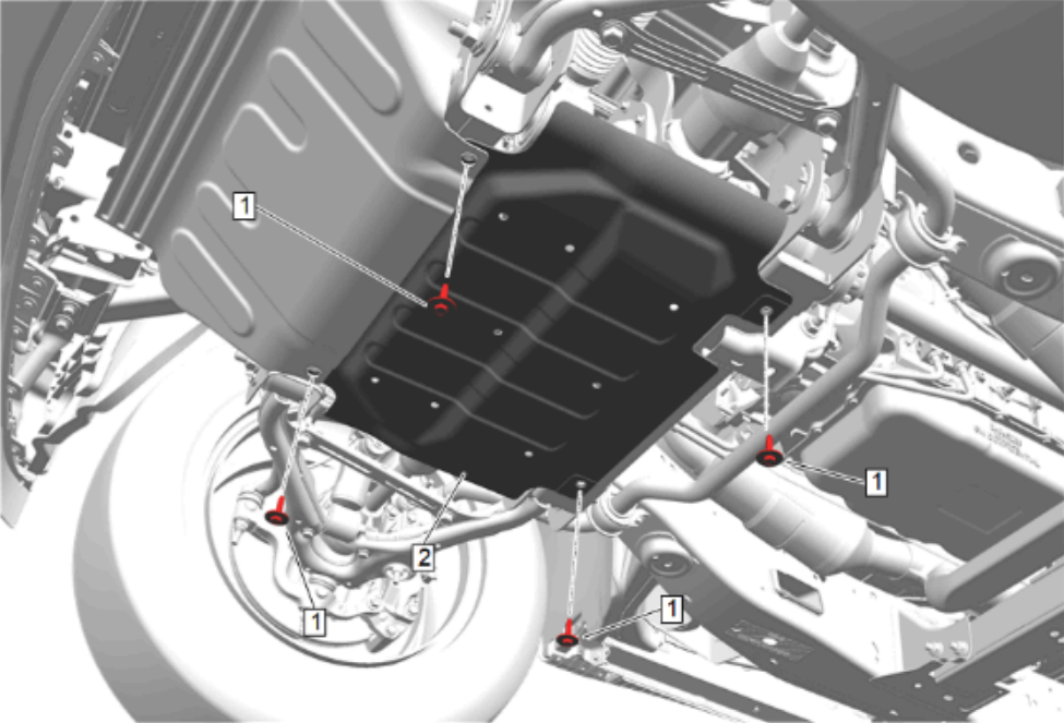

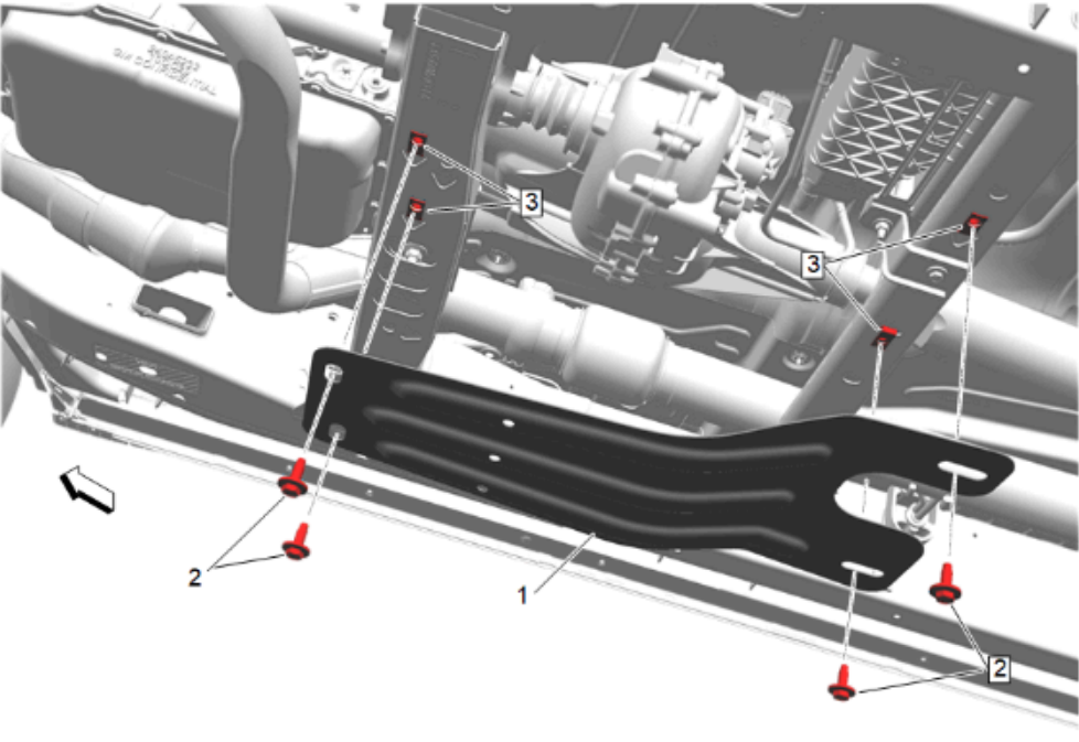

Anybody looked at trying to add the GM "underbody skid shield package" on their 2021+ suv from the accessories website?
cmatt
Apr 29, 2009
637
702
Part No.: 84962765. Searching that part number appears to indicate it's for the ZR2 trim pickups https://www.gmperformancemotor.com/...fvzUyAbqN6IpI85RU8VHbmLU_4Cbe63wUYu_phPdOrGWl.
Looking at the instructions, I'm curious if the mounting locations match up on the suvs.

Plate #2 was already on my 2021 High Country Suburban. My Suburban has a large plastic "belly pan" type of front plate #2. I added a transfer case plate. That one you are showing might fit or it could probably be made to fit easily.
Blueinterceptor
Jan 20, 2016
1,159
686
I put the shields on my tahoes and suburbans installed by the dealership
I’ve put the two piece kits on premiers and high country’s
I think the shield numbered 2 comes on them now
The front shield from the zr2 ( it’s really a 3 shield package) is unsightly but the other two fit fine.
