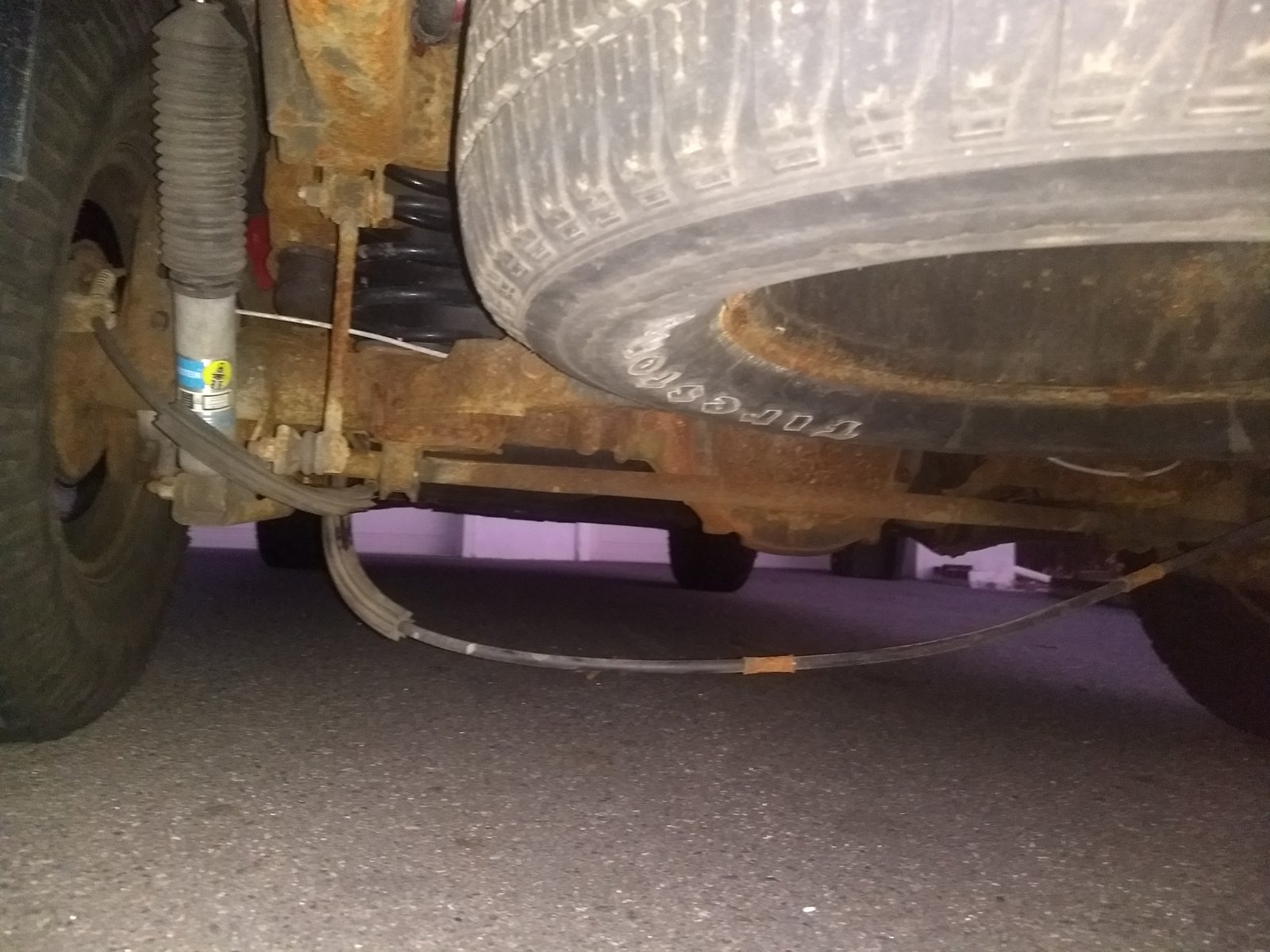

After this winter I will have to do some work on the undercarriage. IN the last year few years it started to get out of hand. Going to grab a wire brush to the frame and the use some rust inhibitor like naval jelly and then finish it off with something like eastwood encapsulator.
Naval jelly is not an inhibitor, it's an acidic converter. Putting it on your frame and leaving it could cause more harm than good. Don't the instructions say to remove it after it has converted the rust?
ladorn45
Oct 29, 2014
311
102
Yea i was not going to leave it on. I would apply it let it soak for how ever long it needs to in order to convert the rust and then rinse it off. After that i would add the eastwood.
33,185
51,399
That's the typical NJ undercarriage right there.
C
CountryBoy19
Jun 8, 2018
265
150
Southern Indiana
Ah, ok, that makes sense...
A little too much effort for my liking but if you have the time go for it!!! IIRC, you can get the same active ingredient as naval jelly in a liquid form (forget what it's called) that will spray on, but the you have to clean really good because it gets down in crevices etc and that gets really hard to get it all out before it starts doing bad things...
