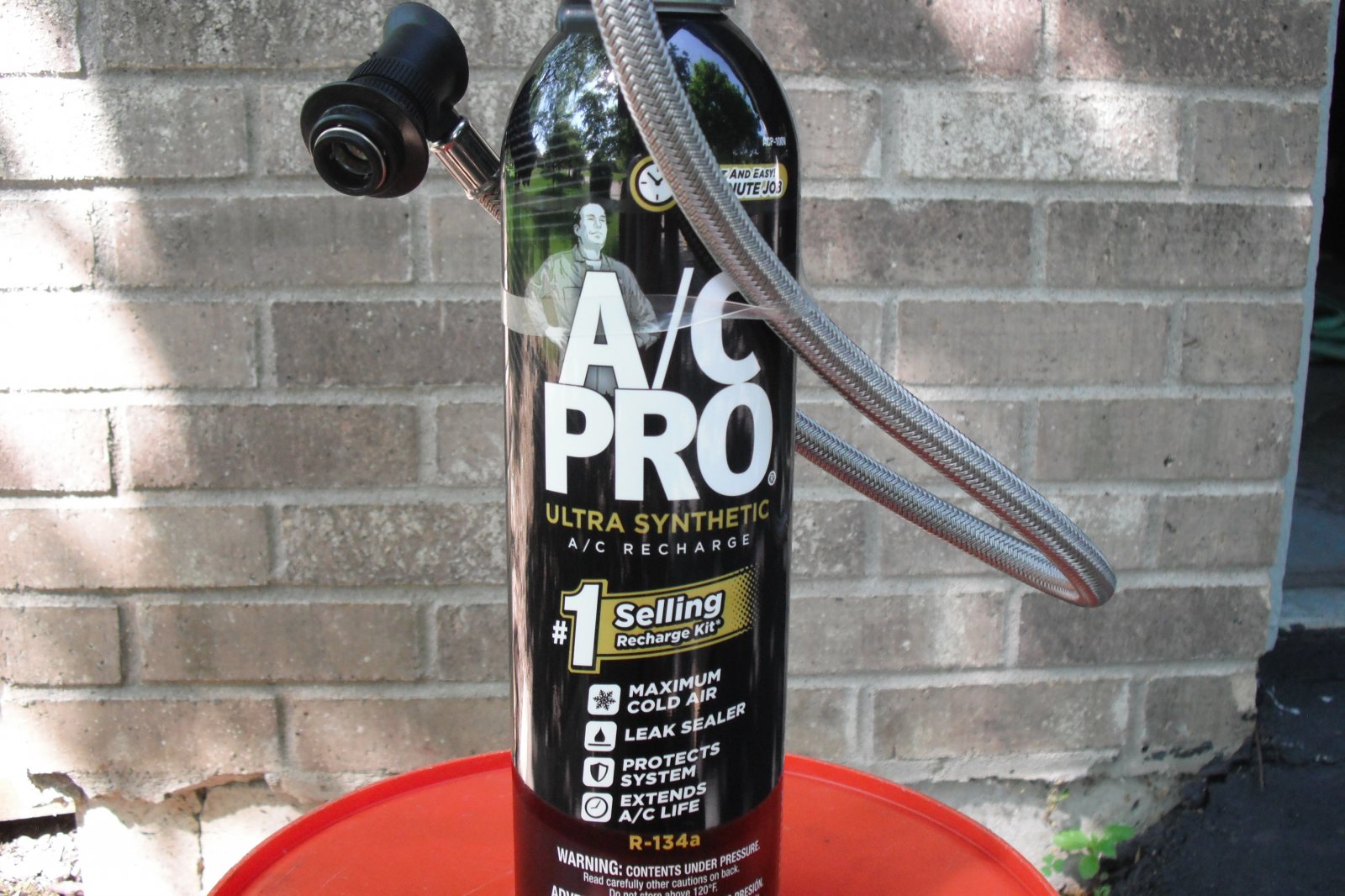

New Pressure Switch still cycling. 20 oz can of A/C PRO with the pressure gauge on the can still warm air. Compressor bad possibly?

The Can of A/C PRO Gauge goes down to 25-30 while the compressor is engaged. 60 when not engaged. These are Low line pressure readings. I did the recharge yesterday and the outside temp was about 90 with low humidity. We are experiencing July heat in early June that will last another week. The small 'self-sealing' cans of 134a Do Not work! A/C PRO is the only brand of refrigerant I could get to work. The compressor only engages for 5-8 seconds then shuts off for about 20-25 seconds. I replaced the Pressure Switch with a new one Saturday.

That scenario you just described tells me the system is low and/or your compressor is taking a crap if you cannot get it to pull the refrigerant in.
