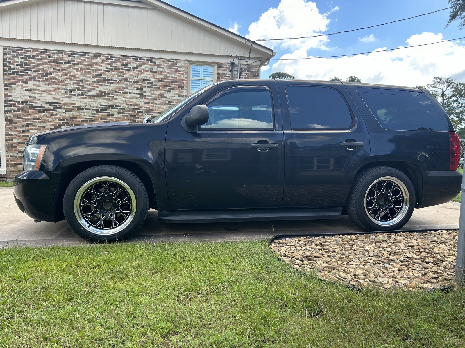

20 x 10 +10 on 275/45 tires
I'm lowered roughly 4.5f and 6.5r and have no rubbing that I have noticed. Been on this drop for about 7/8 years now.
