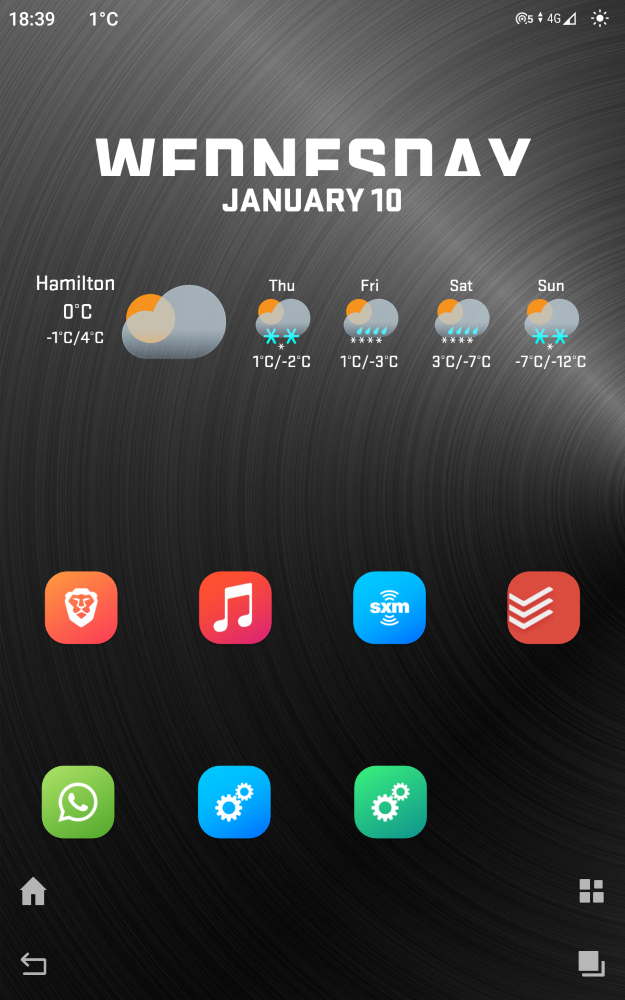

Actually first thing I did was install Nova Prime. The stock screen is so nasty; switched to the modern one and deleted all the shortcuts and widgets off the home screen for those odd times nova doesn't get displayed. When I ran android phones I always had it setup nice n crispy the way I like. After some time I found others did the same and I love it. Even made some widgets using the font GM uses on their webpage. I'll get some screenshots uploaded tonight if I can. It's running perfect for me the last few weeks.

This is the way I have set it up. I resized them so it's not overwhelming here; I made some custom icons based on the Nova icon set. I have a single screen and the dock row at the bottom has 3 pages like a carousel so the difference can be seen between the first 3 images. I like those apps to be hidden and out of the way since they are for streaming video or settings on the other page. The blue gears is the GT6 settings and green gears is android settings. I used KWGT to make the two custom widgets just the way I like. They are configured so a tap of the weather widget opens a preferred weather app and the date launches my calendar. I also hid the icon labels because it's just more clutter and the whole point of icons is kind of defeated.
