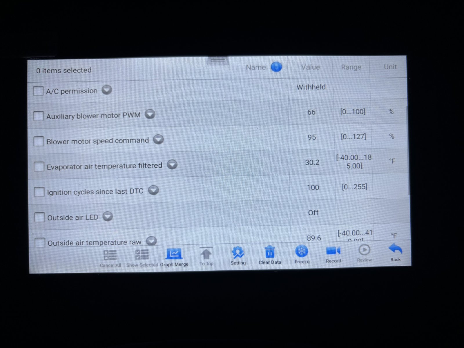

Yup i feel pretty ignorant at this point. Scanner and all i missed checking the evap temp. I thought since no error codes from actuators i was good. Also calibrated them. Evap box at 28-30F. Anyone know which blend door to check first?
