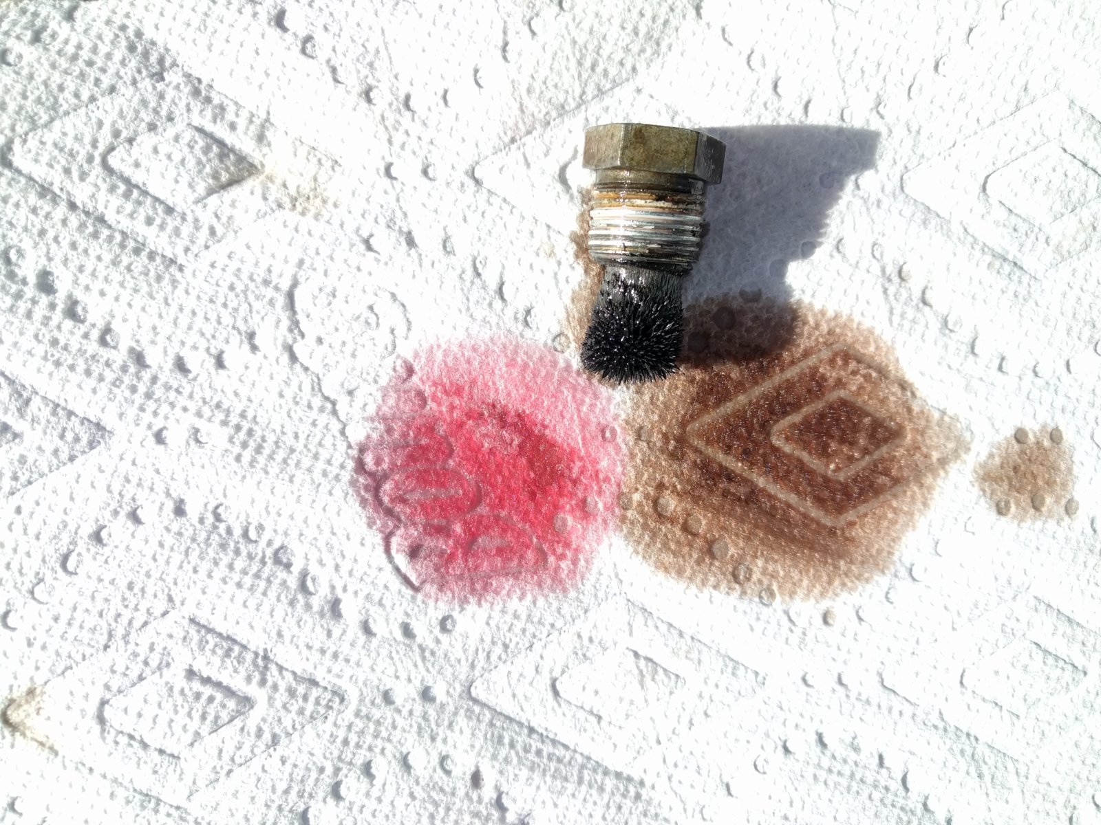

Serviced the Hoe on the weekend, transfer case flush/fill and tranny pan drop/flush. 75,000 miles, assume it's the first time. Figured someone might be interested to see the condition of the magnet shavings at 75K, imho it was needed based on the colour of the ATF. DEXRON VI btw, both tranny 6L80 and transfer case (NQH). Has the Z82/HD package, plus oil cooler/KNP.
Pan removal was aided with the use of a long clamp to pull the exhaust down that 1" to allow the pan to *just* clear the cross-pipe. Pan+magnet cleaned, new filter/gasket. Reinstall, then pushed total of 14qts through using a 3/8" pipe stuffed in the cooler exit pipe at the top of the radiator. Hold it in - it's under a fair bit of pressure and *will* pop out.... :-(
Good for another 50K !
Transfer case drain plug:-
Old ATF + dirty magnet:-

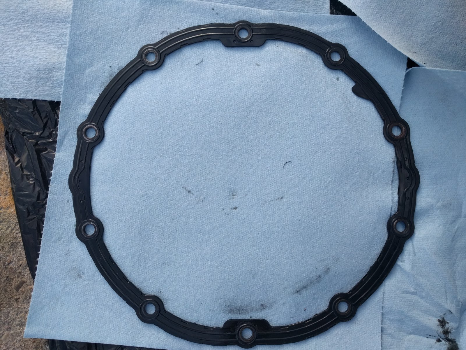

Synthetic gear oil eats normal RTV. Permatex makes a synthetic gear oil sealant but alot of people reuse the factory gasket dry without issue. I just did a drain and fill but chose leave my rear cover sealed and pump the fluid out of the fill hole.
20,307
27,876
RTF? 10 bolt axles for 1500s. The rear takes 2.15 quarts or 2 quarts and 5 ounces. The front takes 80W-90 regular, not synthetic @ 1.51 quarts.
I've opened my rear differential twice this year and put the original gasket back on without sealant of any kind, just dried it with a rag. No leaks.
x2
I used the permatex black RTV smeared on a replacement fiber gasket with no issues. Just let the permatex tack up a little before putting it on.

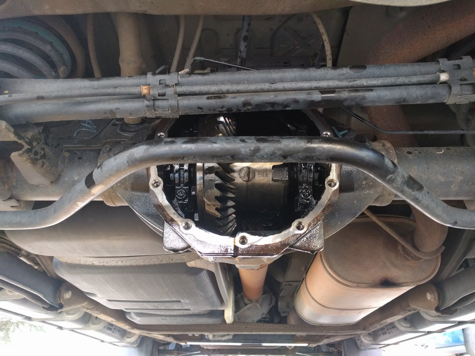

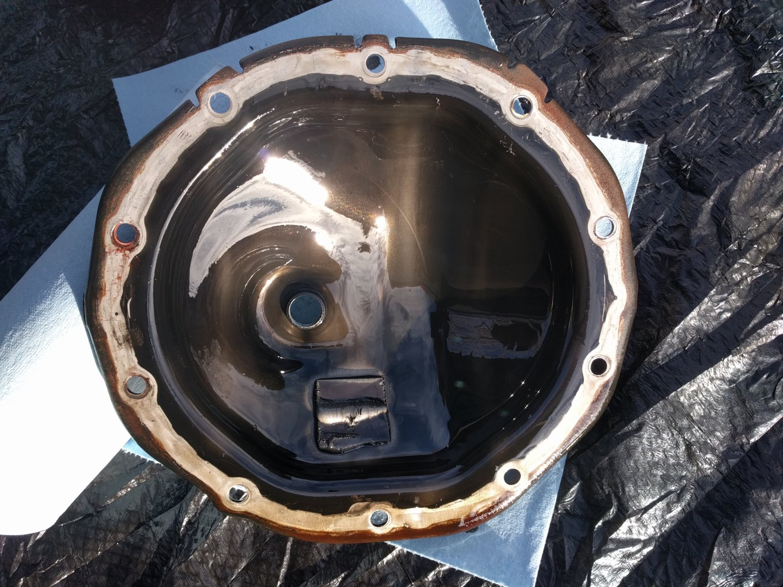

So did the front and rear differentials at 75K. A little over 4qts total Mobil-1 75W-90 Synthetic, 5+pts rear, and 3pts front. Rear diff has the fill plug in the cover rather than in the main housing by the driveshaft. 10 bolt, so 8.6", right? Mine took more than the 2.1qts/4.2pts listed - around 2.5qts or so... Reused the gasket which was in good condition.
Fill plugs had typical level of metal fillings. Not concerned, but glad I didnt wait until 100K to service them.
