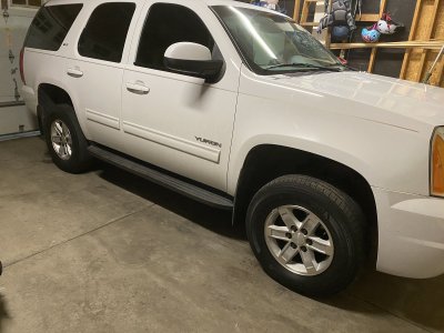

I just put a 2.25f and 1.5r ready lift leveling kit on my 2010 Yukon. I’m looking to buy new tires and would like the Fuel Vectors 17x9 -12mm offset with Bf Goodrich 285/70/17 tires. I expect some needed trimming, has anyone done something similar?
Will these tires fit?

I have a CCM 2.5 in front and 2" spacer in the rear. I'm running 285/70/17 BFG at's on 17x8.5" rims same offset.
I have had to do some trimming for sure. I cut off the corner fender that was inside the well, and lots of plastic trim. I'm looking to raise my washer fluid tank now too.

Aftermarket Fuels just like yours.
I may have a different idea as to what I call adequate room though.
My tires barely touched anything siting still in the driveway. I didnt like how backing out of my driveway I would hear/feel my tires rub when the suspension dipped just a bit.
My trimming allows for moderate articulation say like when going over a bump with my wheel turned.
