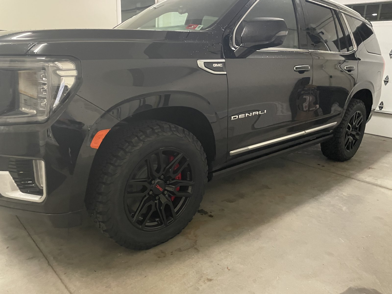

I just put 305/45/22 tires on the wifes 100% stock ‘22 tahoe and they fit just fine with no rubbing anywhere.
