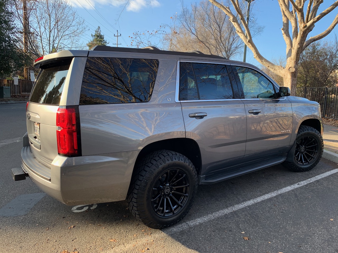

On Black Rhino Rotorua wheels with +12 offset. No rubbing, stock suspension. 2018 LT with tow package. I did have to take off front after market mud flaps off as I got a bit of rub at full lockout and flex.

Looks good, I was wondering about the 275 and rubbing, so I just went with 265/65R18. So far I'm loving these tires! :thumbsup:

Those bigger side lugs on the tire is what was hitting the mudflaps. Does look good though.
