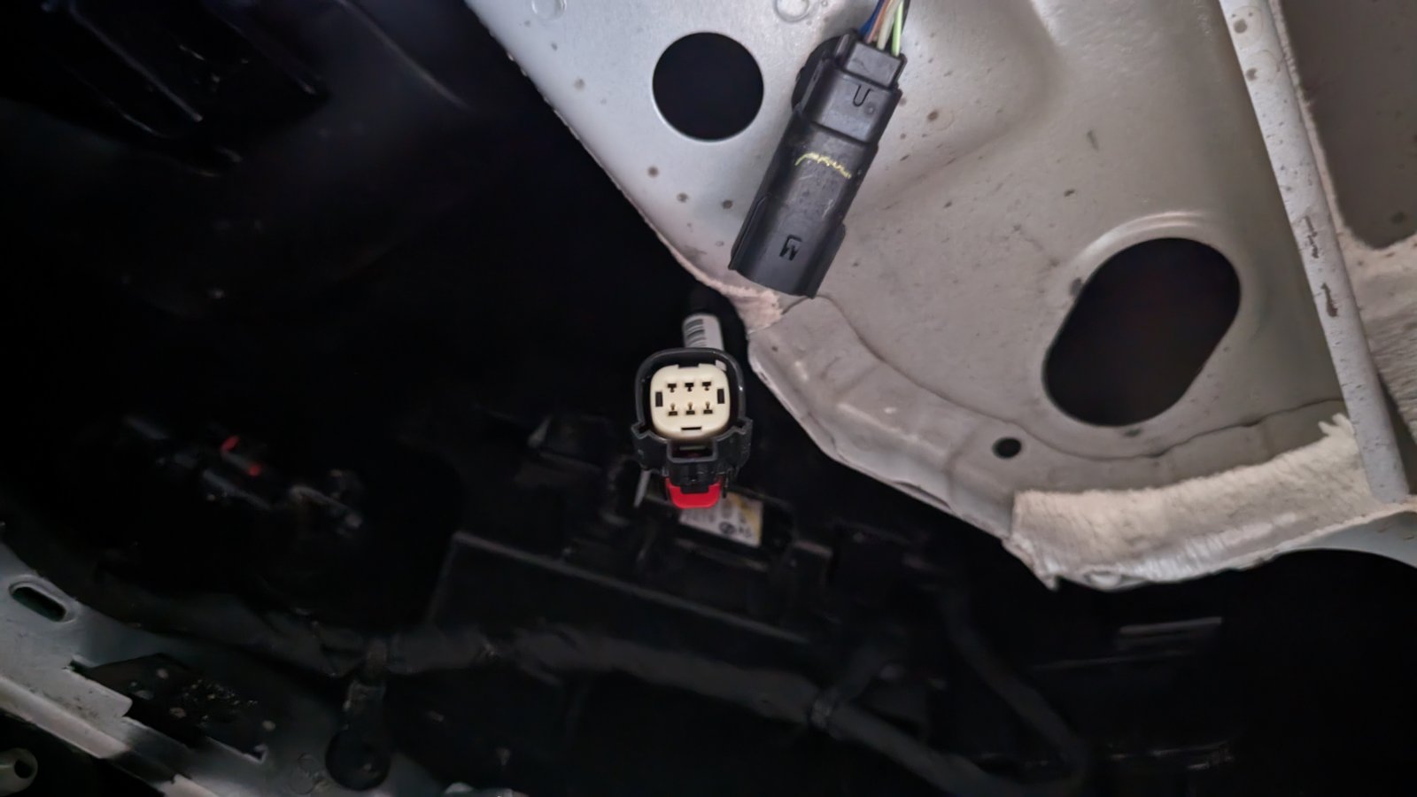

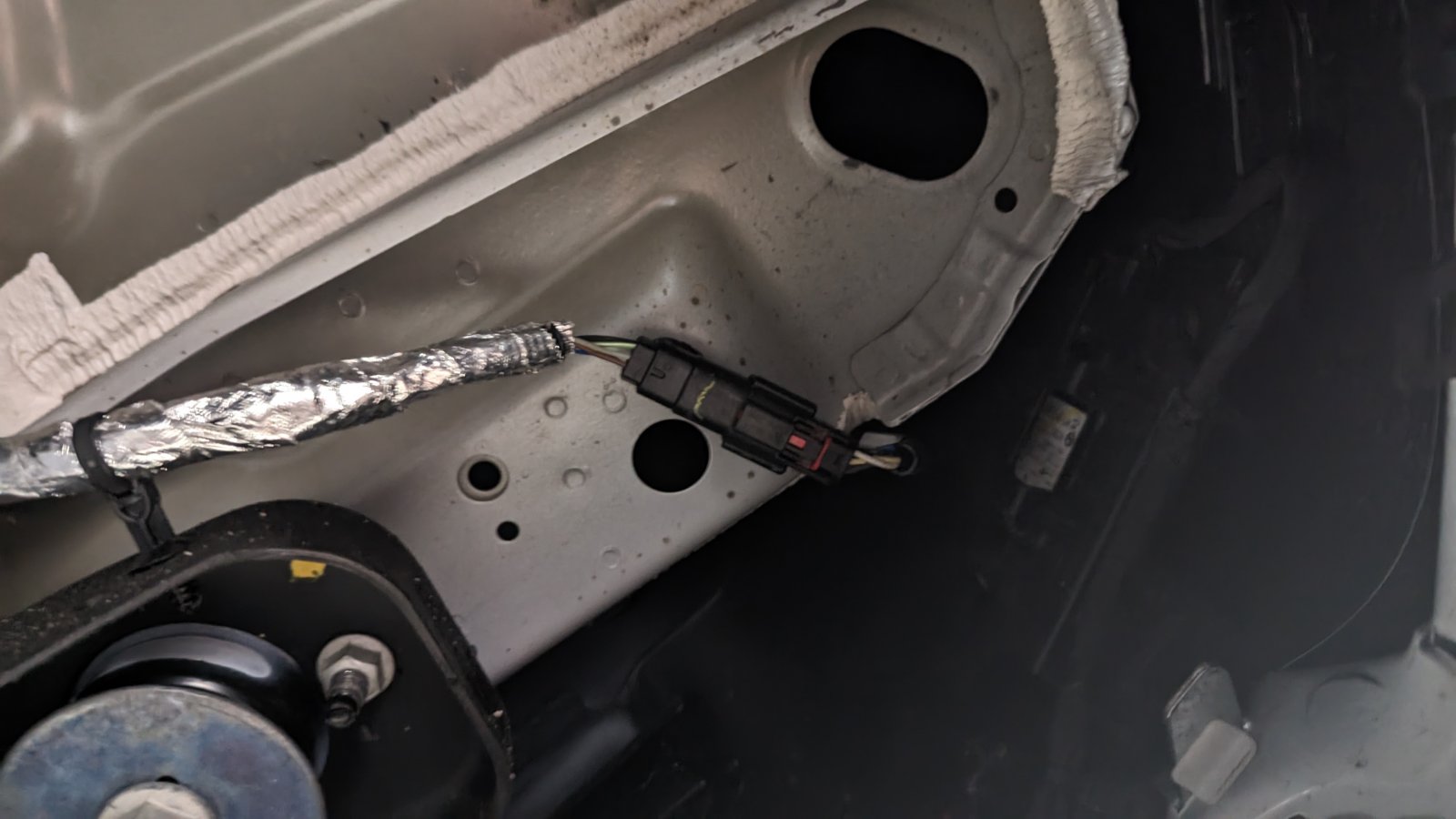

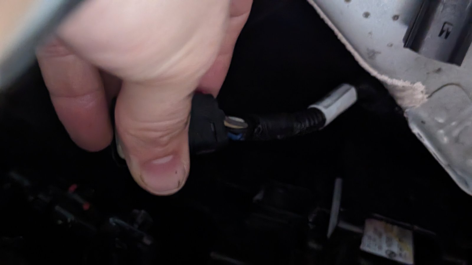

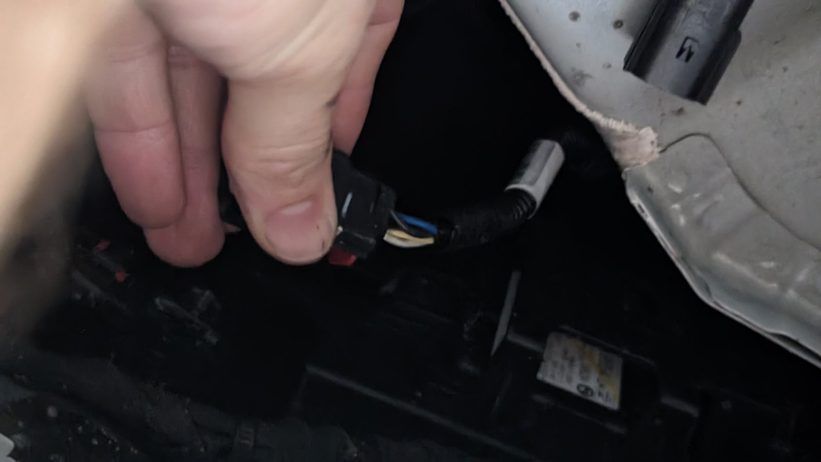

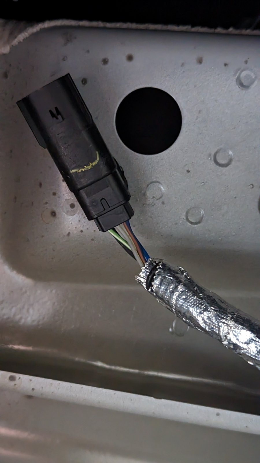

The tail light harnesses dump out under the rear bumper where they connect to another harness. Not sure if it's the chassis harness or the body harness but either way it's a factory connector. I'm working with a reputable company that is making plug and play jumper harnesses for each side. These jumpers have the resistors built in so in theory you can use any LED bulbs. I've seen some people tap resistors in behind the tail lights but resistors get hot and could melt the tail light housing. And I do believe lasfit has a bulb with a builtin resistor for one of the locations but I'm pretty sure they tell you if it runs long enough it will overheat and hyperflash. This harness to me would be a more robust solution and resolve the issue for all the bulbs whereas the Lasfit bulb only works for one of the three bulbs. Hopefully I can report success this weekend and let everyone know where they can buy these harnesses. On that note do any of you have a 23 model. It appears gm switch from 6 pin to 8 pin on the 23 models. It would be great if someone could look under there rear bumper of a 23 disconnect the tail light harness and take a picture to verify the number of pins and maybe the wire colors.
