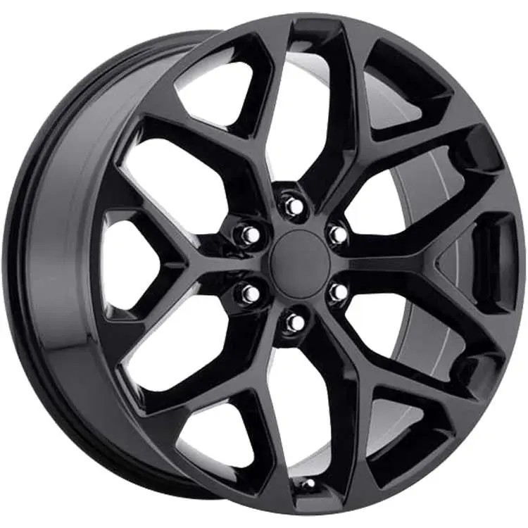

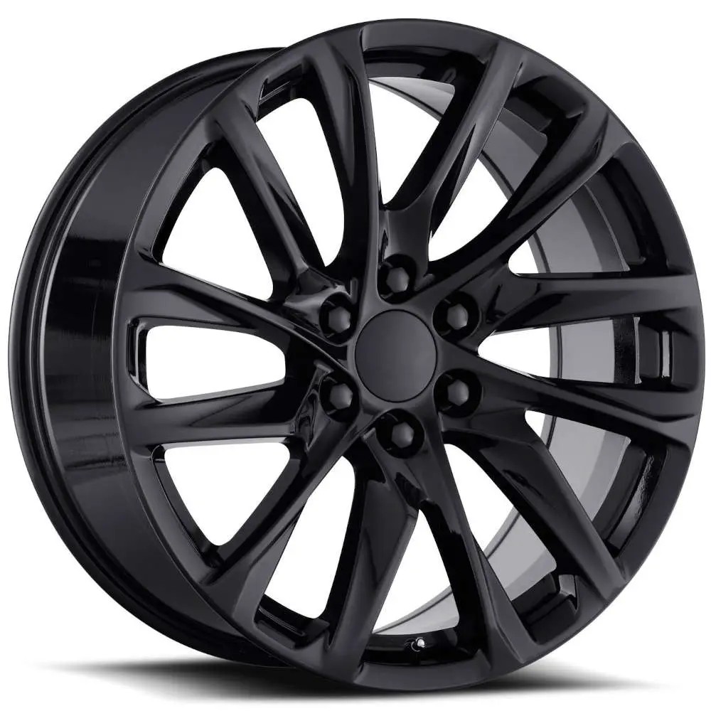

Bought a 2025 Tahoe RST with 22" wheels. Looking to upgrade to 24" Wheels. The factory 24's come in a 9.5" width, the aftermarket ones come in 10". What backspacing and offset should I be looking for? The ones im looking at are 24x10 with 6.44 backspacing and +24 offset. Pic of truck and pic of the wheels im looking at attached.

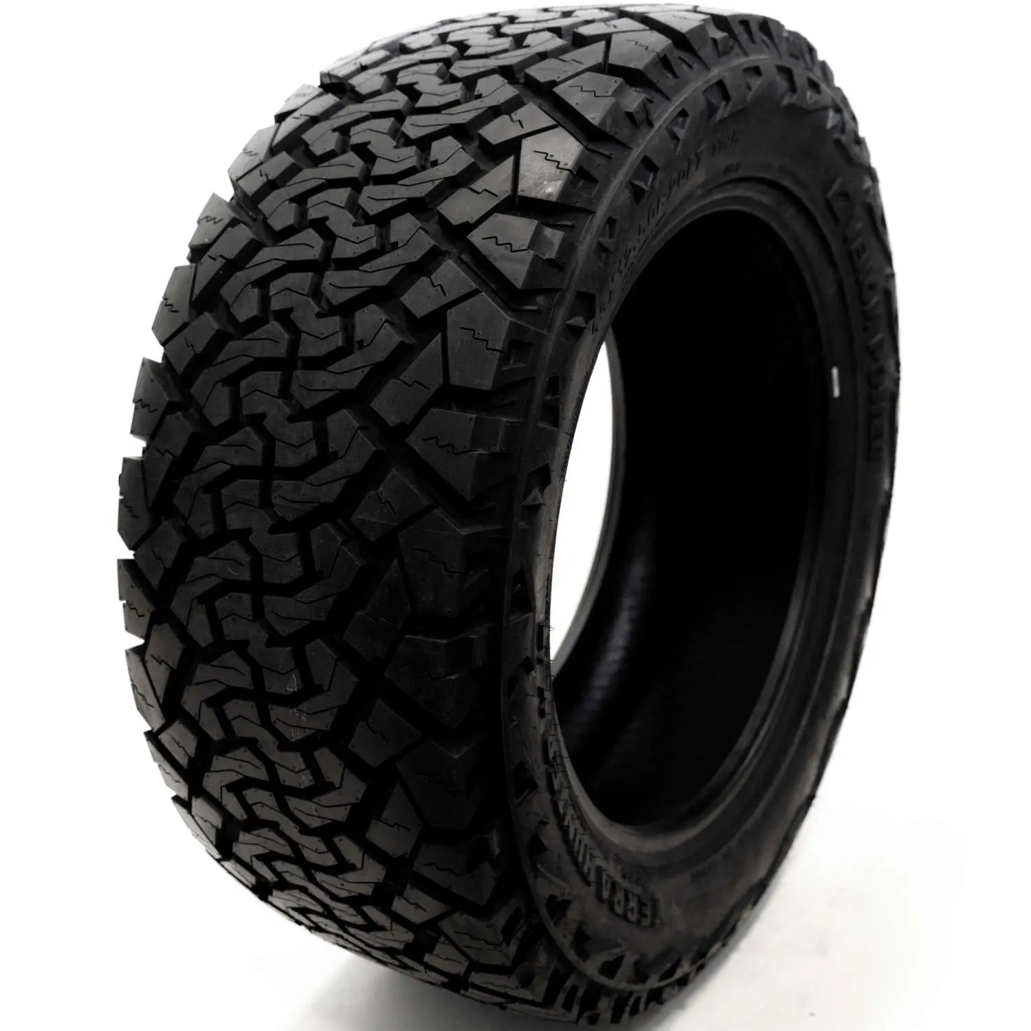

I can post the specs but without pictures to go along with it I dont think it would really help.
Wheels:
Brand: Factory Reproductions
Model: FR98
Model Other: Escalade 12 Spoke Replica Wheels
Part Number: 98410316502
Wheel Finish: Gloss Black
Backspacing: 6.72
Bolt Pattern: 6x5.5
Offset: 31mm
Wheel Diameter: 24
Wheel Width: 10
Hub Bore: 78.10
Load Rating: 2200
Wheel Exposed Lugs: Yes
Wheel Material: Alloy
Wheel Structure: One Piece
Wheel Spoke Number: 6
Tires:
Brand: Venom Power
Model: Terra Hunter X/T
Inventory Number: CVPXT04
Aspect Ratio: 40
Inflated Diameter: 32.98
Inflated Width: 11.22
Load Index: 112
Section Width: 285
Service Description: 112H
Sidewall: Black Side Wall
Speed Index: H
Temperature: B
Tire Rim Diameter: 24
Tire Type: Hybrid AT/MT
Tire Type2: All Terrain
Traction: A
Tread Wear: 500
UTQG: 500AB
Weight: 44.16 lbs

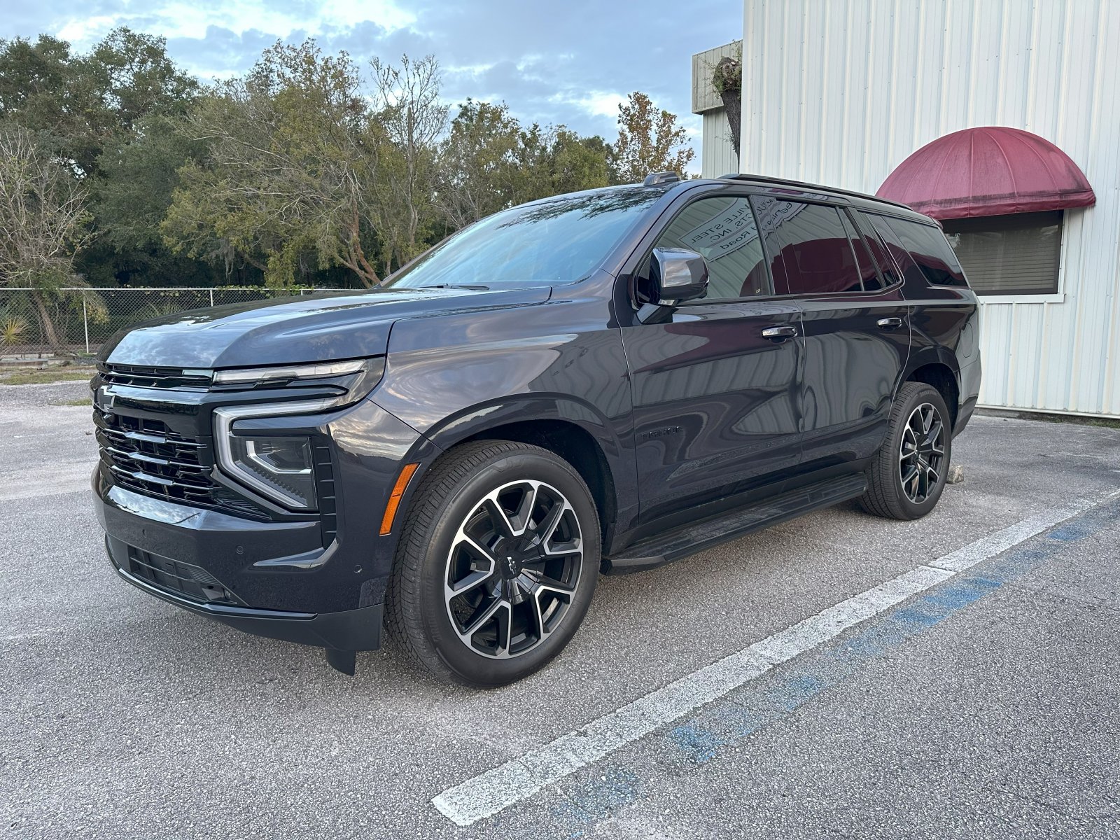

@KMeloney @Dag300c I finally got the wheels and tires installed a couple weeks ago but this was the first time ive been back on the forum.View attachment 447314View attachment 447315View attachment 447316View attachment 447317
That drop looks great along with those rims.
The color looks to be dark ash, I can't decide between dark ash or black. I like dark gray colored vehicles, but it also looks like dark ash has a dark purple color based on the way the sun hits the paint.
It is dark ash metallic. It does sometimes have a purple/blue hue depending on lighting but it does look black at night. It is a really nice color and IMO the metallic helps hide some dirt and microscratches compared to the standard black.

It does have the adaptive air suspension. I used lowering links from edgymods.com. They are extremely easy to install!
I have not noticed any rubbing. I went with the same size tires that come on the 24" wheels from the factory. But since the wheels are slightly wider the tires fit a little different than the would on narrower wheels. I wouldnt worry about the slight rubbing you get at full lock. Like you said, it doesnt happen all the time and its never going to be at highway speeds when it does occur.....if it is, you most likely have a bigger problem on your hand!

So, the end fittings are the same size but the length of the rods is adjustable. All these do is adjust where the air ride sensor arm is in relation to the control arm. So basically it is tricking the truck into thinking it is at normal height even though it is lower.
The pic shows it in entry/exit setting. Normal ride height is a little lower than what entry/exit mode is stock, I think. I took measurements before lowering it but still havent taken the measurements after. Ill try to remember to take the measurements when I get home this evening.
I can tell you that if you set the rod lengths to approximately what he has listed (165mm and 108mm), most times you will have to trick the truck into entry/exit mode. If you pull up, stop and put it in park, it will begin lowering but most of the time before it gets to the correct height it flashes a message saying object detected under the vehicle and will begin raising back up to normal setting. The only trick I have found to get it into entry/exit mode is to select entry/exit mode on the switch about 10 seconds before getting to the final parking spot and pulling in very slowly. You definitely do not want to drive it at the entry/exit mode setting because you will be riding on bumpstops and its very bouncy.

I took measurements again last night. Its right at 1.5" of drop if you set the links to what are on the instructions. Of course I went from stock wheels and tires to larger wheels and tires so depending on your setup it could be a bigger difference. I rounded everything to the nearest .25" so they could be slightly different and I measured at the center of the wheel from the floor to the bottom of the wheel arch. Theres about 4" of total travel from the entry/exit setting to the highest 4L setting.
Stock Height-Normal Setting. Lowering Links-Normal Setting
Front Right-36.75" Front Right-35.25"
Front Left-37.25" Front Left-35.75"
Rear Right-37.5" Rear Right-36"
Rear Left-37.75" Rear Left-36.25"
Stock Height-Entry/Exit. Lowering Links-Entry/Exit
Front Right-35" Front Right-33.5"
Front Left-35.25" Front Left-33.75"
Rear Right-36.25" Rear Right-34.75"
Rear Left-36.5" Rear Left-35"

I did not. The diameter of the stock tires vs the ones I used on the 24's is only .6% difference. Its so little of a difference that its not really needed.
