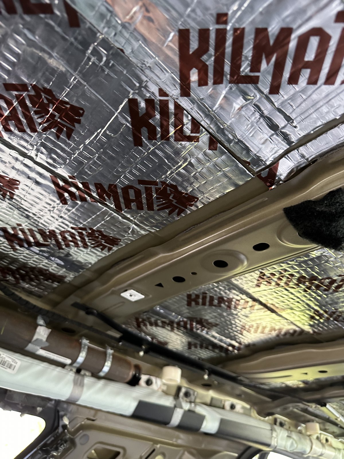

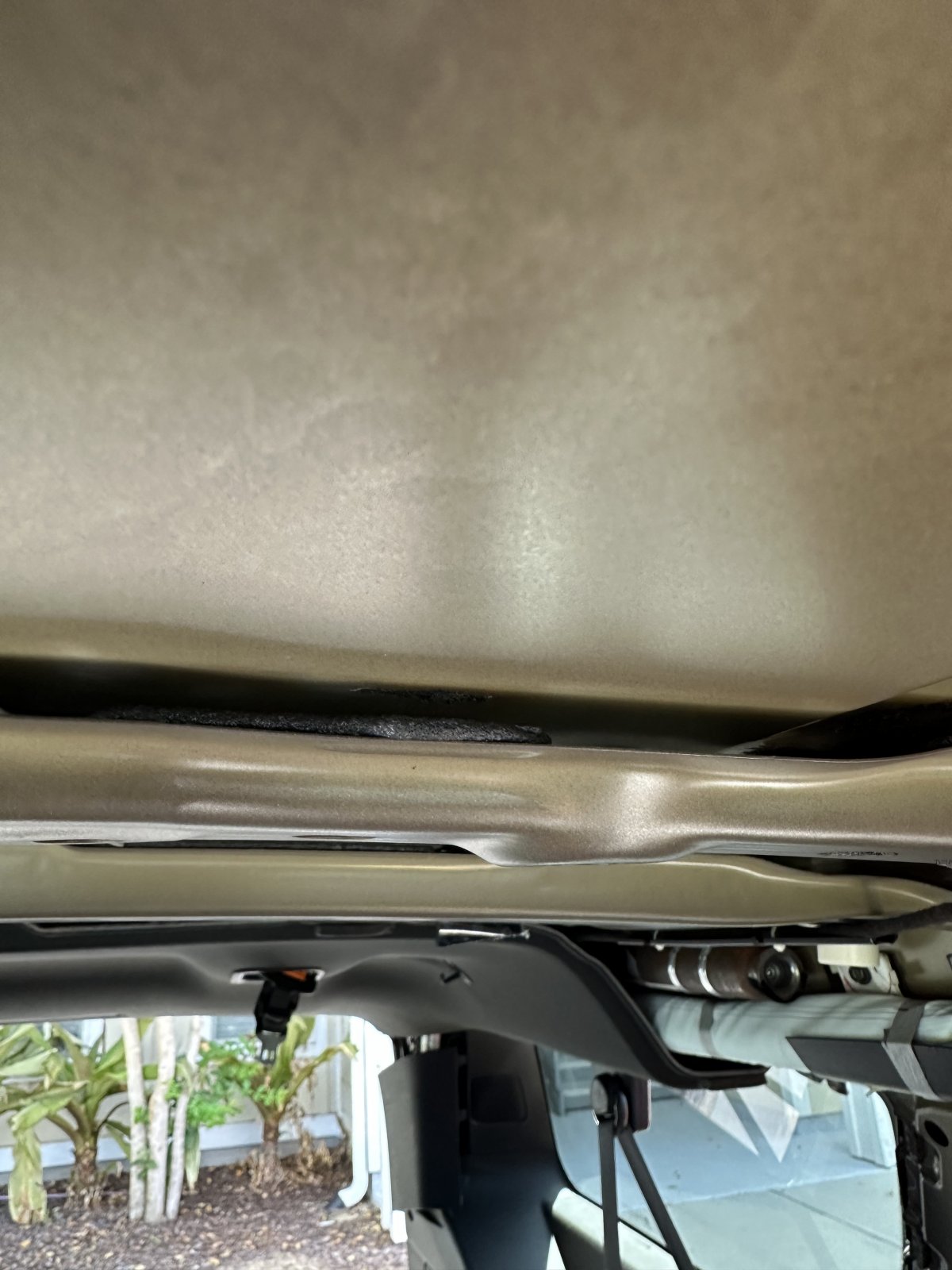

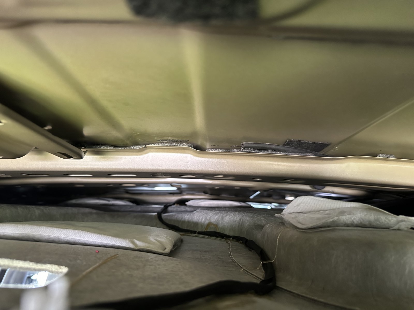

my 21 suburban was very loud, very boomy, to the point my apple watch was yelling at me saying its over 90 db.
my 2019 wasn't, in fact it was very very quiet.
Turns out the roof bows were no longer attached, causing the roof to flex on every little road imperfection.
reattached them with the special 3m flexible automotive foam, then sound deaden the entire roof doors and floors, dropped like 10 db, and improve the audio for the radio, I think they just use crapy Thin aluminum in these cars now. and did very little to sound proof it.
Was a lot of work but prob best $100 I ever spent kill mat 80 mil on amazon 36 sq feet
While doing the floors I discounted there's basically nothing between floor boards and engines bay, the prior gen had 5 in foam fired with thick rubber. I swear fkn GM with their bs cost cutting and racking the price up on these cars. Everything is thiner, plastics, metal, rubber. not to mention the plastics also scratch so easily.
After doing all this the noise level is now about the same as my 2019 suburban. Just sucks I had todo so much work to get the noise under control.
