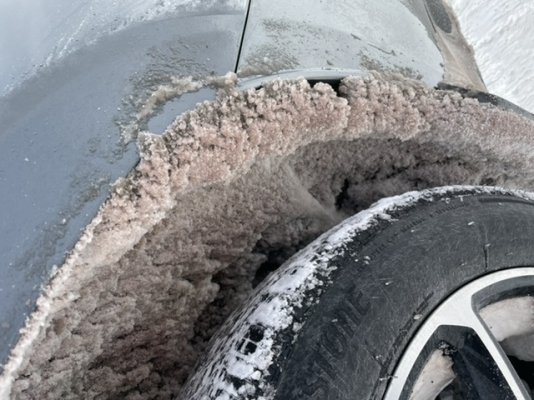

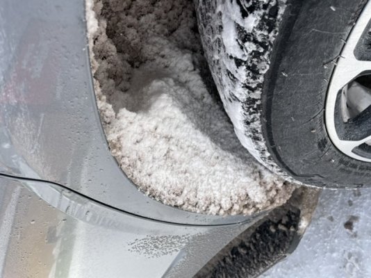

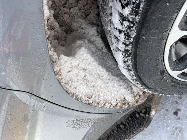

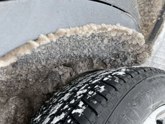

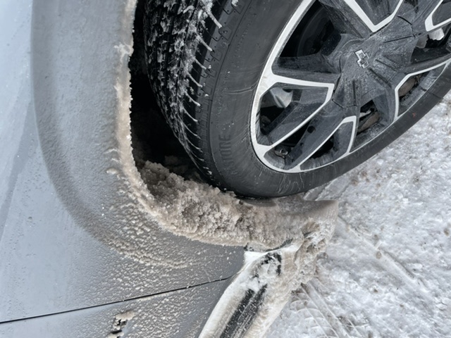

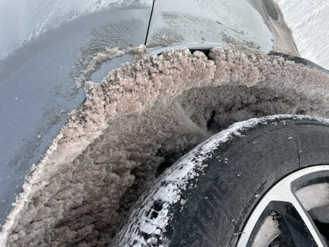

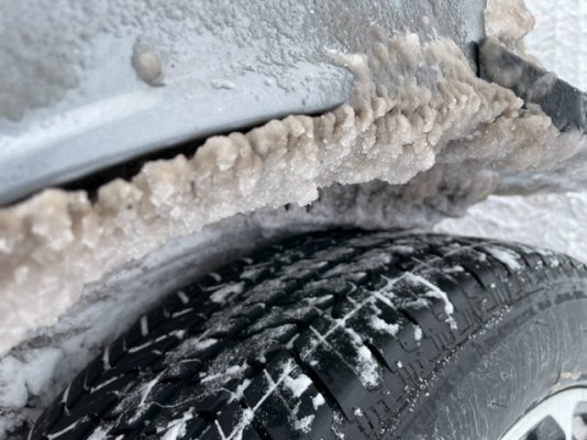

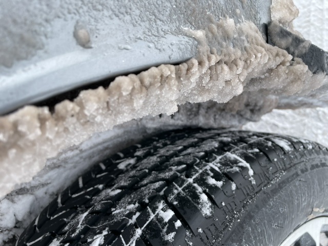

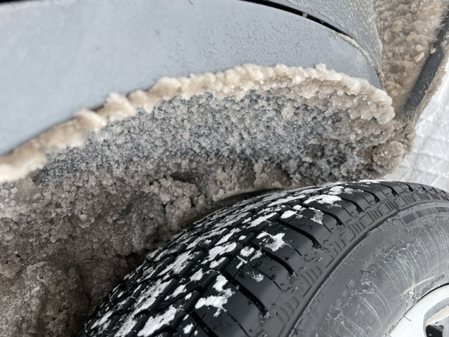

We live in Michigans upper peninsula, about 225 miles north of Green Bay WI. Typically we get 200-300” of snow per year. One thing I’ve noticed on our RST with 22” wheels is the snow build up in the wheel wells is constant, tires start to rub and it needs cleaning out. Most nights it falls off in the garage but it stil needs regular cleaning. Just a few pics to show this, and I’ll add winter tires next season. I love the Tahoe just an fyi.

Wow that’s a lot of build up. We’re down in the thumb and do not get build up like that. We also have had a very mild winter so far tho. Spray some pam lol

It’s probably the tires, my Silverado has the 22’s with Alenza’s and build up sucks on them

Actually, I think it is the felt type liners of the wheel wells. They are used to keep road noise down, but ice and snow adhere to them vs a hard plastic liner that with one good bump would fracture it out...

As @Banks22 suggested, clean the fender liners real well, and then spray them heavily with Pam or Weber Grille Spray.

Pam? Definitely won't last as long as regular silicone spray.

Pam isn't gonna help these new ones, the wheel well liners are felt, not plastic like the old ones...OP mentioned that above. I noticed it too, and I am only at 634 miles. Up side is it is fairly easy to clean out...

I completely agree that the felt liners are a huge factor if not the main factor. Salt and ice really stick nicely to the inside of them.

mud flaps no a decent job of keeping it off the area behind the wheel, but the wheel-wells fill very badly. I am getting a new vehicle soon, and I am gonna try and spray the felt when it is brand new, with a healthy dose of silicone spray see if that helps. I was just in snow and very cold, and there was less that 1/2" between the tire and ice build up, and it does not come off.
