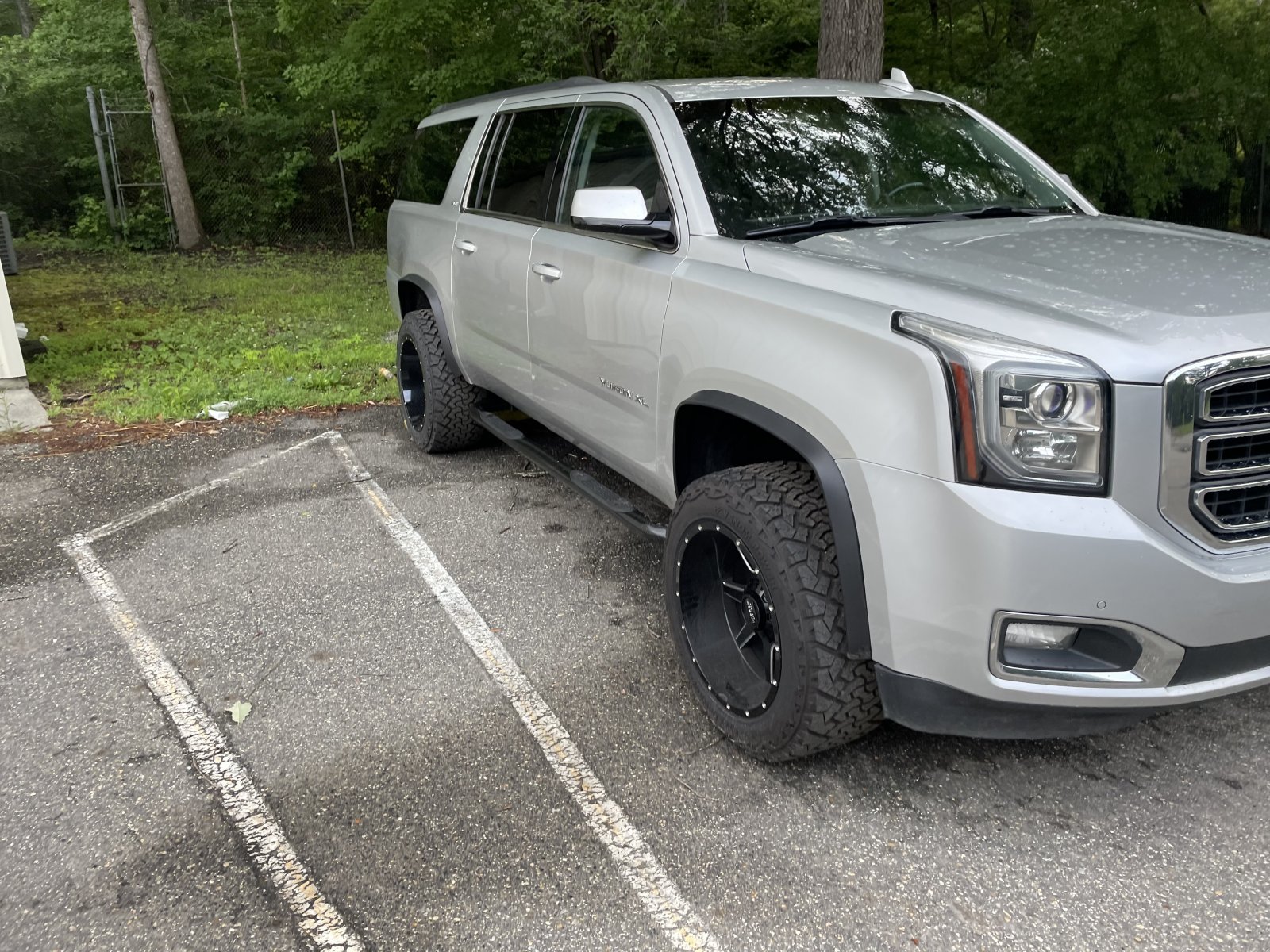

I have a 2017 Yukon XL SLT. I bought it around mid- Jan of this year. I put a new alternator on it within the first month. Today, I leave work, and alarms start going off saying service charging system. The truck starts shutting off all “non essential “ functions and then dies. I got a jump, and barely made it back to work. I mean this thing Cut off power steering, EVERYTHING! Anyone Know whAt the issue could be? Please? I’m already overpaying for this truck and the warranty from Alpha 1 is garbage. They have already denied 2 of my claims. Also, I replaced the alternator within a month of getting it from the dealership. Thanks for your help
