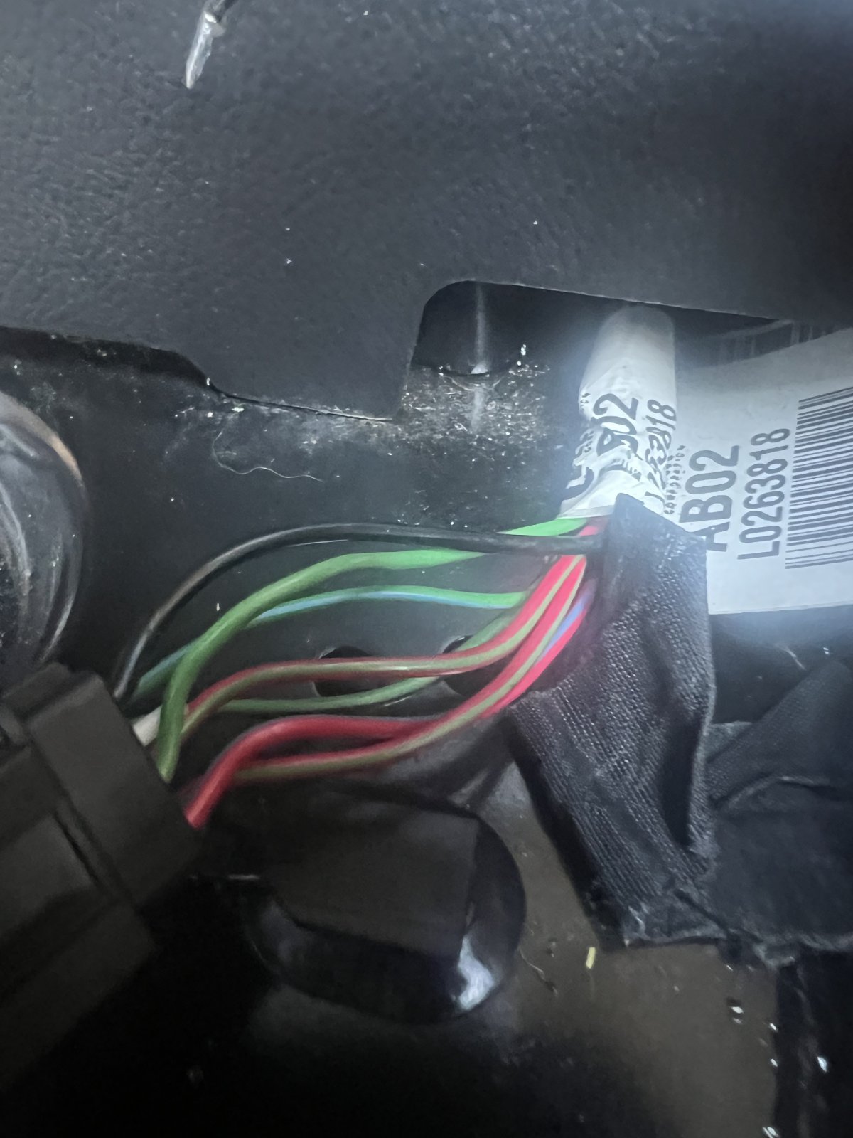

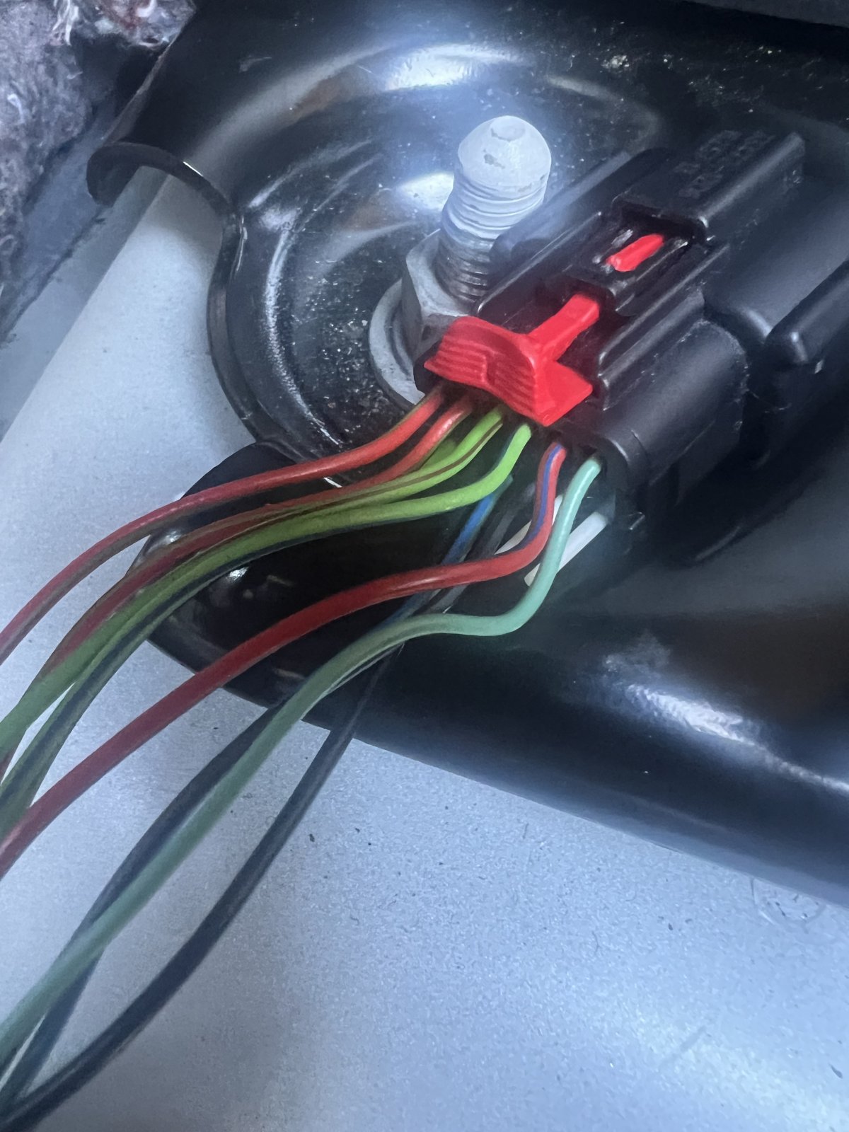

I swapped my bench seat which was power flip and heated for two captain chairs that fold with heat as well.

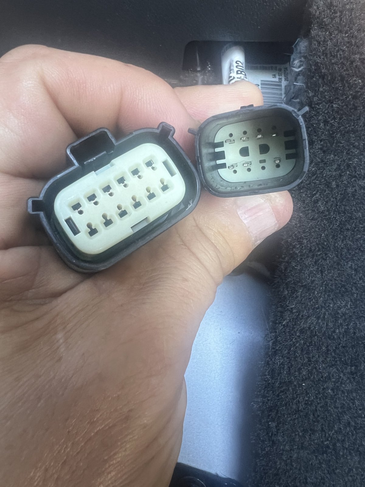

Problem is the driver side 2nd row captain seat connector does not match my harness. I beleive this is because the vehicle seat was heated in the center which is not the case with the captain seats. Is there an adapter for this to connect the two connectors or do u have to splice them? Any schematics appreciated.

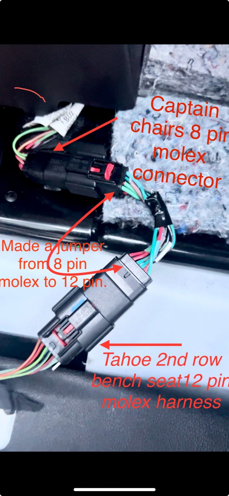

I went ahead and ordered molex male and female connector kits (12pin and 8pin along with crimper) on Amazon and built my own jumper adapter. That ended up working great. It allowed me hook up to the original seat connectors without splicing wiries. Make sure to find a good wiring schematic good schematic found online. Made the procedure pretty easy to do. My seats do have the power fold down and heat. All works fine.
