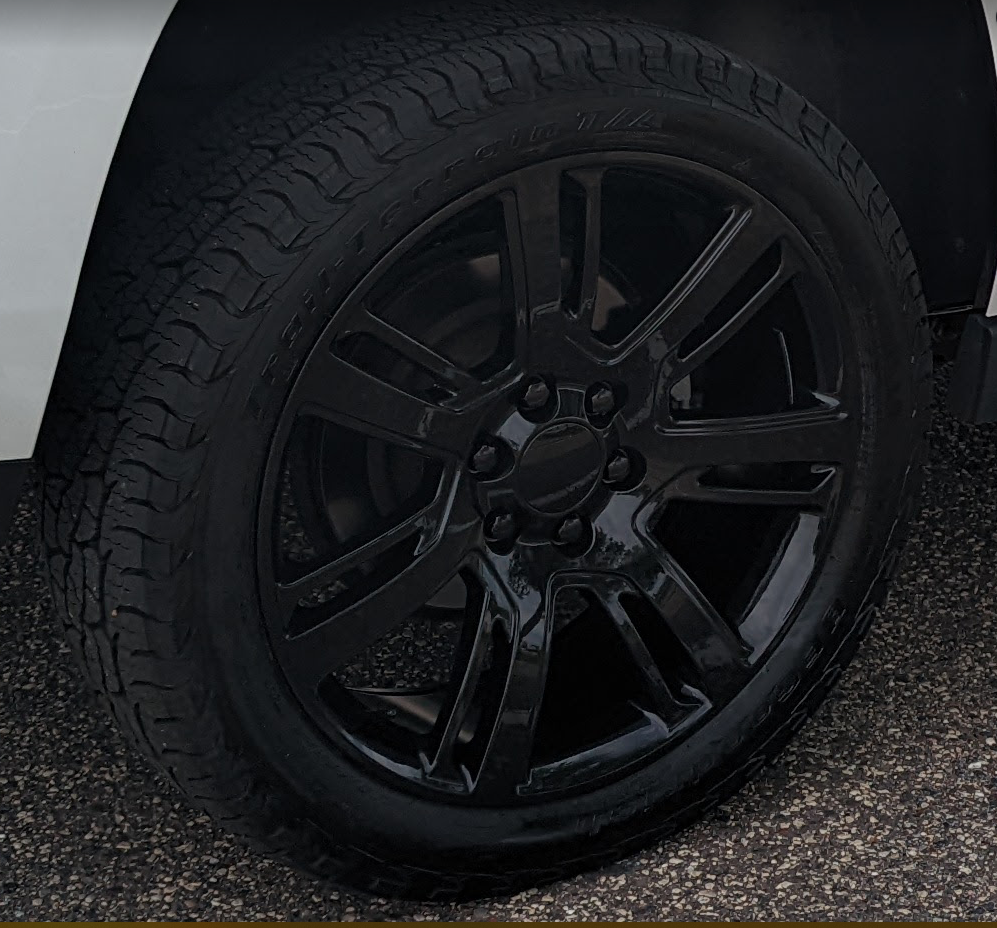

Lets see some pics of those 22’s with the bfg’s!
here is a little closer image of the wheel and tire combo.
