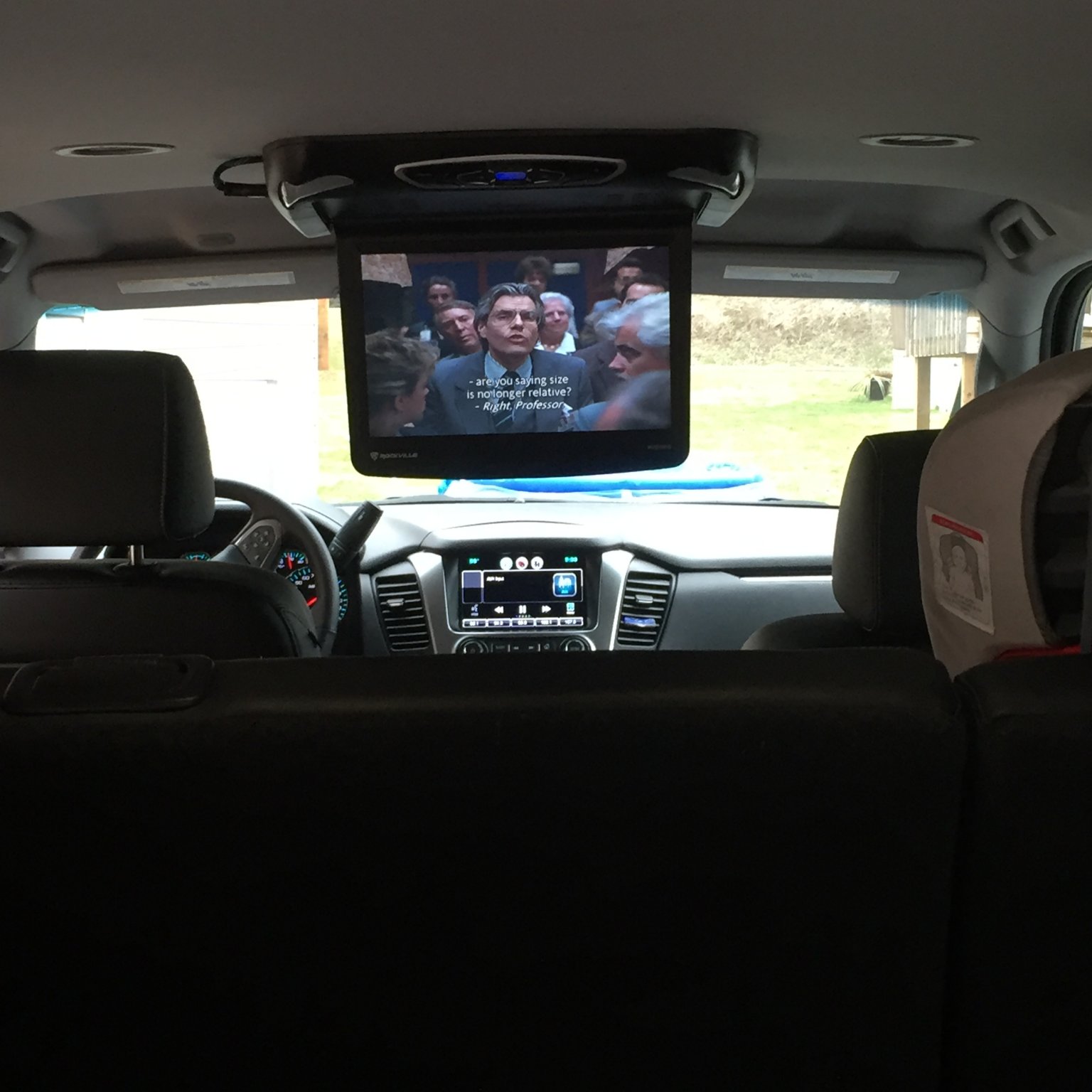

with the help of some other threads I finally finished my DVD install. Only issue I have is the 2x4s I used to brace, a back corner missed the stud and droops. Any ideas on gettin that up a lil tighter to headliner?

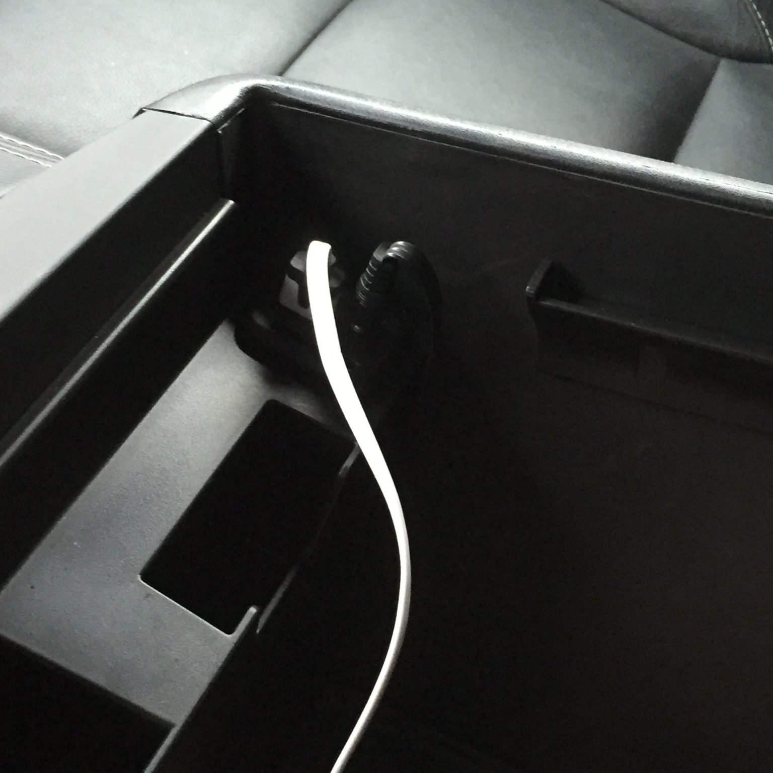

Decided instead of hardwiring, use 3.5mm jack that can be plugged or unplugged to run audio through car system

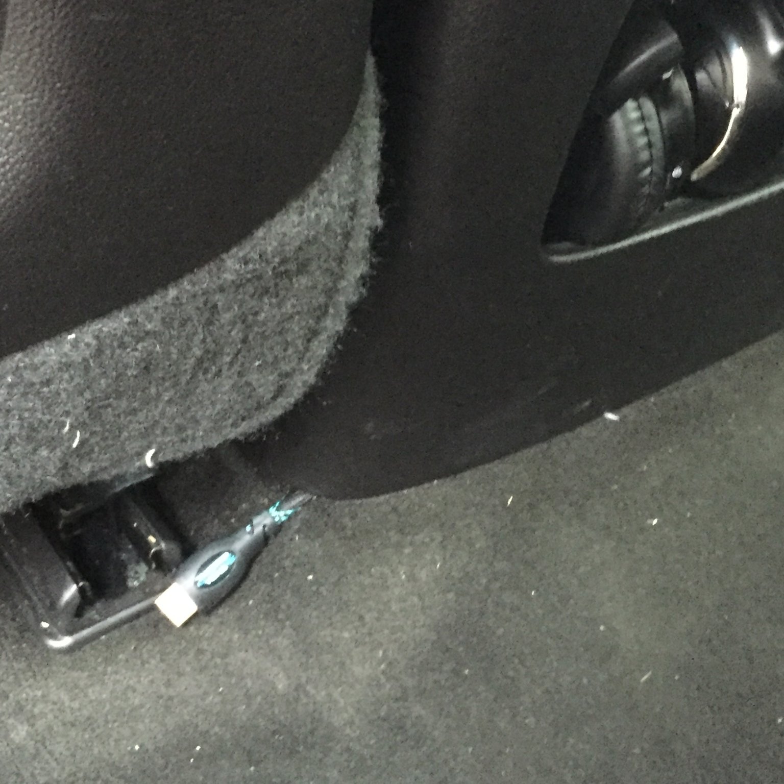

Left a hookup for later in case kids want to add a game system or any accessory that uses hdmi like iPads, phones, etc

Nice work...PM sent with questions. Can't you remove the unit and drill new hole/screw in that area of mounting plate to attach corner? I'm assuming you mounted plate to the wood before installing the actual unit to the plate.
I am about to begin a similar project with our yukon.

I ears epoxy on 2x4 to roof off vehicle and mounted plate in outside of headliner... May have to completely remove 2x4 and use a longer one
