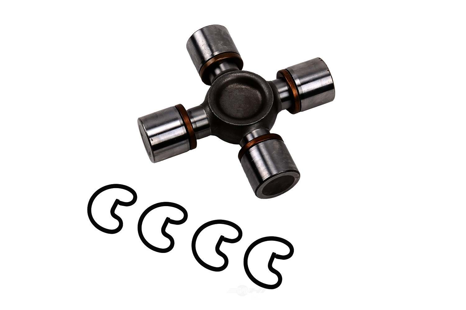

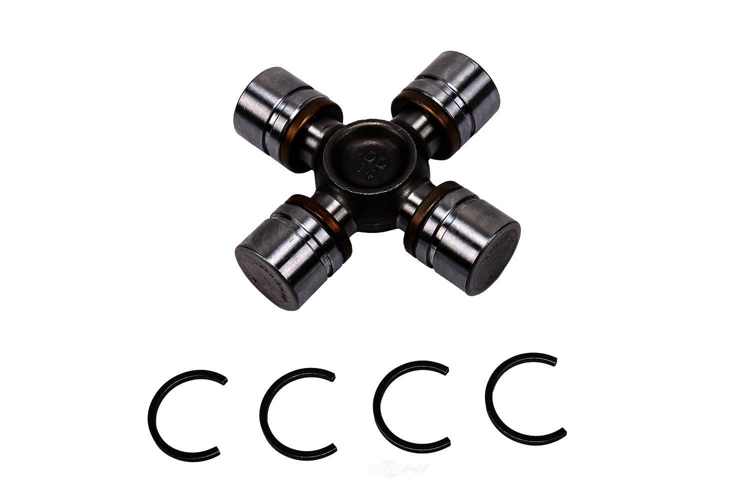

Pretty sure the front is still a 1344 series u-joint, 23104840. Some show the front as being a 1355 series which is what I run on the back of mine! 89059111. To tell these apart, the 1344 have snap rings on the inside and the larger ones have the snap rings on the outside like the rears.
The rear is either 1355 but I thought they all were 1415 on the K2s. If you measure the u-joint, the smaller one will be just over 3.5 inches across and the bigger one will be just over 4 inches across. So you don't have to be precise when you crawl down there to know which is which.
Each shaft has 2 u-joints, the front ones are the same size and the rear ones are the same size.
1344:
1355 or 1415 with outside snap rings:

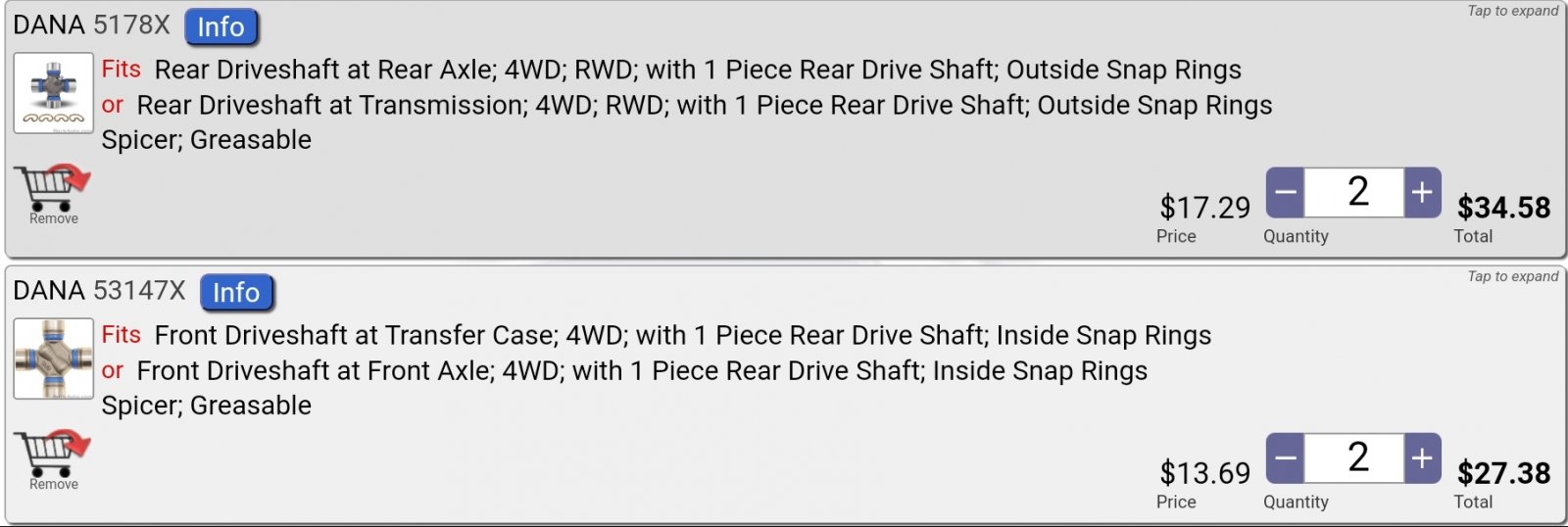

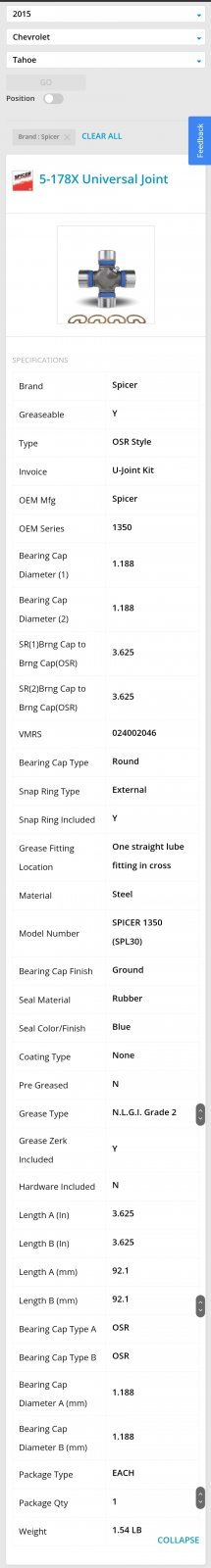

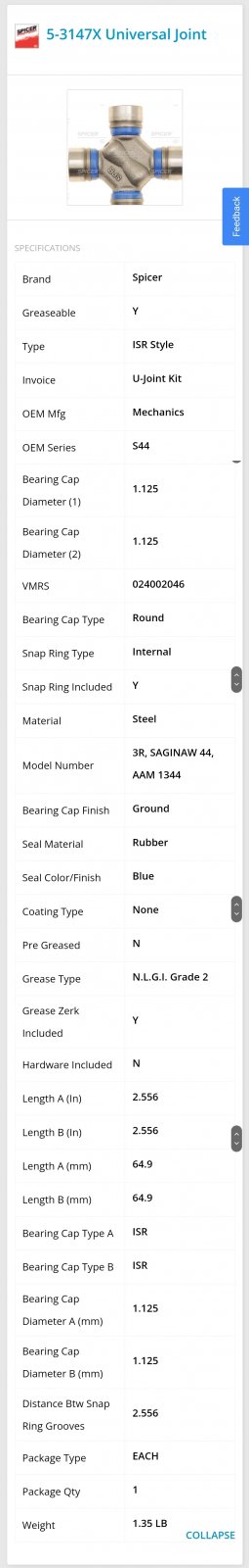

These are what I ended up going with. Just due to price and availability.
Also because the are greasable. I prefer greasable parts if I can help it.
